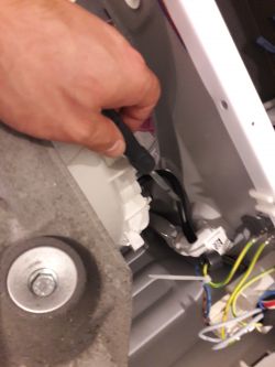

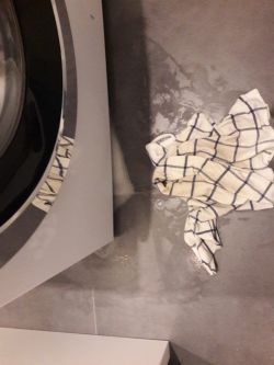

    As in the subject. Of course, washing machine a few months after the warranty. The condition didn't start long ago and it doesn't happen every time. The water that flows out comes out in the form of foamed suds, possibly during rinsing. For washing we use capsules thrown directly into the drum. I have a small child and I cannot afford the washing machine to be in the service for 2 or 3 weeks. Provide advice ...

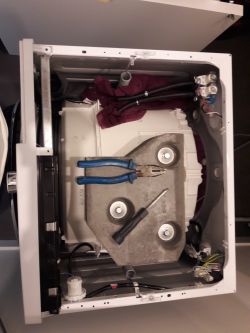

    Water, like 50-200ml ... In this washing machine there is probably only a drum vent and it was actually a bit dirty. I'm putting together the washing machine and the test wash.

    Unfortunately...

    Checked :
    1. Detergent drawer disassembled and blown with a compressor,
    2. supply hoses to and from the hopper
    3.Elbow, vent and drain hose also ...
    Only the vent hose was a bit dirty.
    As for the sachets, they were also used before and there was no problem.

    Beko WMY81243PLPTLMB1 - The washing machine pours water through the drawer / tra
    Wash 90 degrees. without spinning 2h40min. empty washing machine without chemicals. A little water appeared. Washing machine slightly tilted back (front feet more twisted as much). I'm doing laundry now, but with liquid instead of capsules ...

  • #14 17437395
    alvaroalvaro
    Posts: 119
    Rate: 28
    No leakage after washing with liquid detergent.
