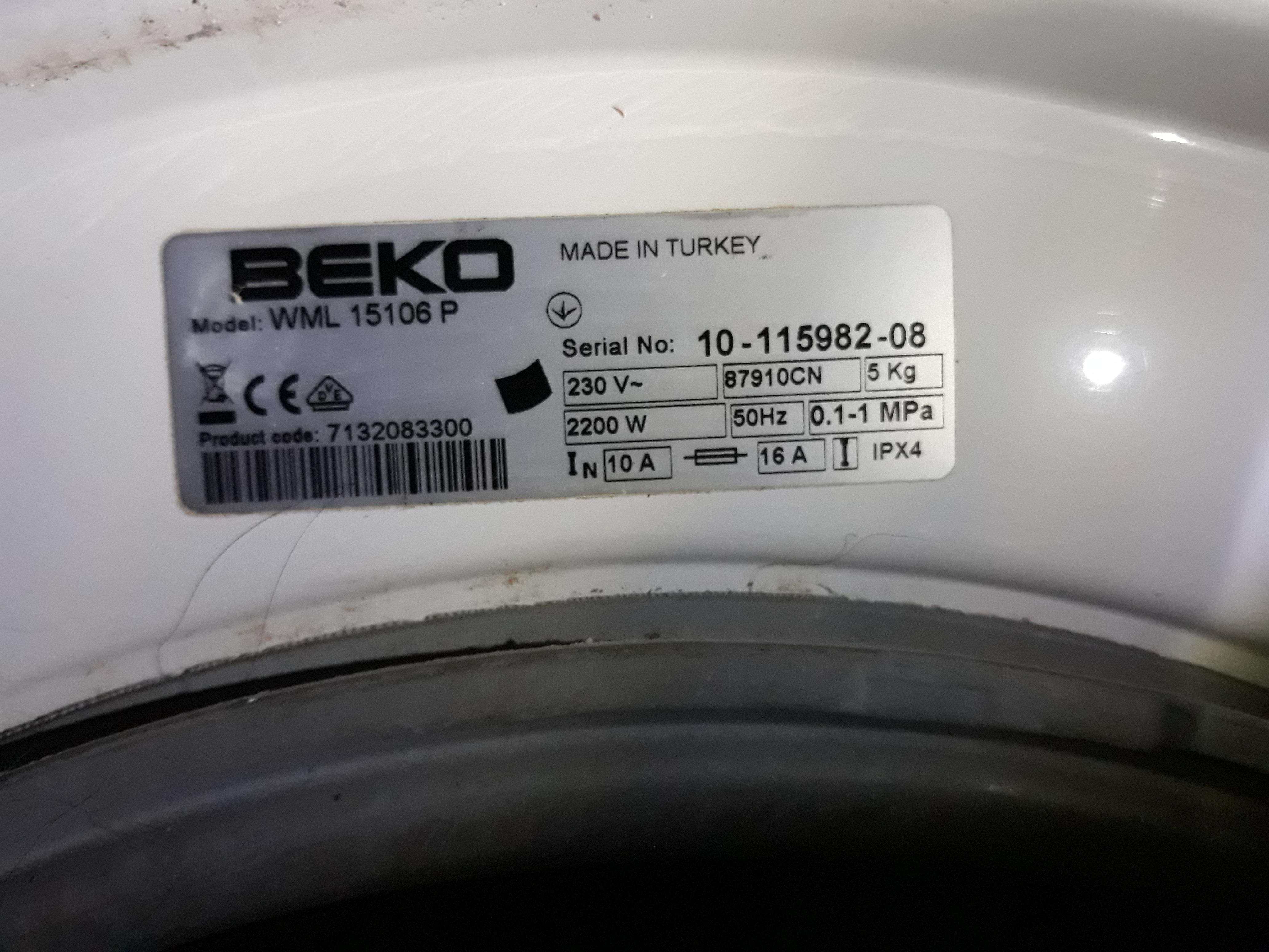

    Because I have the same washing machine maybe parts are needed for next forum users despite the passing of time.
    • Beko WML15106P Washing Machine: Unresponsive Buttons and Locked Door Issues 20190216_172712.jpg (1006.83 KB) You must be logged in to download this attachment.
