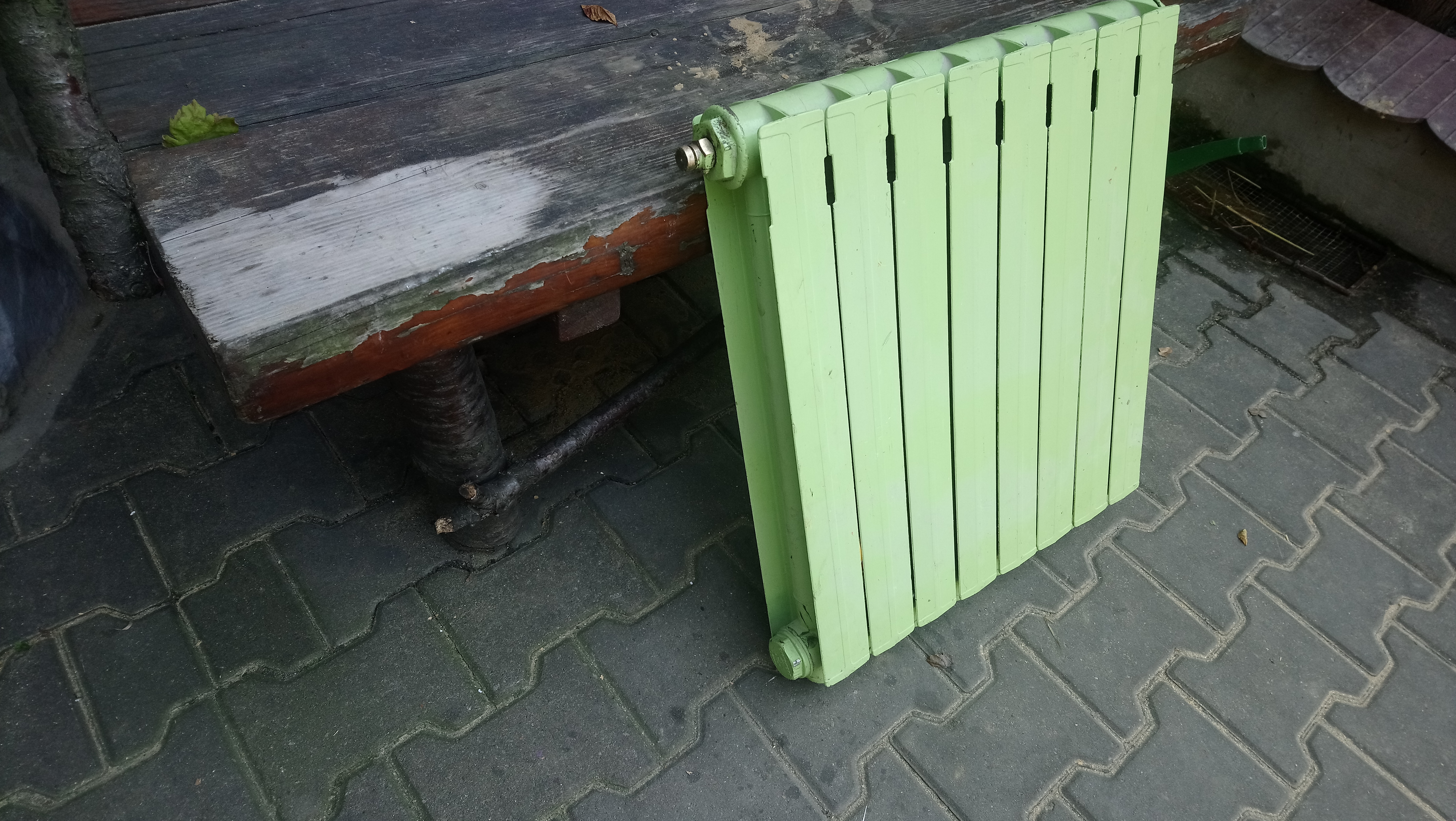

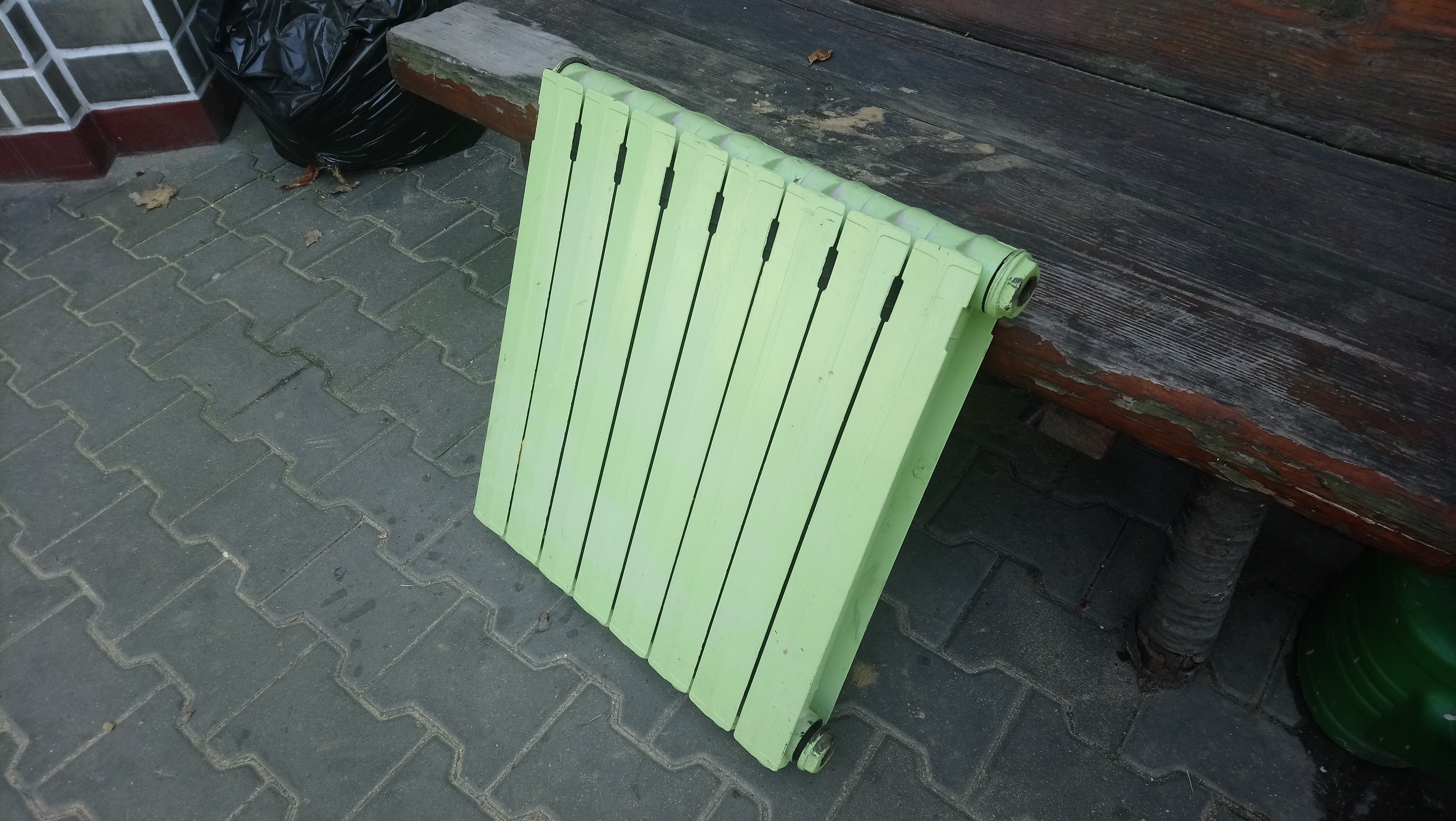

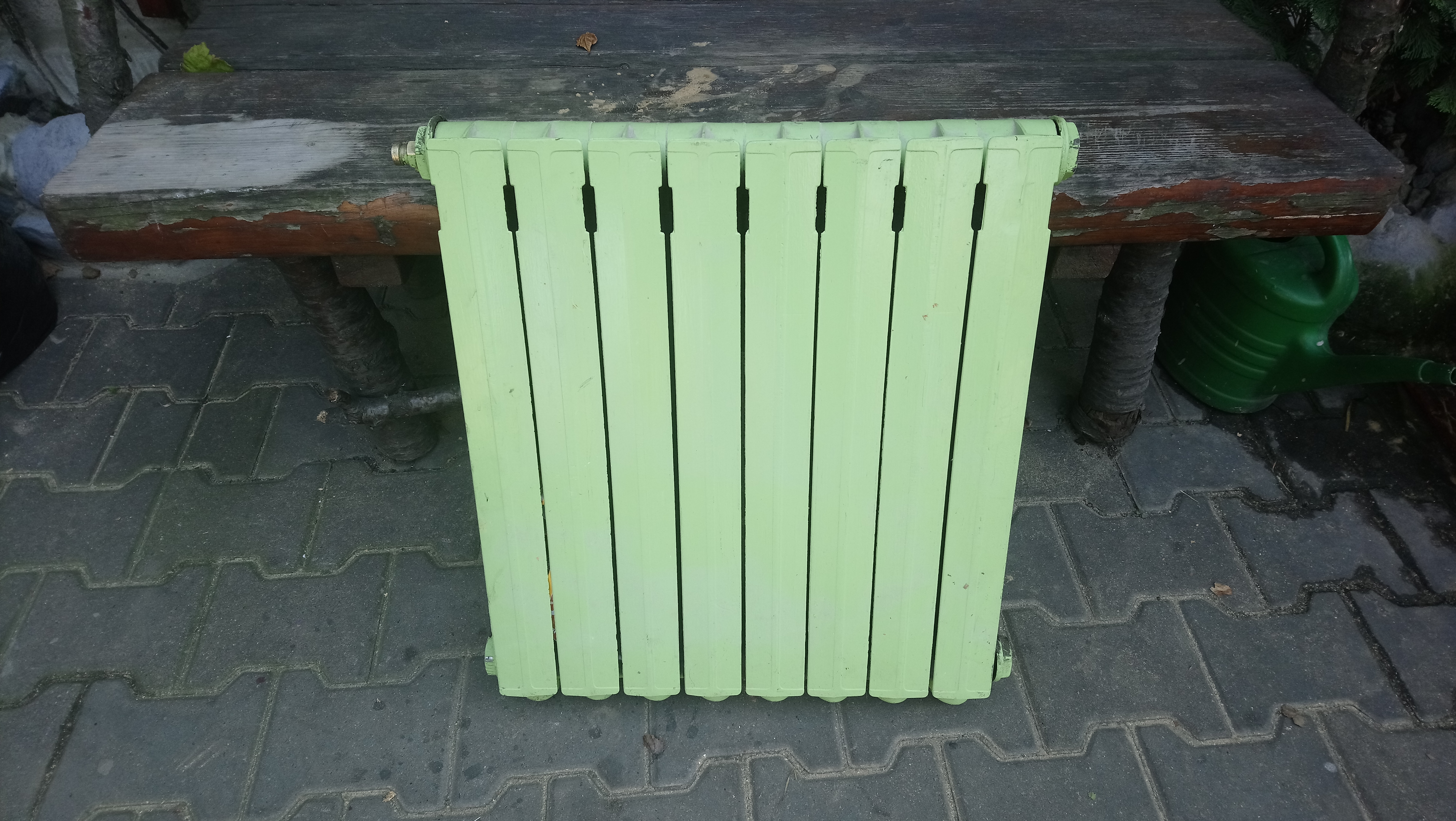

    Gentlemen radiators looks like this:
    Radiator, where to connect the power supply from above or below?
    I would like to connect it anyway, as you can see in the pictures, power supply on the right side at the top, return on the right side at the bottom.
    At a friend's, the radiator was connected at the bottom left and bottom right.
    I would also like to ask if I could put radiator valves (return) on the supply and return, which are screwed on an allen key?

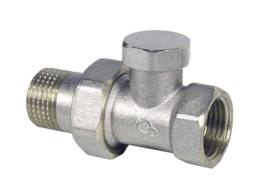

    Yes, I know it, but I would like to install valves at the inlet and outlet, screwed through an imbus, a preview photo:
    I just don't know if such a valve can also be installed at the entrance.

    Unfortunately, it cannot be because the water in such a valve goes under the mushroom if it is on the return (flows out of the radiator). On the power supply, the water would come the other way and it would not work properly. Buy a normal set of valves for supply and return.

    The radiators look like aluminium, but painted, which are made of connected segments. By adding or removing segments, you can adjust the size, i.e. the power of the radiator, because steel ones are bought with a specific size and it is not possible to modify the physical size.
    You only have a side connection, so a friend had a saddle side connection, which I wrote about above. You can easily make a traditional side connection, i.e. power supply at the top, and return at the bottom on the same side on the side.
    If I'm not mistaken, the valves have a specific direction of water flow, so the imbus valve from the next photo is only intended for installation on the return as ta_tar wrote.
    If you don't need a valve and a thermostatic head, use a regular valve and, if necessary, close it with a knob, but it must be a supply valve, not a return valve.

    A little note on tartare. What problem do you see to put the shut-off on the imbus and on the power supply? And how about the binocular valves under the V-kits?
    Greetings

    For me, the "binoculars" and the classic return valve from the previous photo are two completely different valves.
    The "binoculars" I've seen needed a 90-degree rotation, or a quarter turn, to fully open or close, suggesting it works more like a ball valve.
    In contrast, a classic return valve usually requires about 5-6 full turns to fully close/open, which suggests a poppet-based design.

    For BUCKS, most binoculars are the ones with a classic mushroom head tightened with a few turns of the allen key, just like in a classic radiator valve, and that's what I meant. In this group there are also ball binoculars and they are safer to use because those with mushrooms could have a weak opening limiter (or lack of it) which threatened to unscrew the mushroom and in a hot installation it made it difficult to screw it in, which is a big problem.
    Greetings

    Gentlemen, I will use an ordinary radiator valve with a white knob for power supply, I will put a simple screwed valve on the return.
