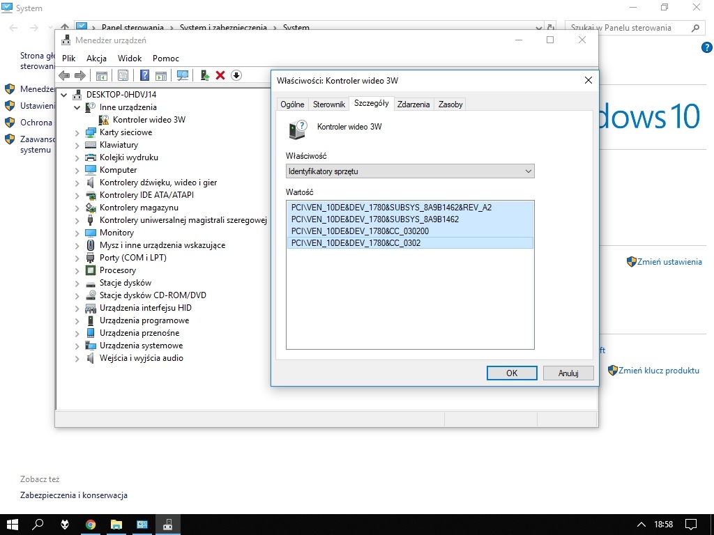

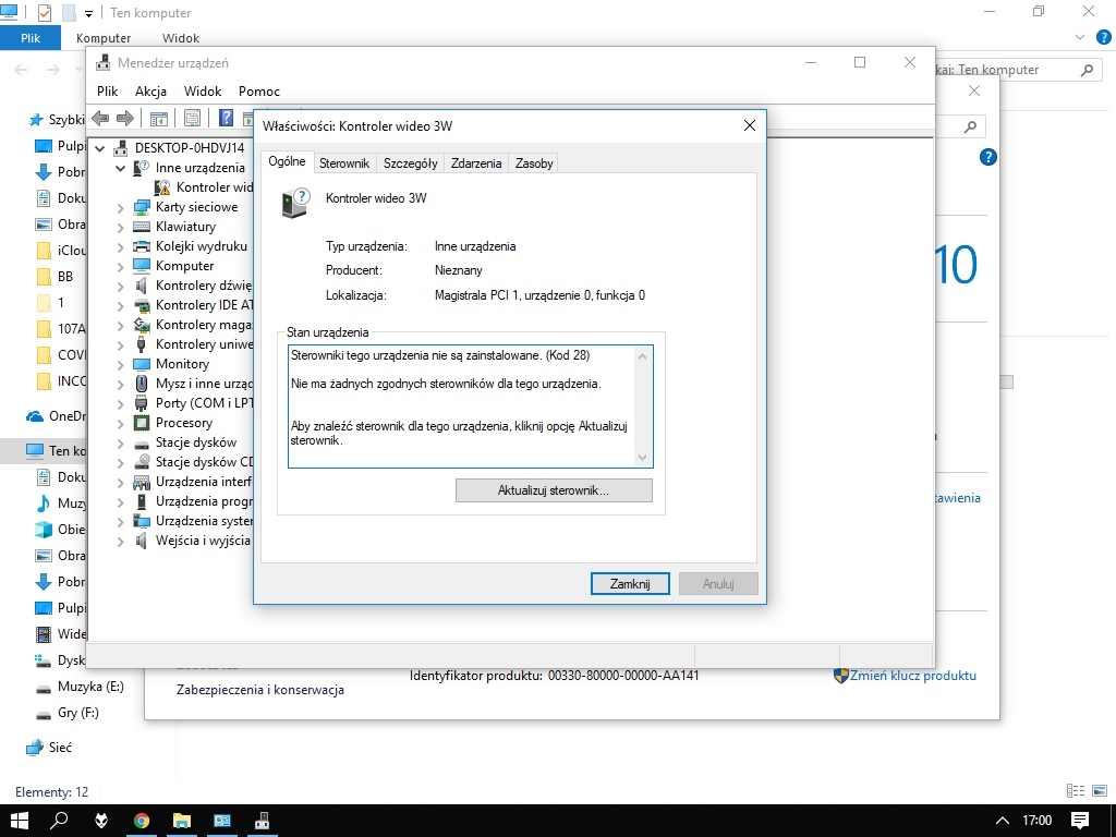

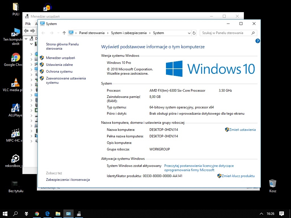

    Hello. Today I encountered a problem on my computer that has never happened before. Namely, my graphics card disappeared from my computer. He doesn't see her at all. The problem occurred after restarting the computer. When I finished work yesterday, everything was working and I turned off the computer normally. Today, when I turned it on, the computer no longer sees the card. The graphics card works because the monitor is connected to it and you can hear it fan fan . Unfortunately, the resolution you can work at is 1024x768. The graphics card is N750TI-2GD5

    Hello. Maybe it was after a system update? Provide your computer specifications.

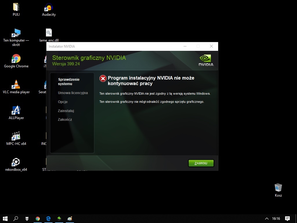

    Unfortunately, it cannot be installed. I think there was a system update yesterday. N750TI-2GD5 Graphics Card Not Recognized in Windows 10 Device Manager After Restart

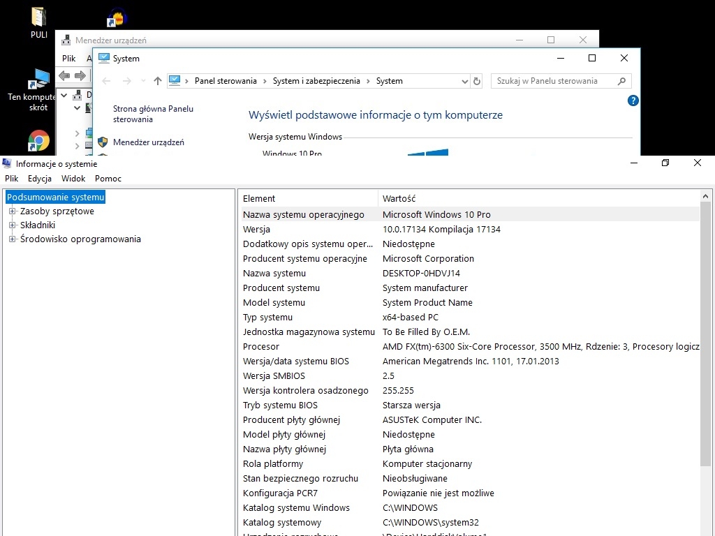

    Please provide this ID and uninstall the old drivers. Would a specification be useful for the motherboard, RAM, power supply?

    The power supply is Akyga 500W (AK-B1-500), the rest can be found here:
    N750TI-2GD5 Graphics Card Not Recognized in Windows 10 Device Manager After Restart N750TI-2GD5 Graphics Card Not Recognized in Windows 10 Device Manager After Restart

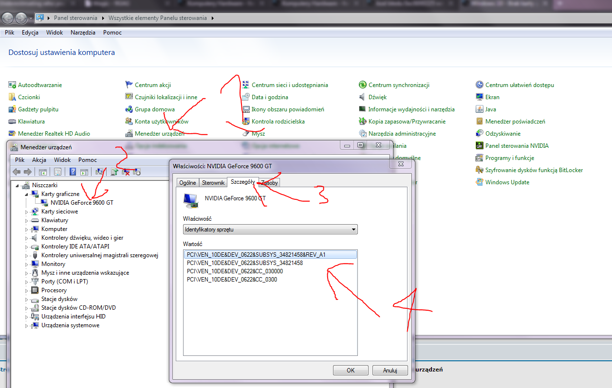

    ID after CMOS reset. It may be writing another device or unknown.

    What I meant was that if you right-click on "3D video controls" and go to its properties, the Device ID should usually appear on the first page in this window, so I would ask you to copy it so that I could see what it is and whether it is related to missing card...

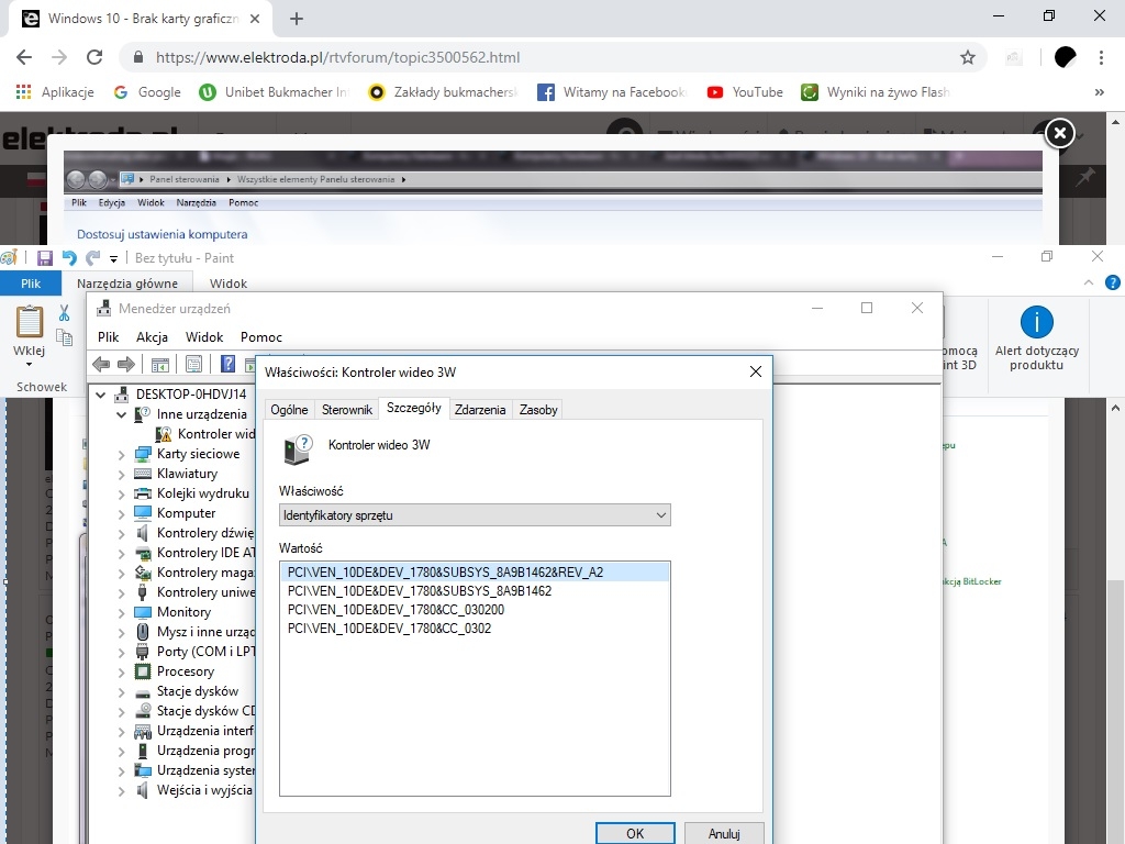

    @Kamololz Because you entered it wrong. @omegadrive Select this ID, copy and paste here, is it so difficult?

    PCI\VEN_10DE&DEV_1780&SUBSYS_8A9B1462&REV_A2
    PCI\VEN_10DE&DEV_1780&CC_030200

    This board has integrated graphics and what are the markings on this board?
  • #20 17447324
  • #21 17447331
    omegadrive
    Posts: 18
    Yes, it has integrated graphics. Asus M5A78L-M LX3 motherboard. But my monitor is still connected to the GeForce card, which is not detected, and the monitor only works, with a resolution problem.
