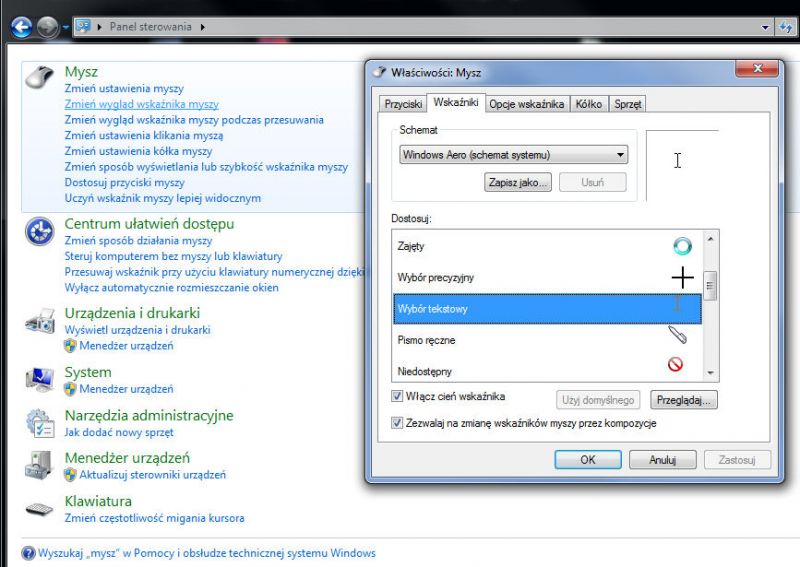

    A friend told me about his problem, I didn't know what he meant, but I didn't see it myself. He has a Toshiba Satellite l750 computer, and he is a bit nervous, the reports show that in the moment of elation and fury he pressed anything on the keyboard and as a result, regardless of the program (text editor or web browser), the cursor is a thin black line for all of us. him is a wide black rectangle, and in addition, it does not allow him to insert a space. Apparently everything is ok when he connects an external keyboard (I haven't checked so I can't confirm). I am not an expert, but I suspect a keyboard shortcut that I do not know (and I have read pages with Windows shortcuts and none of them fit). Of course, this could also be the result
    mechanical damage?
    Has anyone encountered such a situation or knows how to deal with it?
    They will be grateful for any tips.

    In windows 7, you can set everything in the control panel.

    Maybe just press the INSERT key?

    Neither one nor the other, unfortunately !!!

    And does it overwrite the text? If you click in the middle of any text and start typing, INSERT causes letters to be overwritten. If so, there is definitely a problem with the insert.

    So a damaged keyboard or a jammed key (some function, if you do not write letters all the time)

    If someone encounters such a case, go to Settings -> Accessibility -> Change the size and color of the cursor and mouse pointer -> Change the thickness of the cursor -> move the slider to the thickness of interest
