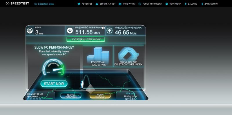

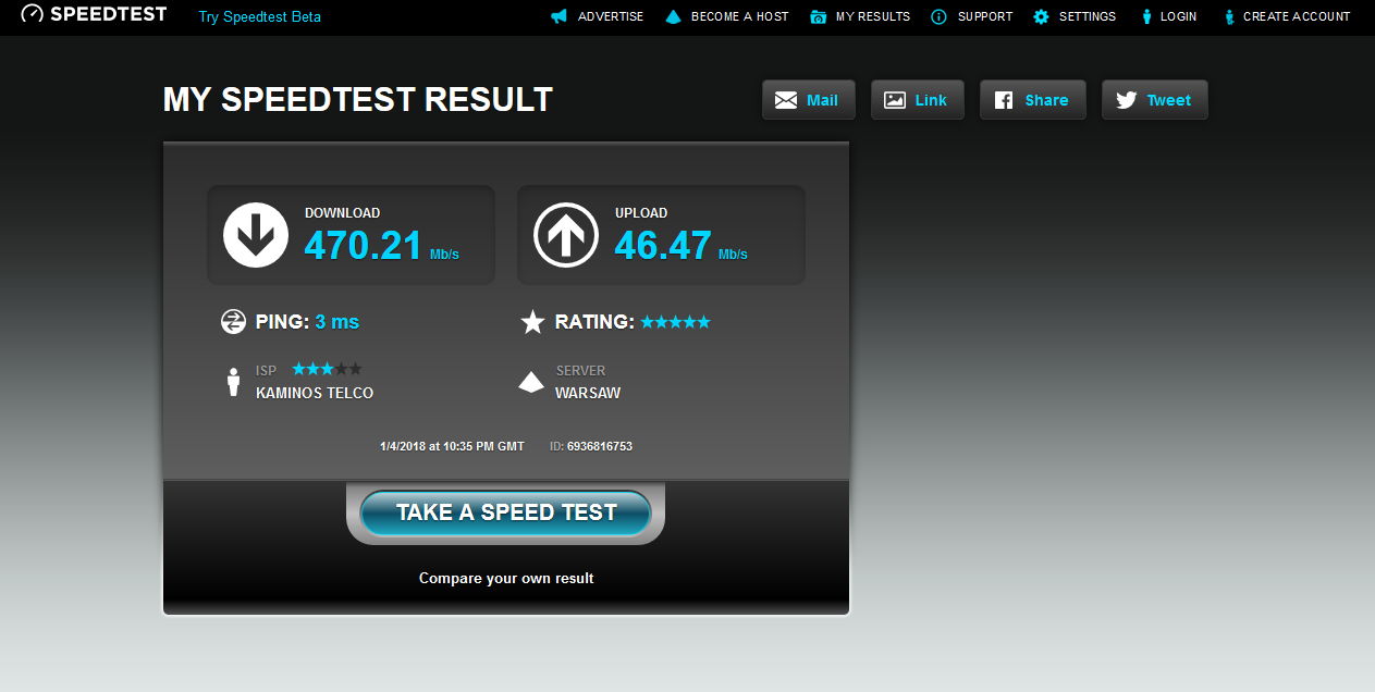

    I have a new fiber-optic internet with a capacity of:
    Download: 500Mbps
    Sending: 50Mbps
    The main router is Huawei HG8245 (There is no bandwidth control option on it, but QoS is enabled)
    What is connected to the main router?
    TP-LINK Gigabit switch and for it:
    2 computers (Mum + Dad)
    The TP-LINK Archer D2 router and under it:
    1 Cisco switch up to 100Mbps and for it:
    2 TP-LINK routers working as AP + 30 people using WiFi
    I am connected to Archer D2 and although I have the bandwidth limitation turned on, the internet is still muddy.
    Tell me what to change in the settings.
    • The Internet works poorly despite the fact that it is optical fiber Sceen 5.jpg (111.62 KB) You must be logged in to download this attachment.
    • The Internet works poorly despite the fact that it is optical fiber Sceen 3.jpg (109.07 KB) You must be logged in to download this attachment.
    • The Internet works poorly despite the fact that it is optical fiber Sceen 4.jpg (94.99 KB) You must be logged in to download this attachment.
    • The Internet works poorly despite the fact that it is optical fiber Sceen 2.jpg (92.15 KB) You must be logged in to download this attachment.

    Connect to the main router.
    Perform the measurement with some speed test.
    Disconnect all other devices that may influence the measurement result.

    I checked and it turns out that everything is fine (Speeds match).

    Please present the results.
    The next step would be to present the results from the next router.
  • #6 16936800
    sebawaw98
    Posts: 19

    As you can see, the bandwidth is adequate to what the provider offers on both routers.
