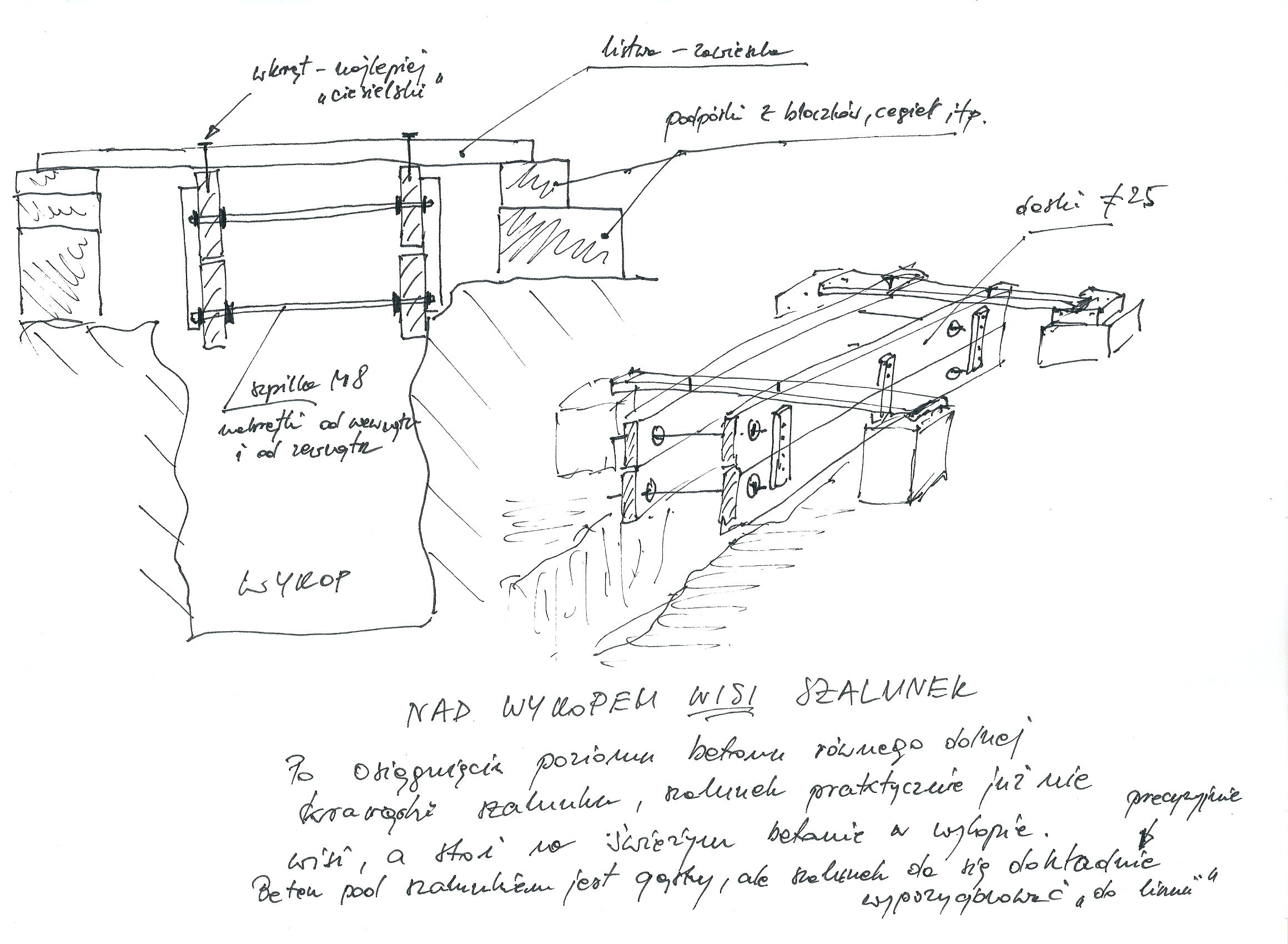

    If someone has not built many times or has not been to construction sites, he may not know that pouring foundations twice is a common case and no wonder.
    "Big" contractors do not mind that the investor will pay for stupid work and materials, quite the opposite. I saw a bunch of workers demolishing the excavation in such a way that a few cubic meters more had to be added or the formwork was lost.
    Buddy pawel, refer to the horizontal "crack" on the foundation, where the insulation is.

    101pawel - my formwork currently looks exactly like your sketch. I wanted to do this from the beginning (the drilling was not easy because it crumbled during measurements and walking), but it was the concrete company ( :) ) advised 2 times, only within 2-3 days, and it became as much as 3 weeks :( cold8 - yes, it's true that they do it twice, because the foundations for the house also had a footing in the ground and then formwork in a few days, but there were very wide excavations. I didn't dare to board from the bottom, so almost twice as much concrete came in - I reinforced it. Greetings :)

    as above - sketch
