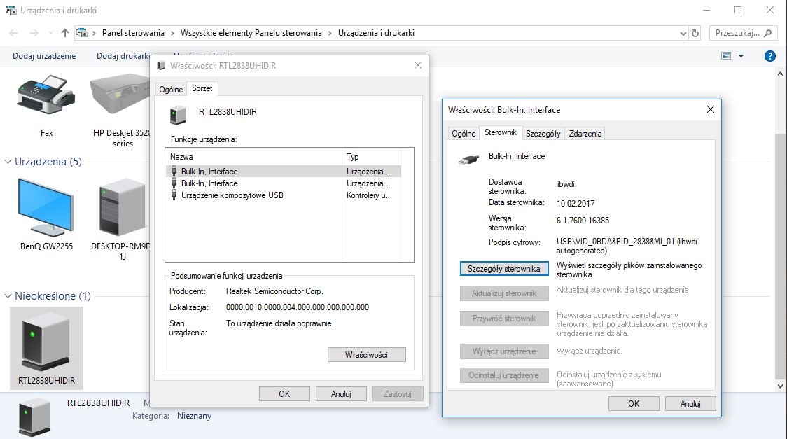

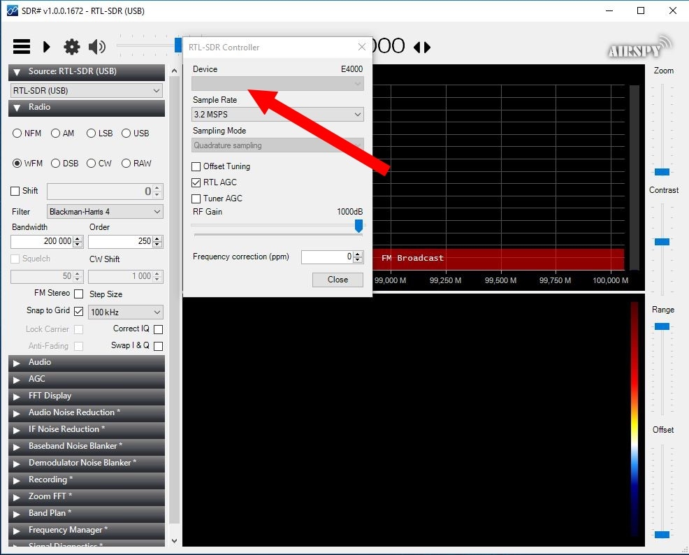

    As in the subject, I bought a DVB-T RTL2832U R820T2 SD tuner to listen to what is squeaking in the air.
    I think I installed the drivers correctly using the zadig 2.4 program. True, the program does not show my device but gives the Bulk-In option and the installation is successful. The device is installed as undefined. But SDRSharp does not see it.
    My system is win 10.
    The question is what am I doing wrong?

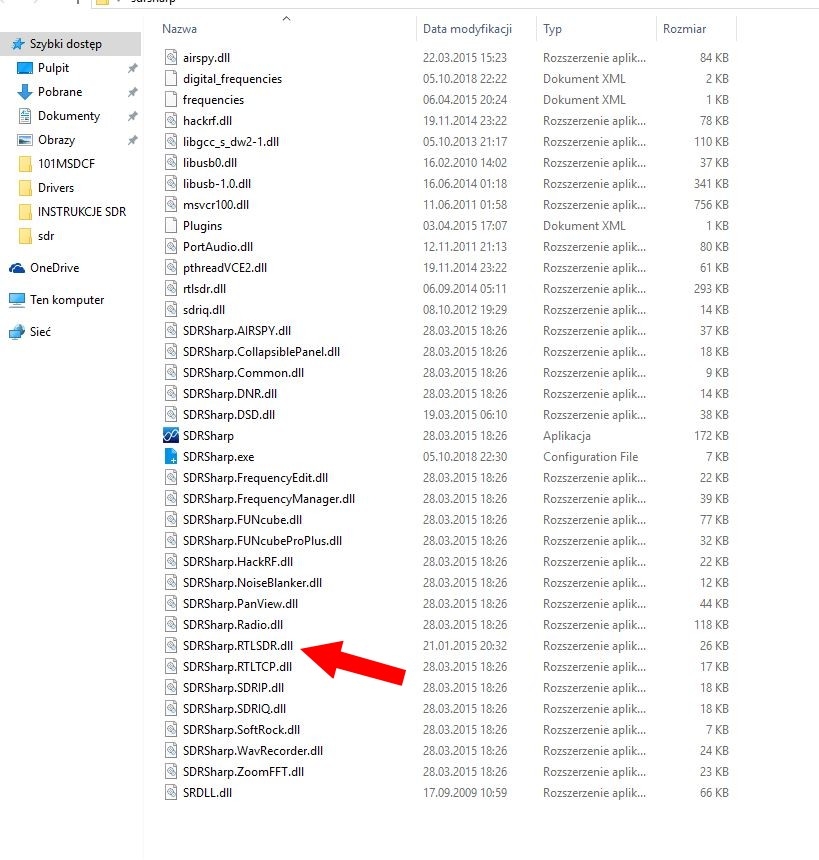

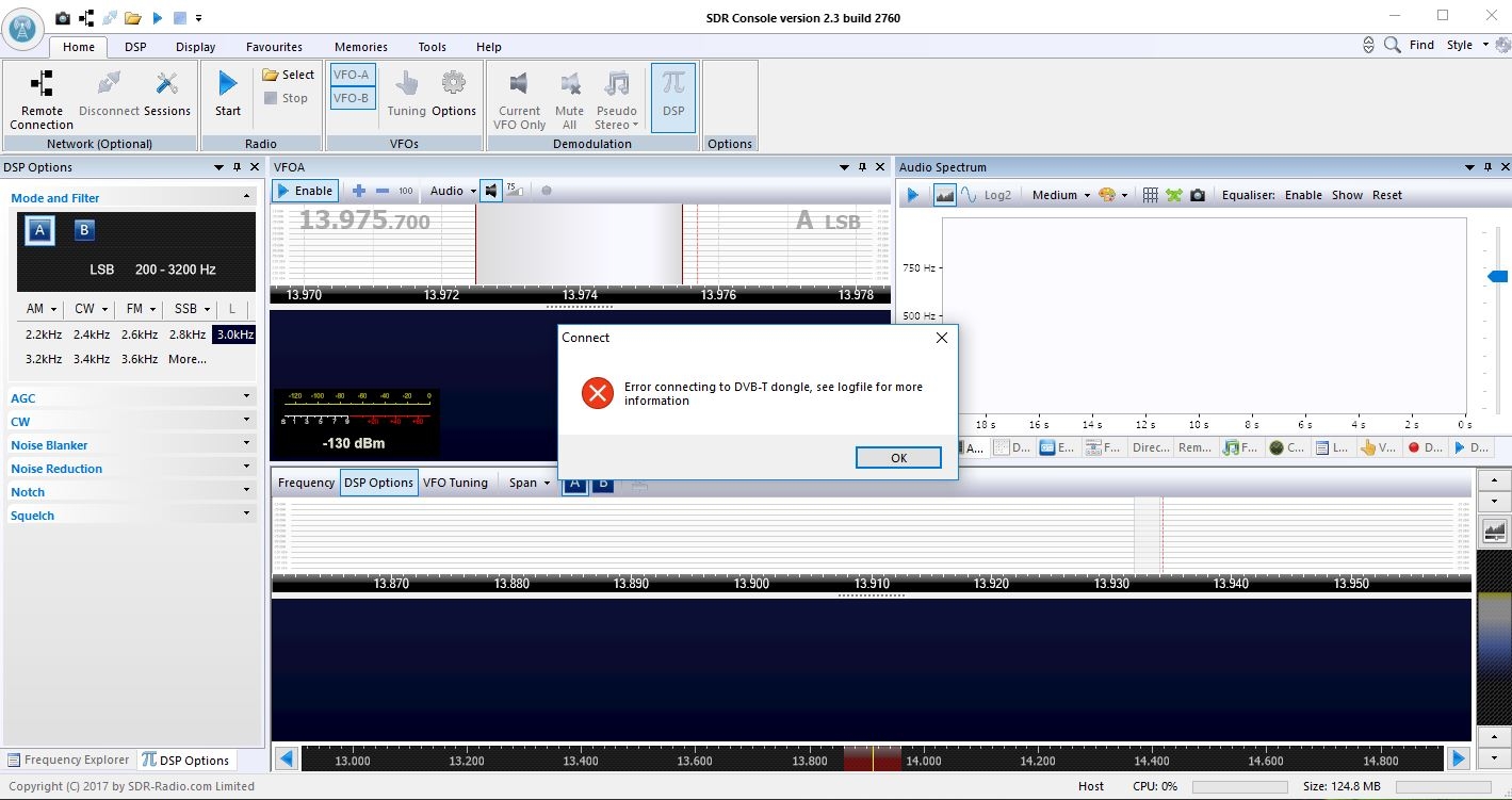

    I have never used SDR Console but as far as I can see it can connect to RTL-SDR over TCP. So you would have to enable the rtl_tcp server. So let's focus on SDR Sharp. The drivers appear to be installed correctly, but do you have rtlsdr.dll in the root of SDRSharp? If not, download it from here: http://sdr.osmocom.org/trac/raw-attachment/wiki/rtl-sdr/RelWithDebInfo.zip according to your operating system architecture from the x32 or x64 directory.

    Yes, I have such a file
    DVB-T RTL2832U R820T2 SD Tuner Installation Issues - SDRSharp Not Detecting on Win10

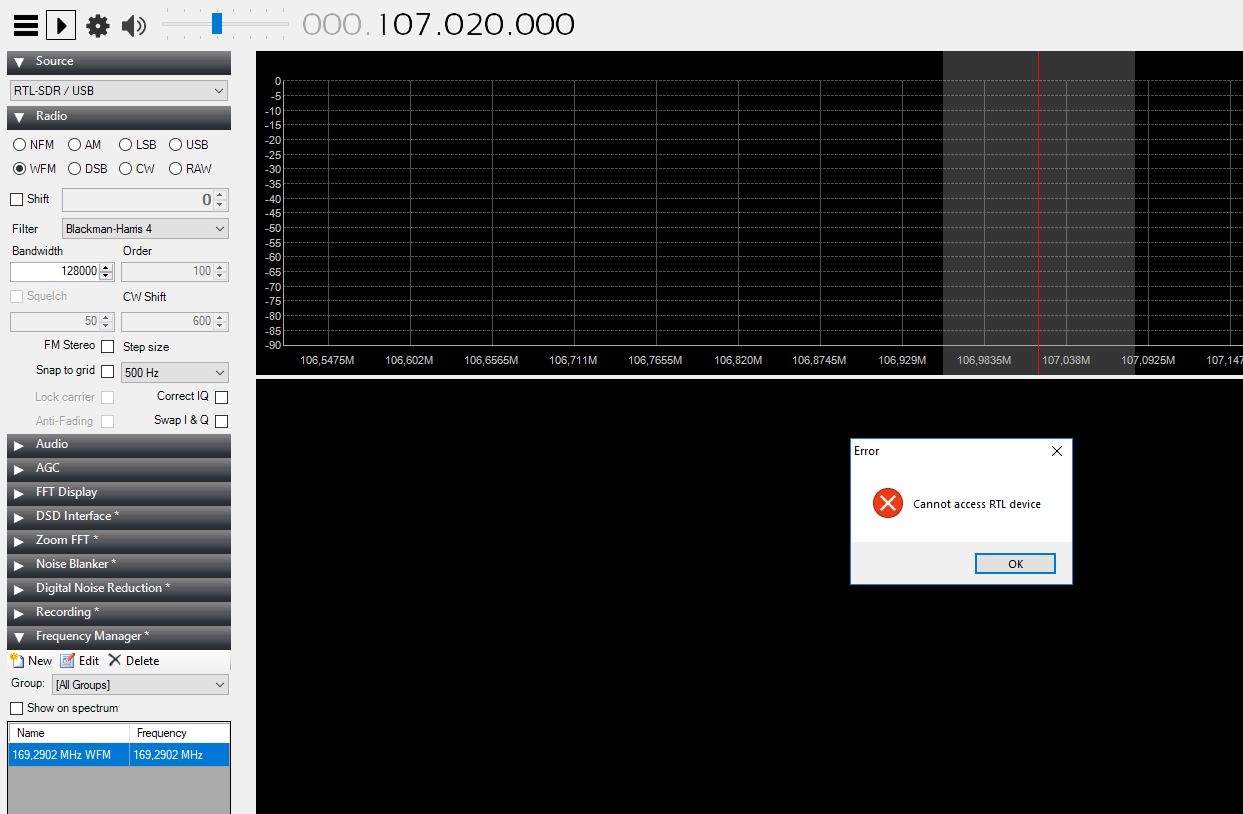

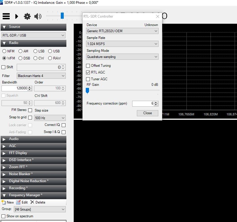

    but I found a version of the program that I am a step further in the settings, see the Tuner but the RF Gain slider does not work and when I press play, this is a message. DVB-T RTL2832U R820T2 SD Tuner Installation Issues - SDRSharp Not Detecting on Win10 DVB-T RTL2832U R820T2 SD Tuner Installation Issues - SDRSharp Not Detecting on Win10
    Added after 50 [minutes]:
    I uninstalled the drivers then reinstalled and it works. Thanks for the help.
