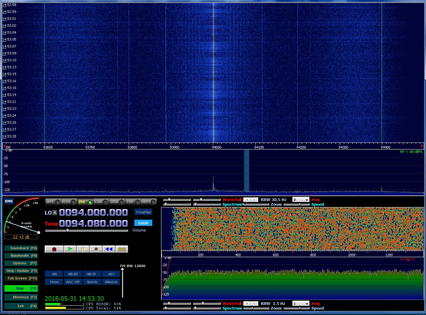

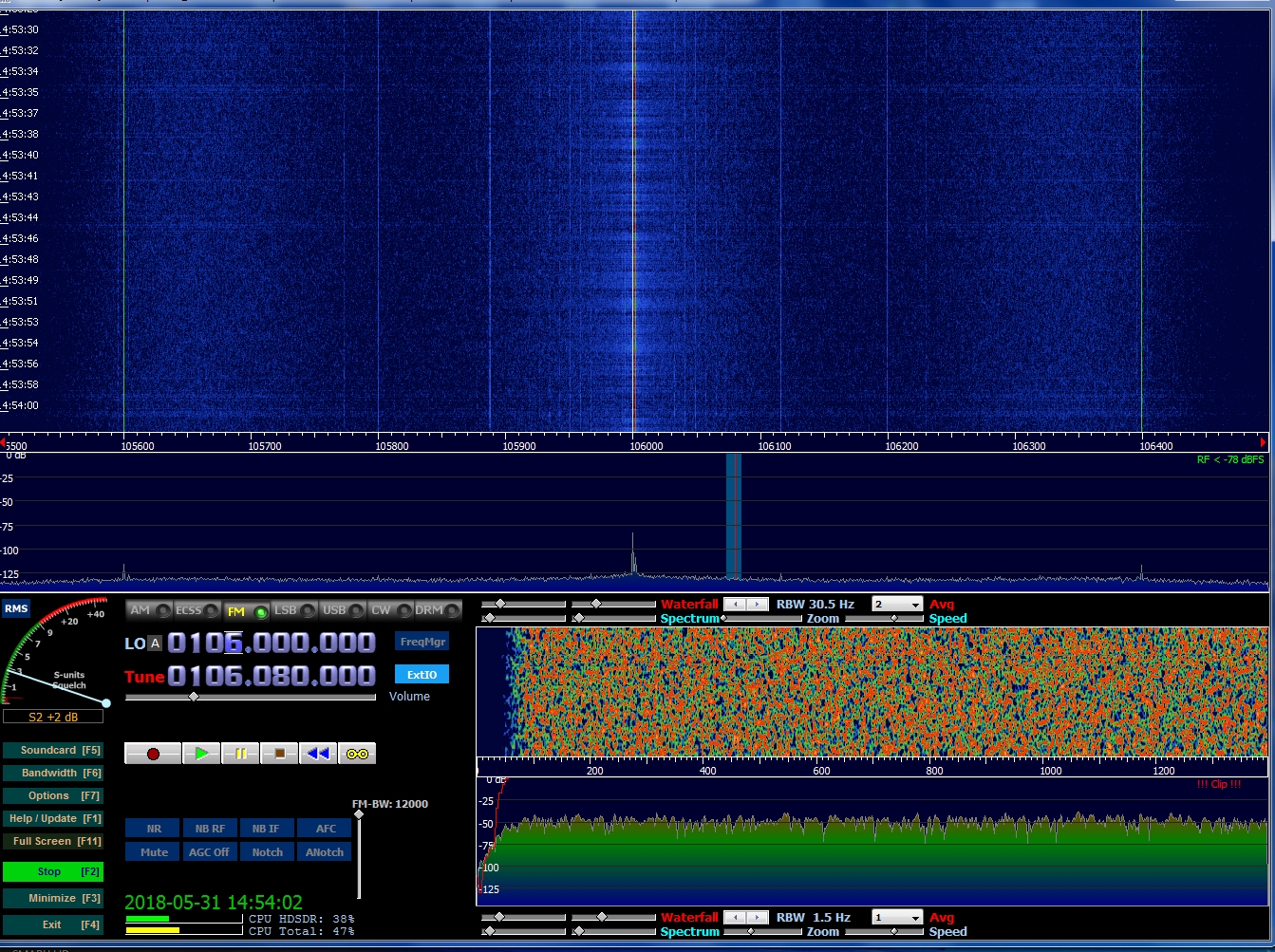

How do I fix HDSDR so my DVB-T + FM + DAB RTL2832U tuner can tune above 1.600 Hz and receive FM stations correctly?
The tuner should work in HDSDR, but the problem is most likely the driver/ExtIO setup: install the original tuner drivers first, then overwrite them with Zadig and use the correct HDSDR/ExtIO configuration [#17251886] [#17251466] Do not set an excessively large reception width; 2.0 MHz or 2.4 MHz is recommended because the program can become unstable when the width is too large [#17251886] [#17329982] After that, adjust the PPM frequency correction so stations line up correctly; one reply notes that the exact PPM value depends on the tuner and quartz, and another example used 0 [#17251886]

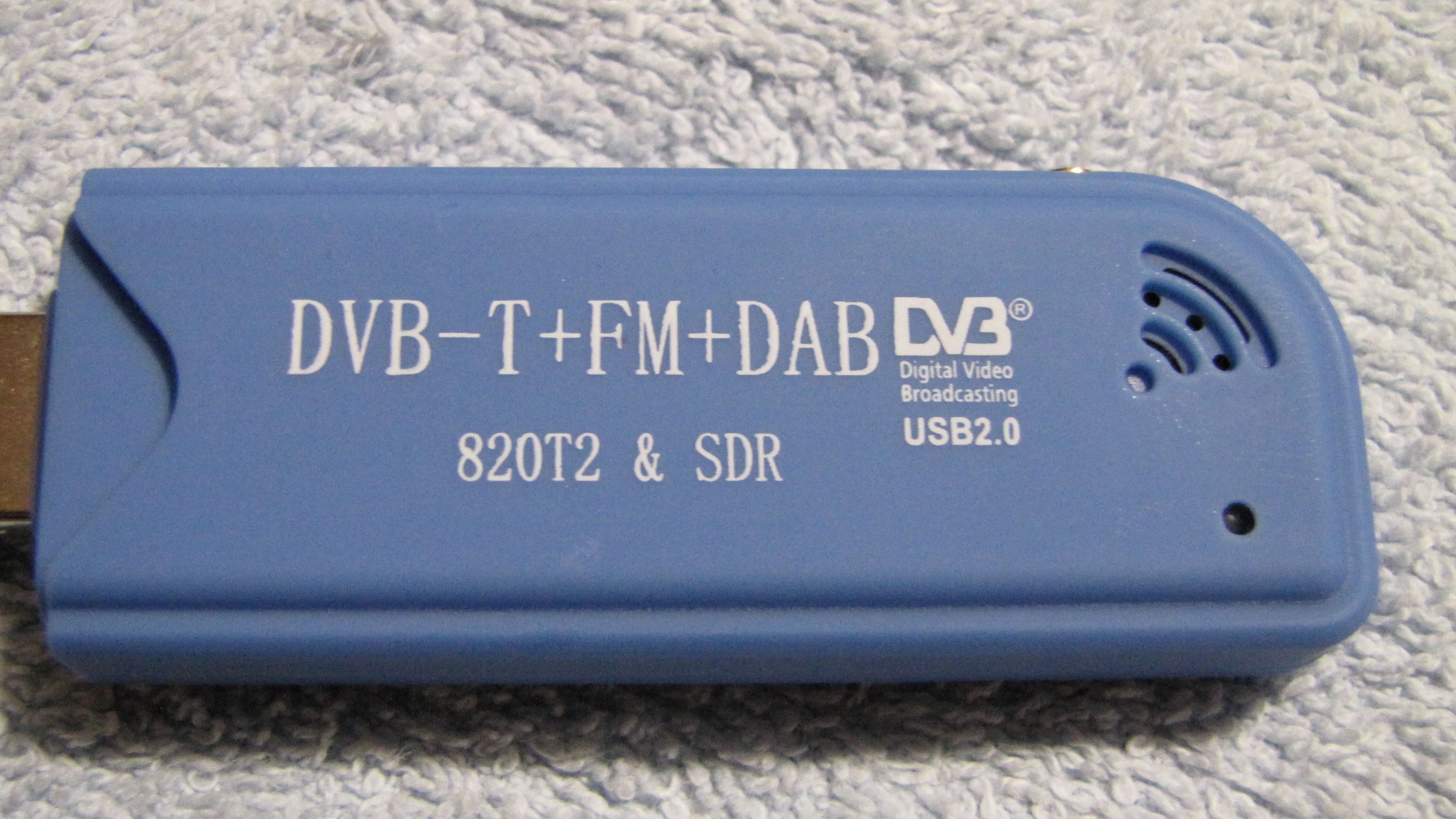

    I have the same tuner, I recommend using the replacement, SDR # (SDR Sharp). It works fine for me with this program. When you manage, let me know if you receive anything except VHF and squeaks on all bands (unfortunately I am silent, rather due to thick walls, because my own transmitters receive everything correctly).

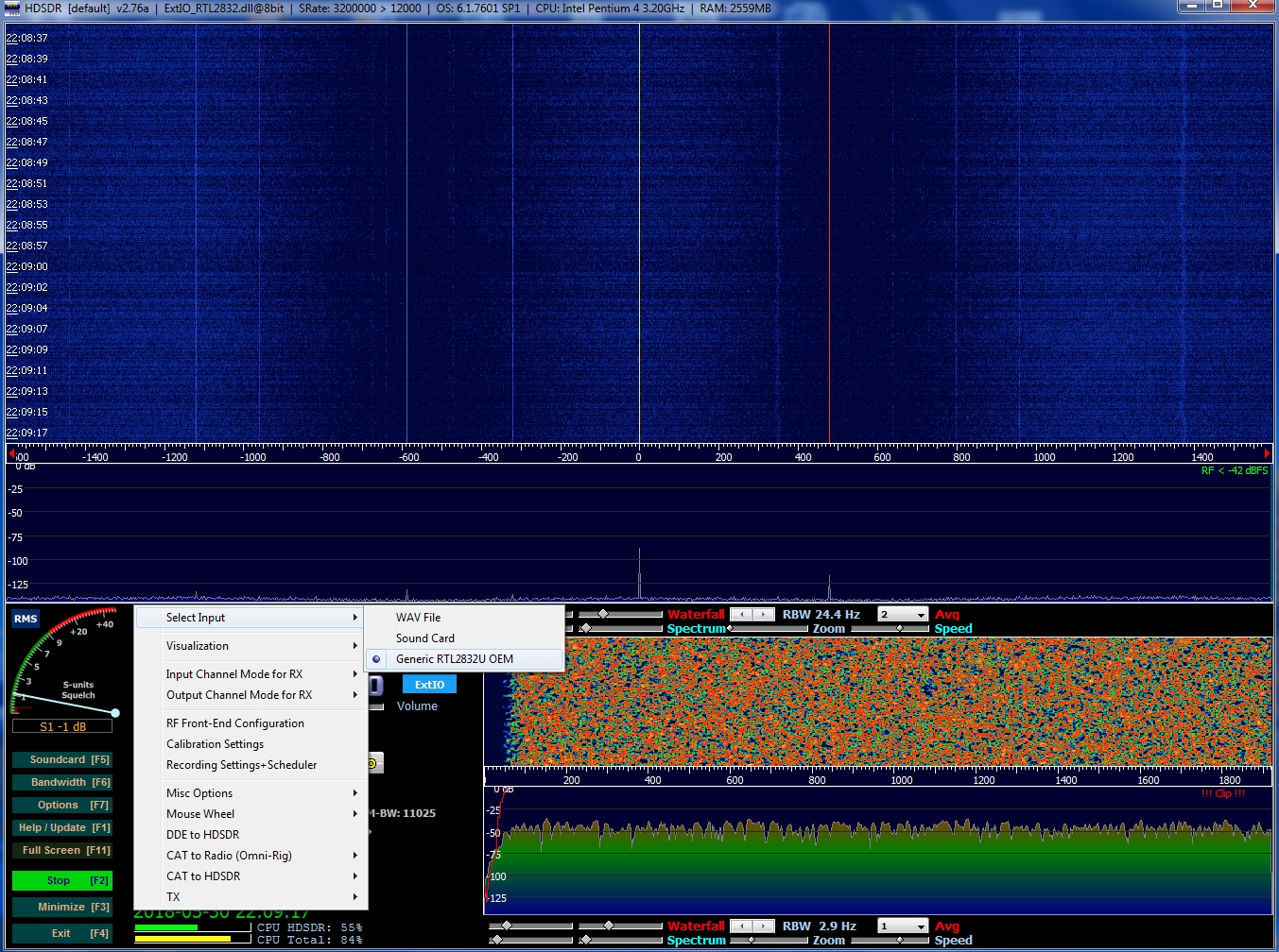

    - I am waiting for the drivers to be installed (for 7 I suspect that I need from the disc) [8.1 and 10 it downloads itself].
    - I overwrite them from the Zadig level
    And that's it.
    I configure SDRSharp: https://www.elektroda.pl/rtvforum/topic3182271.html

    It will work, but you probably have chaff in the system.
    Try to start in SDRSharp, but without that ExtIO ...

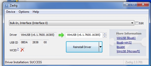

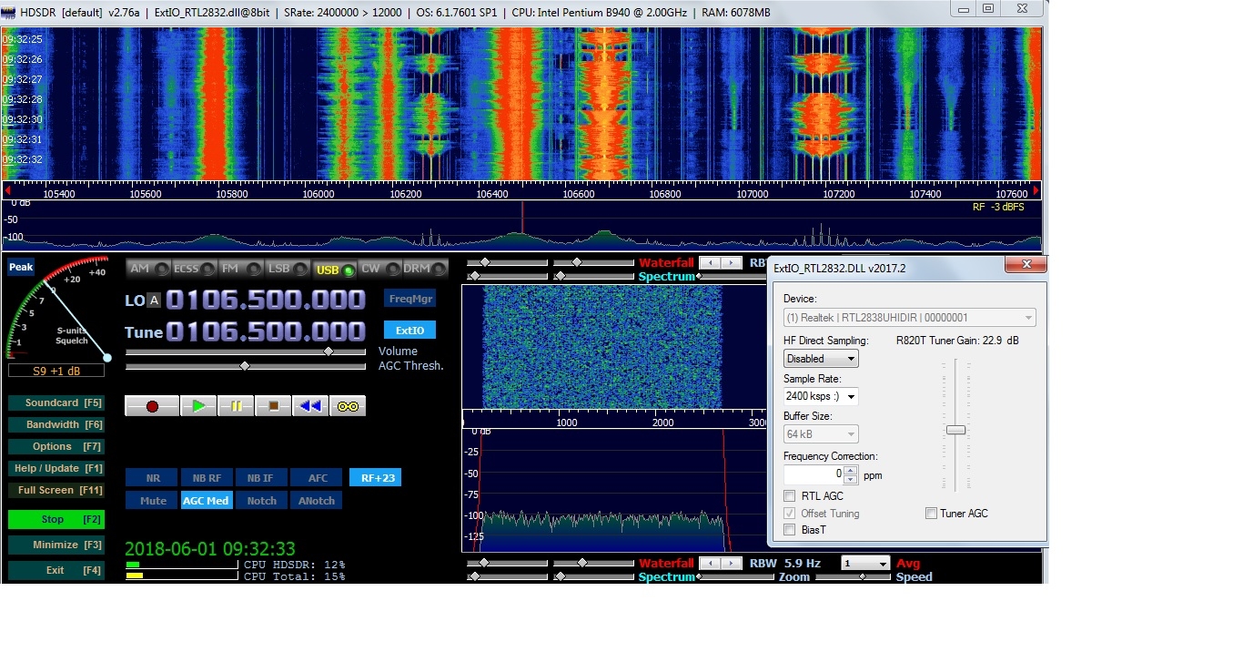

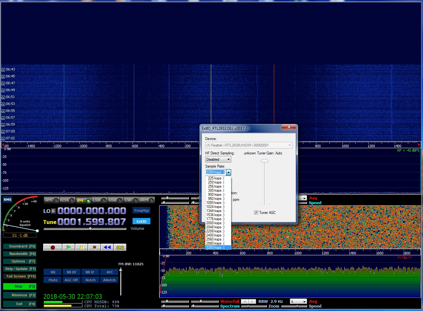

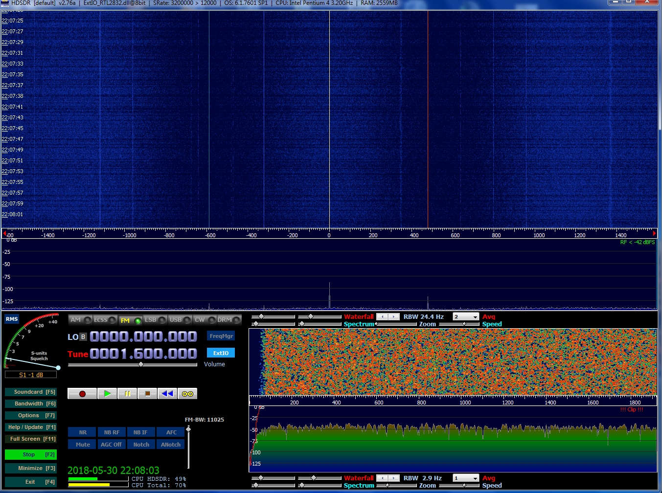

    Hello my colleague norkil20 in the attachment you have a ready program and working in this band as you want.
    DVB-T + FM + DAB Tuner and HDSDR Program Installation: Maximum Frequency Set at 1.600Hz
    And you had this problem, from what I read you did not install the original drivers from the tuner board. After inserting the tuner, you should turn on and install the tuner controls. Then turn on the zadig. Headset for the R820T tuner "setup" and attached. I do not recommend setting such a large reception width because the program may hang. It is best to set 2.4MHz as in the picture below, then the program works more stable. Hope I helped with your problem.
    There is also a question of setting "ppm" frequency shift relative to the signal. In my photo it is "0" , but you have to set it up to receive stations correctly. The description of how to do this is in my manual.

    Doesn't understand further what you mean when you say your bandwidth is narrow in terms of reception. Whether it's the width (range) seen in the spectrum, the receiving frequency, or the movement across the band. When it comes to the range seen on the spectrum, underneath it you have a slider with the name "ZOOM", there you adjust the visible range. As for the width of the received signal, in the "ExtIO" options you have the option of setting, it is best to give either 2MHz or 2.4MHz. If you want to search for anything in the range set and visible on the spectrum, use the lower counter. Use the upper counter when you want to search out of band. If you still do not know what it is for, you can write to PW, I will try to help if possible.

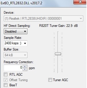

    Open ExtIO and set HFDirect Sampling to Qinput
    Frecfency Corection ppm 46 for RTL2832 R820T
  • ExtIO direct sampling and ppm settings for RTL2832
