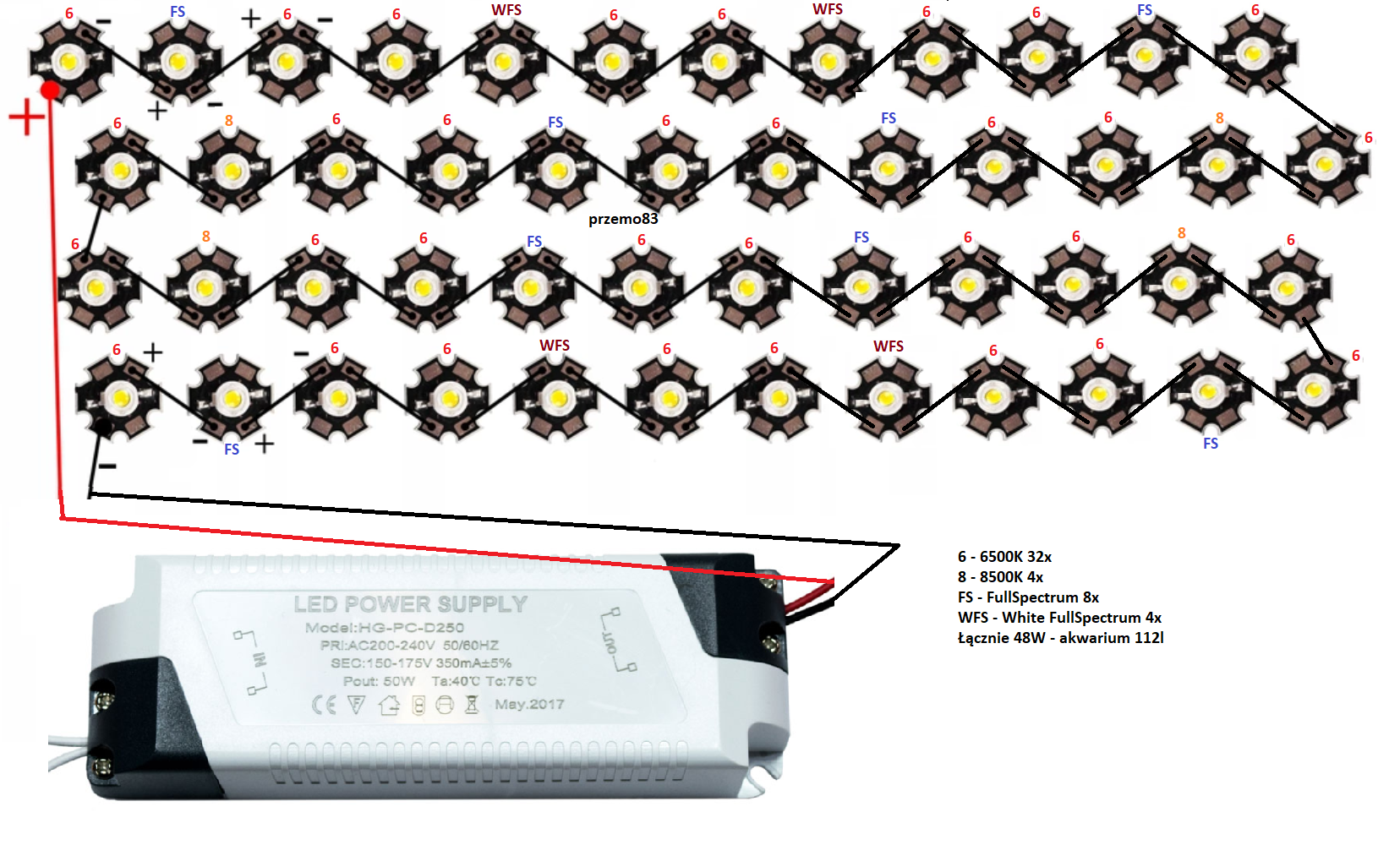

    I need help to build a 112l aquarium led beam, I would like to build a beam 80cm wide, 48W in total, such as the diagram below
    32 LEDs 6500k
    4 LEDs 8500k
    8 FullSpectrum LEDs
    4 WhiteFullSpectrum LEDs
    POWER LED 1W EPISTAR diodes, everything will be glued to the aluminum profile 80x16cm
    Constructing 112L Aquarium LED Beam: 80cm, 48W, Epistar Diodes, Soft-On Switch, & Power Supply
    Is the diagram above correct? (please make corrections if necessary)
    Will it work as it is?
    The beam will be powered by DRIVER LED 50W 350mA 150 - 170V 43 - 50W power supply (auction on Allegro no: 6930550511)
    I would like to insert a "soft on" switch into the beam so that when turned on, the light would not scare the fish, but gradually brightened - let's say 25% in, for example, 2 minutes, how to insert it and where? can you do something like this at all? (please mark it on the diagram)
    Thanks in advance for your help and explaining what and how as simple and straightforward as possible :)

    The scheme is, of course, about plus to minus and so on. Lots of soldering and fun.
    When I was doing the beam, I did not use the driver, but I took a 12V power supply and 12v PCB sockets with 3 places for diodes and resistors. It is faster to install and each module works separately, so if something falls, the 3 LED module will fall, not the whole.
    I saw such a soft on switch on the Allegro but with some low amount of watts supported.
    Such an amount is an exaggeration for such a small aquarium and the radiator will not do it.

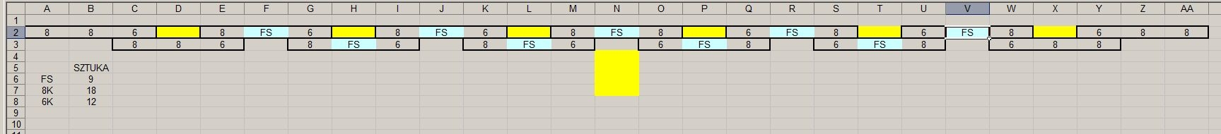

    You say that the beam is too strong for the aquarium, according to the ledow calculator it came out about 0.40 W / liter - I think it is just right for a plant aquarium :)
    I was also thinking about these 3 smd LED modules (probably Samsung golden something on Allegro), but it seems to me that they are just weaker than power led
    What is the advantage of the power supply over the driver?
    If I had to give up the driver, what power supply should I put in? (I plug it normally in place of the driver on the diagram?)
    And how with this "soft on" module? (I don't know much about it and I haven't seen anything like that on the Allegro)

    This finished strip is Rigid alu AQUA GROW bar plant growth [50cm] , I was also ordering a 10CM rail and since it's dirt cheap I ordered it. So that the glue and the clip to the power supply and ready.
    It shines well, but the disadvantage is that it shines everywhere and you can not insert lenses. But the assembly is the easiest.
    For a plant aquarium there are too many 6500 LEDs - more colored or Full Spectrum.
    I gave this beam from the screen to 140 L 50CM of the height of the aquarium. A beam 16 cm wide and there, if I'm not mistaken, I made 4 rows of these modules. Two separate cables so that I don't have to shine the whole thing. The manual dimmer is for now because, unlike the remote control, it does not break.
    You choose the wattage as usual - 12V and amps depending on the Watts you need. Since 40W, you have to take, of course, a reserve, i.e. about 60W power supply, i.e. 12Vx5A = 60W power supply. Better branded than that Chinese crap.

    Well, this pattern will not work.
    These drivers run constant current and no resistors are needed anymore. The 12V power supply gives off constant voltage and you have to combine with resistors and of course the number of LEDs per system to set the 3v LEDs with pennies so that they do not burn them.
  • #12 17498509
    duke3
    Posts: 69
    Rate: 12
    Damn it lies :D it is left to do exactly as in the diagram with such a driver and without a dimmer :(

    Yeah. As for me, it's a lot of work in such a combination. Most often it comes down to soldering wires, making them more.
    I prefer 12V, plates for 3 pieces and go. It is soldered between modules and not every diode.
