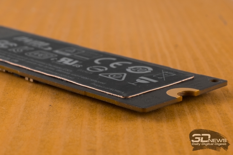

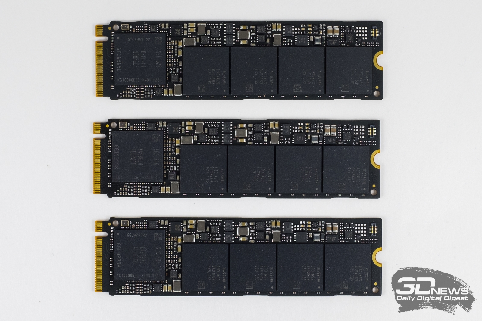

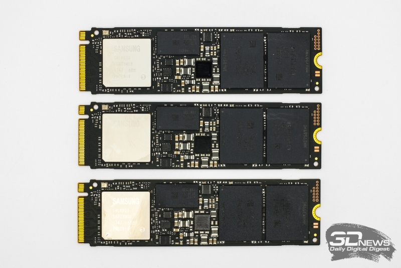

    In this article ( link ) from May 2018, it was written that the modernized new SSD S. 970 EVO is a new controller called Phoenix (like heat release increased by 15%) and the new TLC 3D V-NAND.
    All elements on one side, small plate dimensions, and even though for the first time in practice the Samsung SSD controller chip received a metal nickel plated cover, the temperature during read-write reaches temperature levels as col. Wrote.
    Samsung 970 EVO High Temperature on M2 PCIE x4: Normal or Not? User Solutions & Asrock Extreme 4 Samsung 970 EVO High Temperature on M2 PCIE x4: Normal or Not? User Solutions & Asrock Extreme 4
    At the "heart of this drive" SSD, as in 970 PRO, uses a new Phoenix chip, which is a further development of Polaris from the previous generation of drives, 960 PRO and 960 EVO. Like the previous controller, Phoenix is based on five cores with ARM-architecture, and one of the cores is engaged exclusively in maintenance of operations with the host. But the frequency of the cores in Phoenix compared to Polaris increased, and in addition, the new controller added compatibility with the Protocol NVM Express 1.3, which makes it the most powerful Foundation for consumer NVMe SSD at the moment.
    P. 2 ( link ) in the above article is a description of "thermal tests".
    Despite the built-in Dynamic Thermal Guard technology, the critical temperature was over 85 ° C (the old chip was set at 77 ° C)
    - copper foil stuck on the back side of the main disk
    - a nickel plated plate installed on the top of the controller chip housing
    - it is recommended to use the data write time on the disk max. 60-70 p .
    The main problem is:
    - removing heat from the SSD of such a small size is a big problem and just like in In the case of the SSD M. 2 the problem is even more complicated because this standard does not allow the installation of any heat sinks on the case, because they may not fit in thin laptops, where the space intended for the M. 2 ssd slot has serious height restrictions. (from 2.3- to 4.7 mm)
