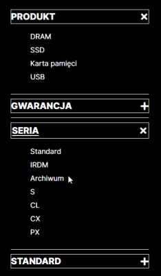

    https://www.goodram.com/kategorie/konsumenckie/
    Goodram CX 400 SSD Continuous Failure: Issues with X-KOM Service and Slow Speeds in Gaming Setup Goodram CX 400 SSD Continuous Failure: Issues with X-KOM Service and Slow Speeds in Gaming Setup
    And I add the updated version in the attachment:
    • GOODRAM SSD Toolbox v1.02.zip (845.63 KB) You must be logged in to download this attachment.
