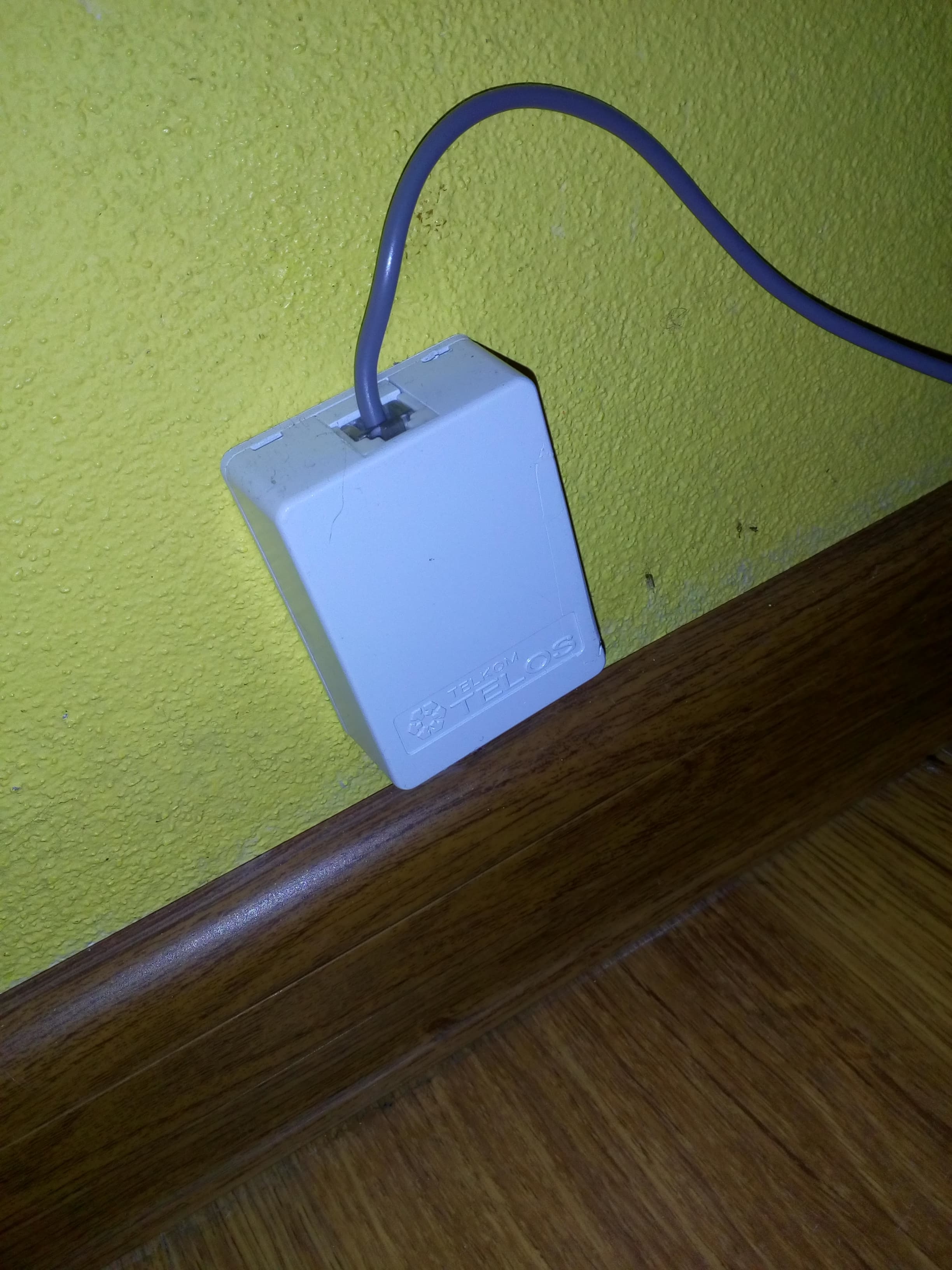

  • #16 17533708
    Av3s0m3
    Posts: 200
    Help: 27
    Rate: 17
    jimasek wrote:
    You have a choice of 2x2x0.5 YTKSY or UTP cat.5 twisted pair,
    A friend has already written to you.
    And this "gray cube" of yours is exactly what's in the movie, it's called a splitter.
    In the "cube" you should have two exits. One for the internet and one for the phone.
  • #17 17533916
    Windows problemy
    Posts: 290
    Rate: 24
    Ah, I'm sending a photo because I don't think it will arrive, there is only one exit, I have a small splitter, see this is this cube. FunBox 2.0 DSL LED Blinking Issue: 80Mbps Optical Fiber, Troubleshooting Router Connection
  • #18 17533941
    jimasek
    Posts: 35287
    Help: 3783
    Rate: 2681
    Do you think twisted veins will not interfere?
    Just asking because with dsl a telephone cable is usually used that is not twisted,
    You probably don't know what you're talking about. The YTKSY cable is twisted to a lesser extent than twisted pair because it is also a teleinformatic cable, but used for signals with a lower frequency.
    Only away from flat cables to VDSL. I wrote you what you need to buy.
  • #19 17534017
    Av3s0m3
    Posts: 200
    Help: 27
    Rate: 17
    I just don't know for that I asked myself :)
    Thanks for the clarification.
    Coming back to the topic.
    I don't know if you shouldn't have a splitter like in the movie plugged into this socket.
  • #20 17534045
