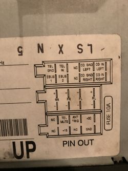

    I am asking for help because I would not like to spoil something. I do a small audio project in saab 9-3 and gen. Nothing left from the factory stuff, new speakers, amplifier on the back, Chinese radio 2 din with camera.
    This is the description of the pins on the old radio, the installation of which I want to connect

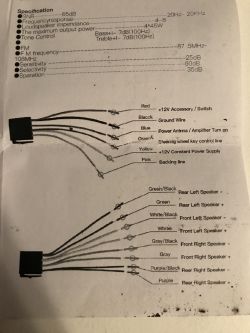

    And so the cube diagram to connect from the new radio
    Connecting Chinese -> saab - Connecting Chinese 2 din radio to install
    Of course, I am aware that these are the pins of the radio that I throw out of the car but it's only about what exactly what to connect with the cube so:
    - red + 12v Accessory / switch connect under +15?
    - black Ground Wire goes to GND
    - blue Power antenna / amplififier turn on to control the amplifier?
    - orange is steering wheel control and I do not know where it goes under ant trig (i.e. antenna control because I have a retractable?)? ebus - is it coming from the can rail? although here I know that the problem is wider, the radio from China has the option of programming buttons from the steering wheel, but this will probably be a separate struggle, because I saw both adapters that are expensive as well as connection diagrams using really several resistors
    - yellow + 12v constant power supply goes under +30
    - pink Backing line connect to reversing cam
    Please verify if this is the right direction, the speaker cables are flying so here I have no dilemma

    The radio is already running, after a more thorough verification, I understand that I was asking about funny things but if someone has plans for saab 9-3 I gen, I invite you to write PW
