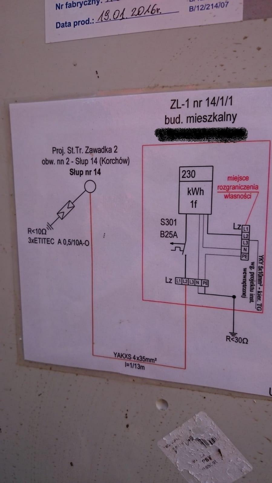

    N and PE terminal rails - whether they should be connected (bridged) N and PE terminal rails - whether they should be connected (bridged)
    Has the PEN separation been done in the meter cabinet?

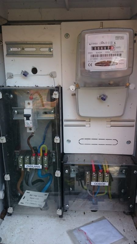

    The installation is new, maybe the photos from the meter cabinet (connections) and the home switchgear will help to answer the questions.

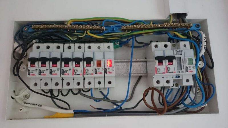

    According to the photo on the right, with the meter, you can see this chapter (the right strip under the meter)
    I am surprised, however, that "black pudding" in the home security board.
    What is this, sorry?
    Since the new installation, where the RCD for socket circuits and lighting bathrooms ?

    In the picture of the connection, I can see the separated PEN into PE and N. Is it appropriate to jumper the PE and N terminal rail in this case?

    That's how it works for two years, the electrician took the money and I didn't see him anymore. Only now I am learning electrics and I can see that something is not right here.

    It's not right.
    But the installation was done by a bricklayer-electrician, what is your colleague surprised?

    Not so hop. We do not know what the "foreman" has gotten over, although there is no danger with a 1-phase power supply, as with a 3-phase one.
    Certainly the N conductors (all) are to be placed on the N bus, and the PE conductors (all) on the PE bus. You definitely need to check (and replace with the right one) automatic circuit breakers B 20. What are they for?
    Install the RCD where required, carry out measurements and prepare a report.
    (I will not mention the description of the elements of this array)

    He bridged because he didn't install the RCD. It was done in the 70s.
    And what did he bridge the fuses with? 2.5 wires? Man hope not 1.5. It wasn't an electrician, someone had raised his receipt.
    Edit.
    It's probably 1.5. Get a fire extinguisher or call an electrician.

    This is a textbook example of how not to do.
    It is not known only why the author of this information did not include in the title post?
    Did he leave the measurement protocol for you?
    If not, call the guests and let them finish the job properly.
    If he refuses, inform him that a competent person will graduate and he will pay for it. And the Poviat Building Supervision Inspector will be notified about everything.

    The N conductors are all on the N bus and the PE conductors are on the PE bus (and grounded). As part of the tidying up, I want to install a surge arrester, an RCD and a third terminal rail for N conductors connected to the RCD. My question, is it possible to eliminate the bridging of the PE and N bus? If not, why not?

    It cannot be deleted in this configuration. But look what's under the fuses. There should be a rail there!

    In the switchboard, don't worry about the bridge, because it's all to be done from the beginning. And why is the cable described as kitchen light only two-wire?

    The figure shows that the network is TN-C, under the meter (photo above) you can see the division of the PEN conductor into PE and N.
    I do not know why the electrician in the kitchen provided a two-wire cable for lighting, maybe he was suggesting that the lighting fitting is plastic and does not require grounding.

    the figure shows that the network is TN-C, under the meter (photo above) you can see the division of the PEN conductor into PE and N.
    I have not seen such flowers. Please make sure.

    So there can be no bridge in the switchgear. Well, once a PEN has been split, it is not allowed to put it back together. So you can see that the installation was done by paprake. What's in the project anyway? Because either there are discrepancies between the design and execution, or the design is only suitable for toilet paper. Generally a messed up job.

    For me, the BCE chapter is in front of the numerator, it has been written several times to the right.
    On the right you can see that one wire goes to the GSW or ground.
    Just a little question, is the red phase wire from the meter to the terminals still in line with the standard?

    Ok, from what my colleagues wrote, I understood that:
    1. The PGE network layout is TN-C
    2. The PEN conductor has been split into PE and N before the meter
    3. Behind the meter, the network layout is TN-S
    4. As the PEN conductor has been separated in the PGE meter box, the PE and N terminal strips should not be connected to each other in the main switchboard in the house.
    5. Install the RCD and replace the B20 circuit breakers with B16.
    Did I understand correctly? If something is wrong, I ask my colleagues for correction and justification

3. Why was the electrician’s bridge in the house switchboard unsafe?
Bridging turned the PE into a working return path. If the PEN broke upstream, all PE-bonded metal could rise to 230 V, leading to fatal touch voltages [Elektroda, kortyleski, post #17536814]
4. What supply system is shown in the photos?
Utility side: TN-C (combined PEN). Inside the meter box the PEN is split, so the installation after the meter should be treated as TN-S (separate PE and N) [Elektroda, Kolchoze, post #17535348]
5. Do I need an RCD if the rails stay separated?
Yes. Regulations require 30 mA RCD protection for socket circuits and bathroom lighting in TN-S and TN-C-S systems [BS7671:2018]. Lack of RCD was the main reason the installer bridged the rails [Elektroda, Moralny, post #17533944]
6. Should I replace B20 breakers with B16?
For 2.5 mm² radial socket circuits, B16 aligns with the conductor’s 19 A rating. B20 exceeds that, risking overheating [PN-HD 60364-5-52]. One 1.5 mm² conductor can safely carry only ~14 A, so B20 is definitely oversized [IEC 60364-5-52].

9. How do I correct my switchboard wiring?
  1. Remove the N-PE bridge.
  2. Fit a main switch and a 30 mA RCD ahead of all final circuits.
  3. Re-terminate conductors: PE on the PE rail, N on the RCD-protected N rail, phases through breakers rated ≤ current-carrying capacity [Elektroda, elpapiotr, post #17533815]
10. What tests must follow rewiring?
Carry out: 1. Continuity of protective conductors, 2. Earth-fault loop impedance (IPZ) to confirm disconnection times, 3. RCD trip-time, and 4. Insulation resistance. Record results in a test certificate [Elektroda, Waski85, post #17535462]
