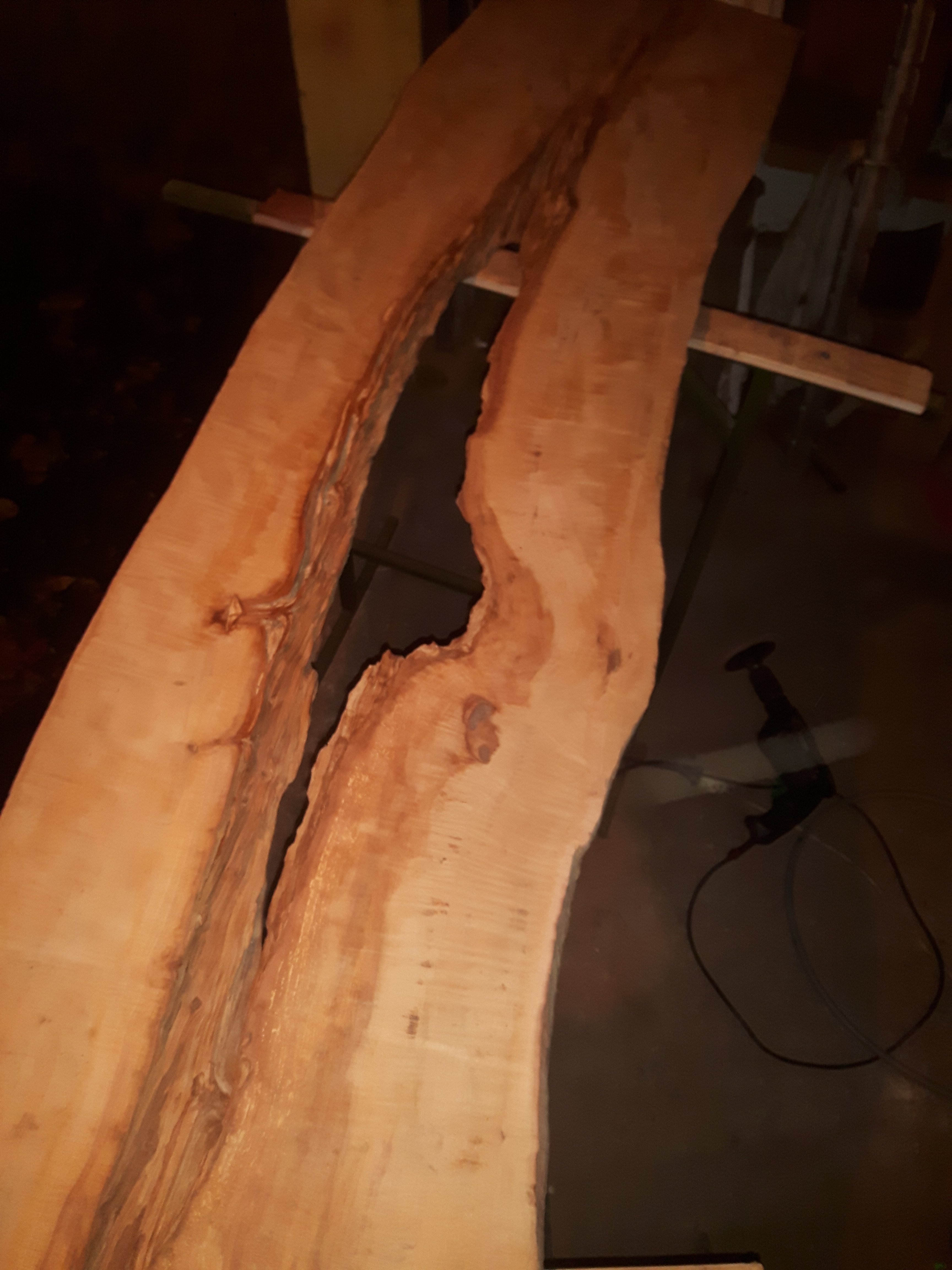

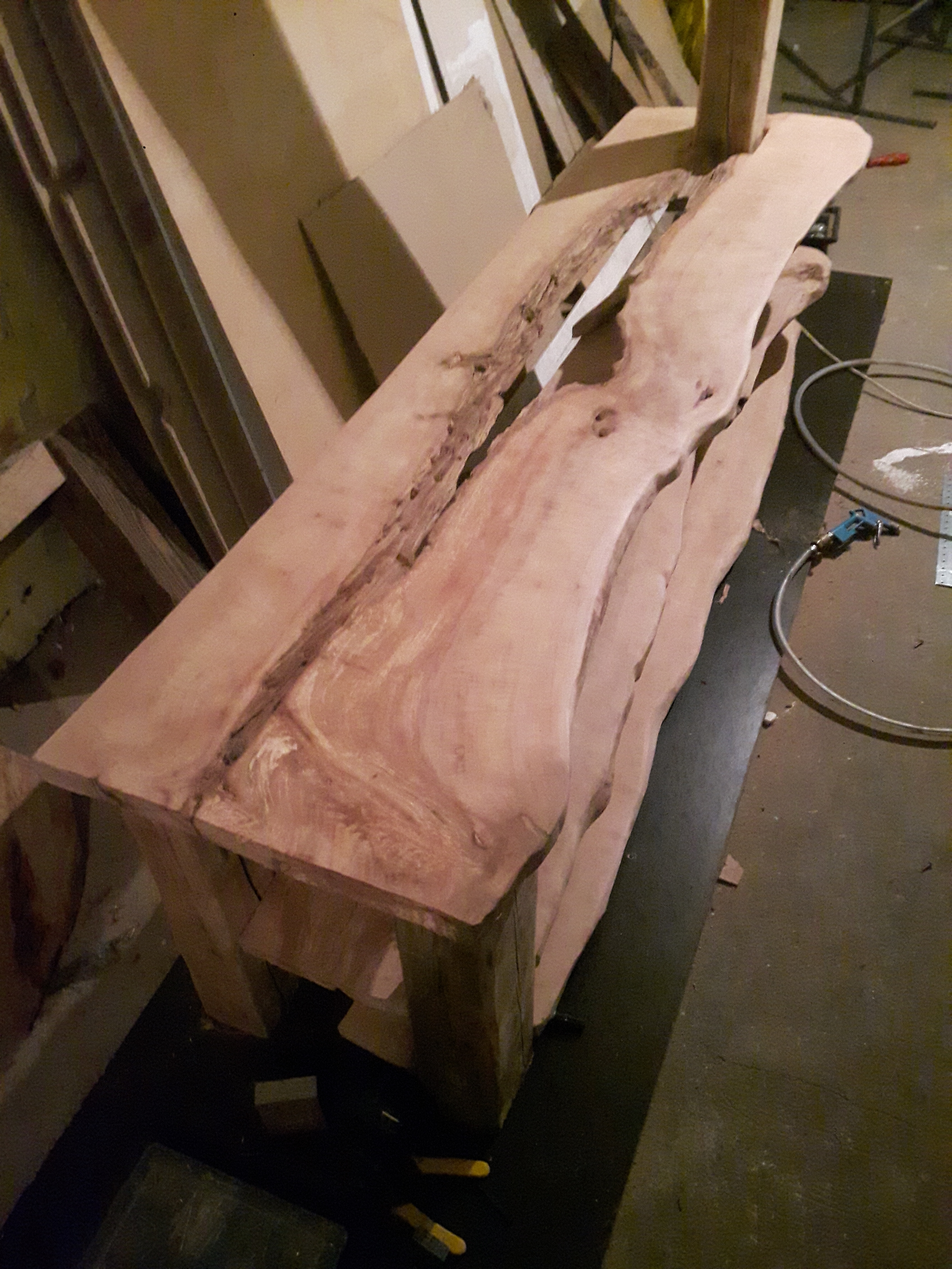

    Hello. I want to pour epoxy resin on the cavities in the wooden worktop. The top is made of pear wood, about 4 cm thick. I ordered Epidian 652 epoxy resins and IDA hardener. I have a question, has anyone worked with this resin?
    I would be grateful for some advice:
    - how to mix, mix
    - what thickness of the layers
    - how much dries
    - what to grind with
    I watched some movies on YT, but I would be grateful for the advice of someone who has actually done it and has experience.

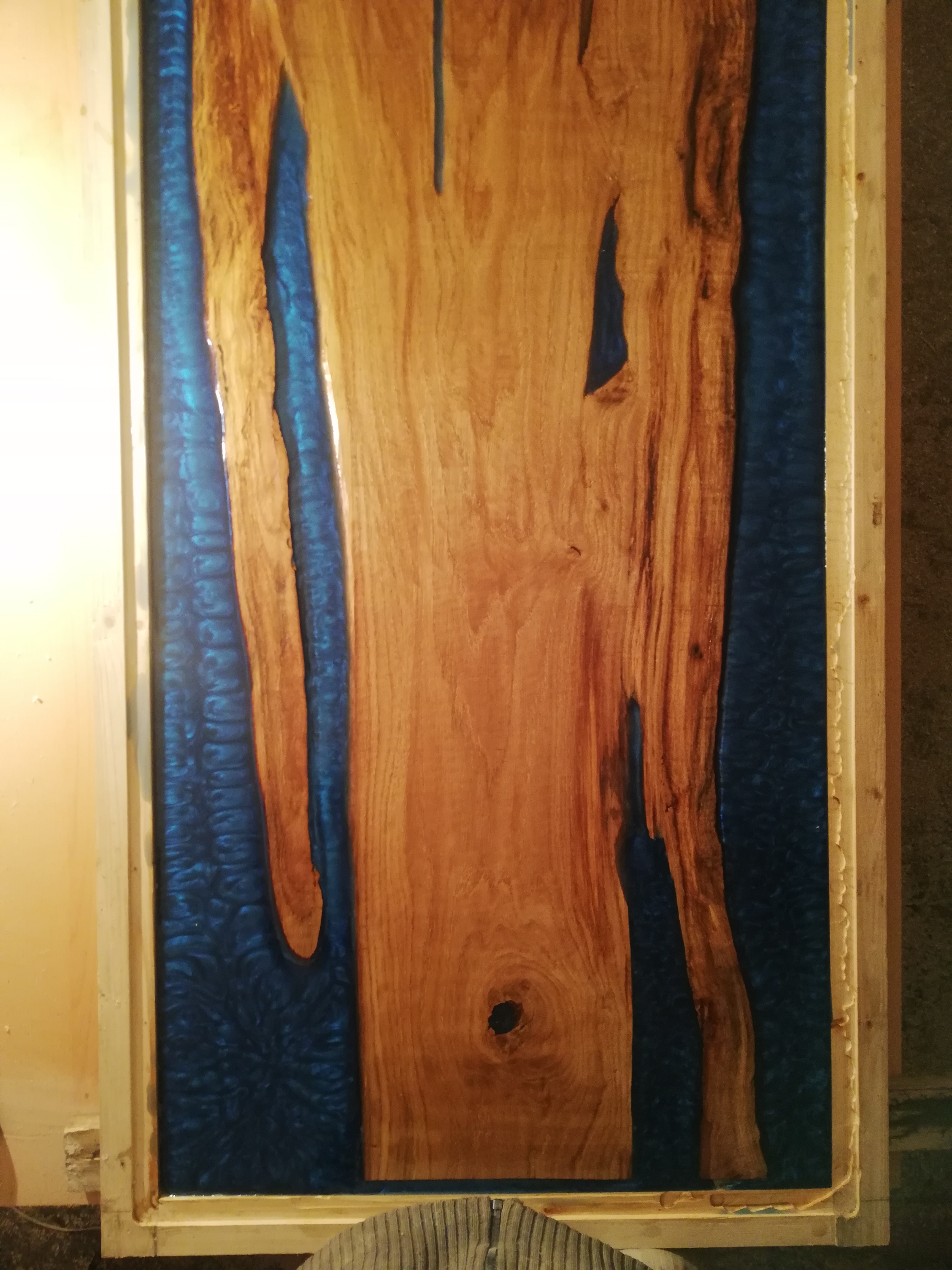

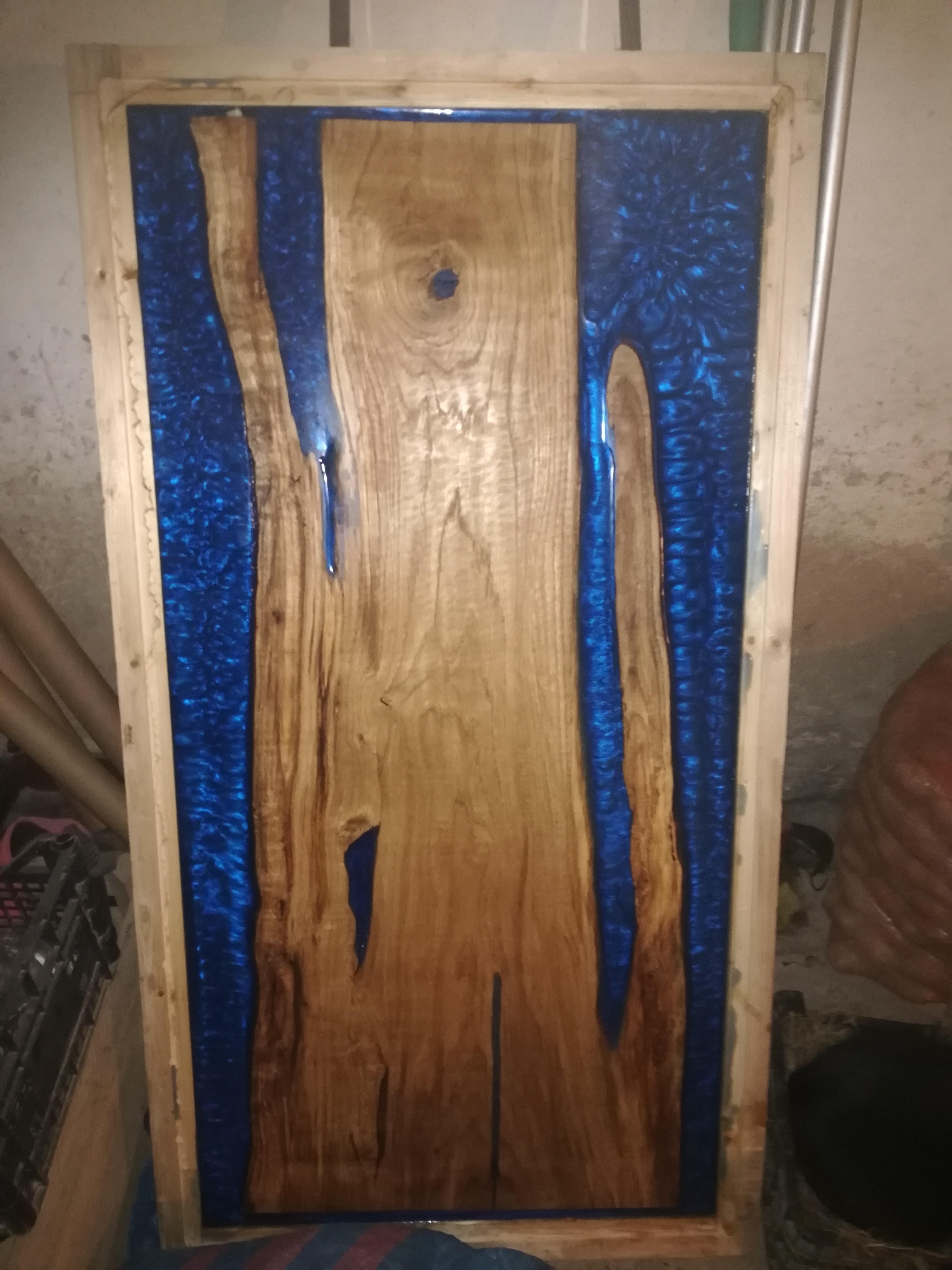

    Szacun 56
    Good morning, regarding your inquiry, I also poured the Trześniowa board with resin, here where the blue resin is, it came out great on the board and the air came out, I had to mill it again, now I'm going to paint it with wood oil and after drying, apply a colorless varnish (only the board) and then pour a layer of colorless resin ( only in layers, not at once) Pear Wood Worktop: Epidian 652 Epoxy Resin, IDA Hardener - Mixing, Layer Thickness & Drying Tips Pear Wood Worktop: Epidian 652 Epoxy Resin, IDA Hardener - Mixing, Layer Thickness & Drying Tips
