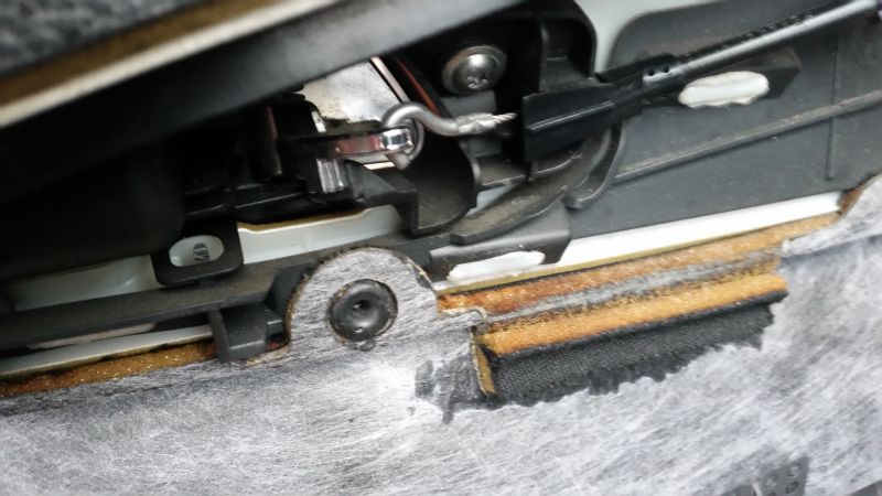

    Hello, my problem with passat is that the key does not match the lock insert (but that's not what I mean now). And the central locking does not lock me when the "lock", the driver's door. In this condition I bought it. So I got to work. I took off the top door trim. I disconnected one ankle and a cord from it to disconnect it from the door. I took a break and not long ago when I wanted to open the driver's door they did not want to open. Even when unlocking the door by central. What do you think about it? What's the problem? I will add that my battery has also discharged. But I don't drive much lately.

    Edit. Good, it seems to me that the outer handle is not attached to the cable because it is loose and the door could not be opened from the outside only from the inside

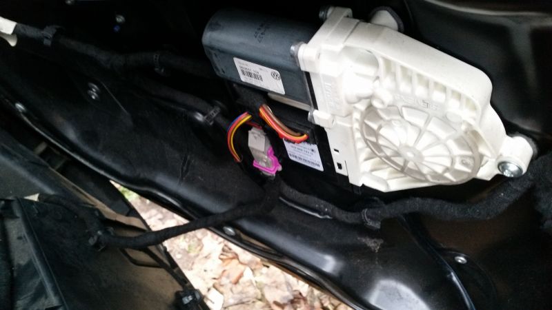

    Normally, to check (at least) there are microswitches of the limit switches of all door locks, flaps, etc. This is done using the OBD2 tester, not any meter. You can at most check them yourself by looking at turning on / off the headliner light / boot lid by closing / opening the door / boot lid in turn. Each of the drives has a door control computer, the sign of which is simply a walking glass. As the power supply to the drive is lacking in the door nothing works except the speaker. You don't have to sweep everything so much.

    It is necessary to remove the insert and check the operation of the lock with a screwdriver. It is important that the vertical bolt in the corner of the glass goes loose.

    Driver lock for replacement. The second door you take down, you measure the voltage with a 5W light bulb on the lock motor power when closing and opening. If it is a replacement, replace the second lock, if it is missing or the bulb only glows then check the cables in the door grommet and beyond.

    You have a so-called grommet between the door and the body, there you have broken wires.

    I took out the insert. By closing and opening the car with a screwdriver it closes and opens the entire car except the driver's lock which I just replaced for a replacement.
    I don't think I need it because it looks like there is no signal to this lock, so something from an electrician.

    As from the central one, it means that the actuator has power supply. If you remove the insert and it goes both ways, it's probably obvious what is wrong. If he doesn't close the driver, he may have (or rather definitely has) an open door. You were supposed to look at the beam and what. There is no need to measure anything. In general, I am surprised that you still want to bother, eh ...
