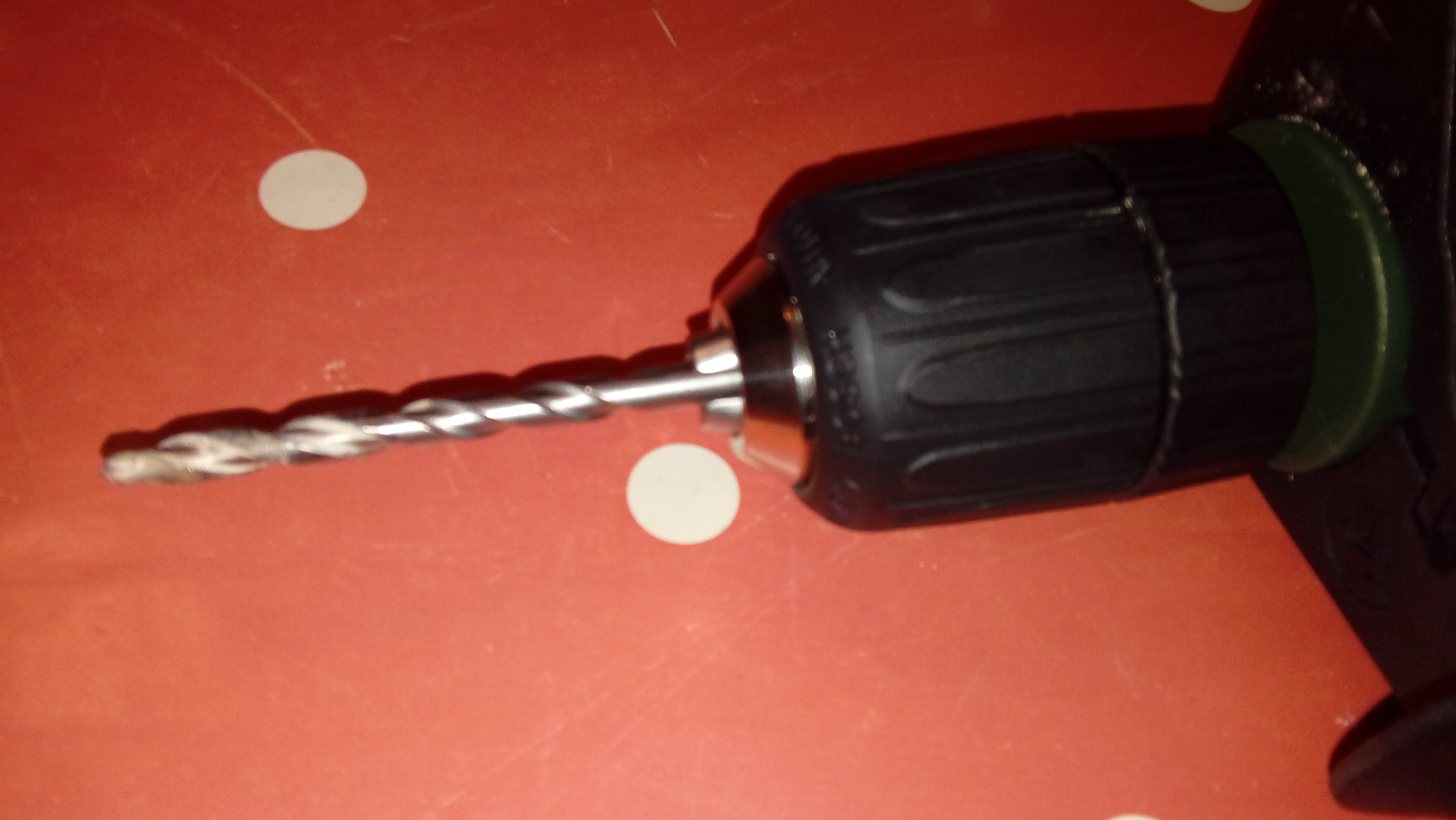

    Hello, first drilling with a new drill and I can not pull out the drill, as in the photo, on this cylinder (black tip) it is written open and an arrow to the right. I did this and nothing, neither right nor left, I have blisters on my hand and nothing, maybe someone has such a model and will advise me something?

    I did yes and nothing, either way, not even on the shock / normal switch.

    Rather, I did not force the drill like that, normally I felt resistance and stopped.
    I have read somewhere that the drill cannot be embedded too deeply, is it true? maybe it's because of this? In my first photo you can see the drill is inserted.
    when I was drilling with a hammer, I slightly pressed the drill against the wall, I do not know if this also influences the fact that it cannot be removed now
    https://www.youtube.com/watch?v=0bxeXridy8I
    In this video, 2:26 min. The guy easily pulls the drill from the same model, I tried that too, and nothing.
    Well, I will go to replace the obi drill, usually ladies do not ask why, etc.
    and so for the future that the situation does not repeat itself, any basic advice what not to do to prevent such a situation? Thank you in advance.

    If I were you, I would take the drill between my knees, and gently hit one of these three spindles with a punch, alternately - from the handle. It is possible that this will eliminate the jamming effect and you will be able to unscrew the drill bit normally. You only have to do with feeling. It also doesn't hurt to spray some WD-40

    I always do it myself as Stasiak965 writes, I will add that remove this additional handle and look if there is a hole through which you can lock the axis. In blue Boschach it is possible and then you have a firm grip to unscrew.

    I have given it to the store and am waiting for repair.
