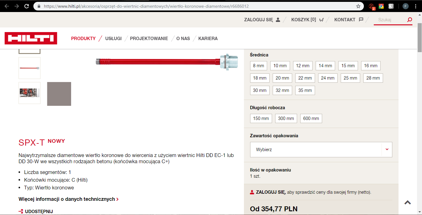

    I need to hang a cupboard on a 5 cm thick reinforced concrete tiled wall. I am planning to hang a mounting strip on 6x30 pins. Drilling with impact is rather avoided because it ends up with the wall falling off on the other side, and in this case there are tiles too, so I don't want to risk it. Do you have any drill bits that allow you to drill effectively in reinforced concrete without impact?
    I would like to add that the wall is very resistant to drilling and only SDS with pneumatic impact works well, but at the same time it damages such a thin wall (large fragments fall off on the other side of the wall).
    Thanks in advance for any advice.

    I used to read about diamond cores mounted on a contour grinder.
    Maybe it will help you.
    Regards
