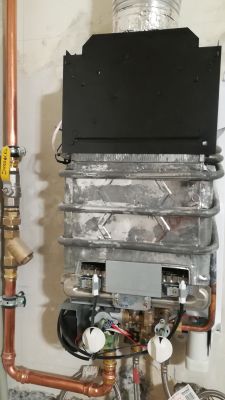

    I have a new stove installed yesterday and before the installer left it was fired several times, but not for long so we decided that everything was working.
    Unfortunately, it later turned out that the stove fires for about 5 seconds. and goes out. On the display, in addition to the temperature, the flame icon appears for a second and crashes the E3 error.
    For these 5s. a spark is continuously fed through the stove.

    Do you know what was done or replaced?

    Hello Piracik, I will answer my eye - no ionization current.

    The entire controller was replaced because there was no flame ionization.
