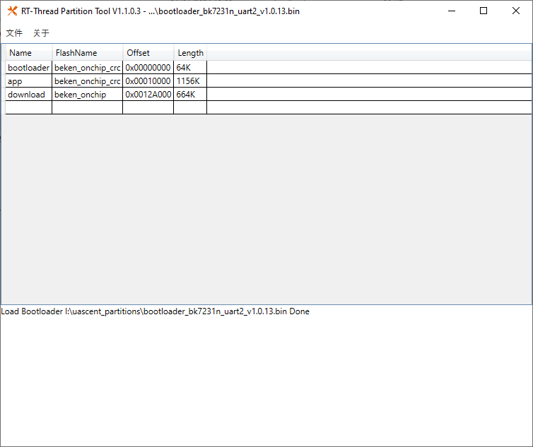

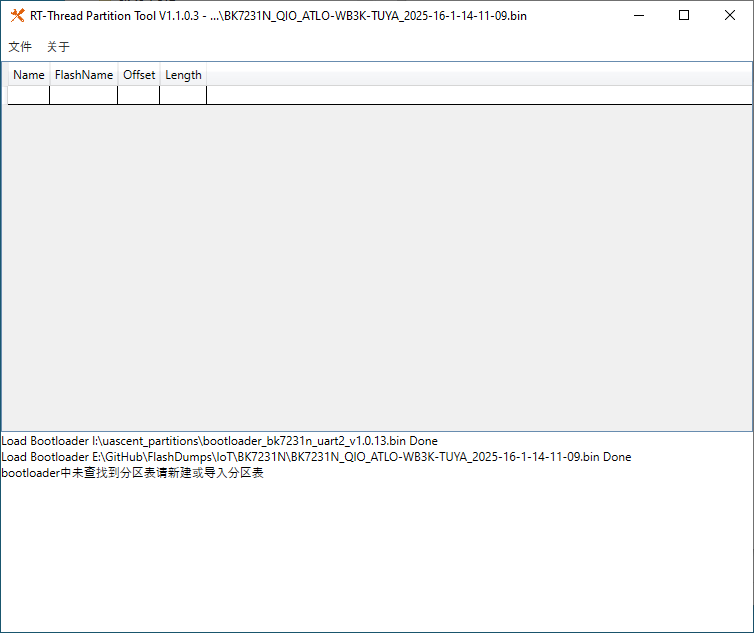

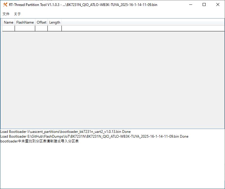

    I've been fiddling with the RT-Threads Partition Tool, which lets you edit/add partitions to a virgin bootloader.
    eg, open bootloader_bk7231n_uart2_v1.0.13.bin that can be found in the Beken SDK and the tool will show you what's set
    Partition table from bootloader file in RT-Thread Partition Tool window

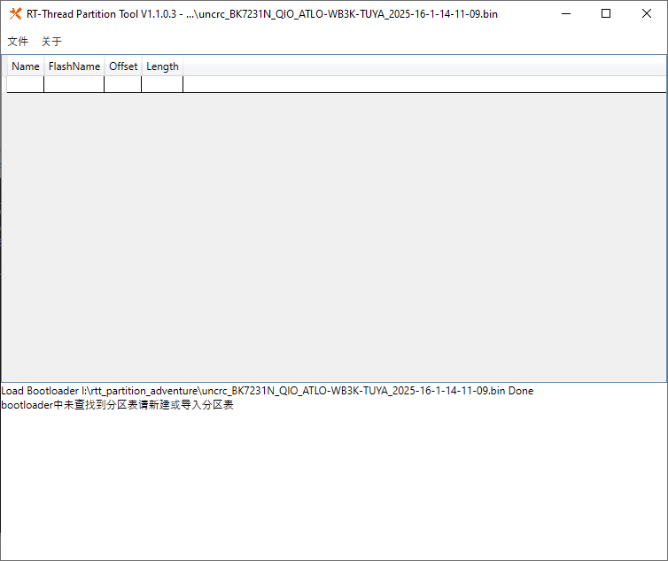

    That's great, but it doesn't work on a standard 2mb dump.
    BK7231N_QIO_ATLO-WB3K-TUYA_2025-16-1-14-11-09.bin
    RT-Thread Partition Tool window with bootloader and firmware files loaded
    With this in mind:
    insmod wrote:
    Yes, and it's that way on every beken, whether encrypted or not.
    Every 32 bytes of data is followed by 2 bytes of crc
    You can create a script that would remove those bytes to get readable strings, if required.
    and using @Paver3109's uncrc script from https://github.com/fusetim/insecurity-camera-tools/tree/main/firmware the crc can be removed
    but the resultant file is still not readable in the GUI tool nor CLI
    RT-Thread Partition Tool window showing no partition table read from BIN file

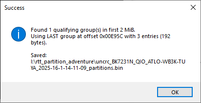

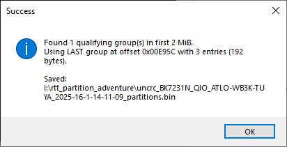

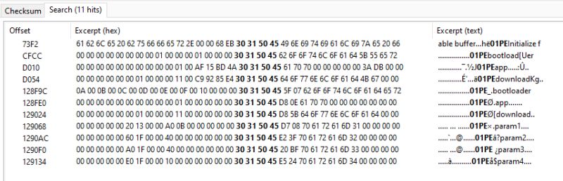

    This script will scan the first 2mb and extract the section of 2 more where "01PE" is seen 64 bytes apart
    Code: Python
    It launches a Windows picker for the input file and will give a result summary and output a file suffixed with _partitions to filename
    Success dialog showing 01PE group found and partition file saved

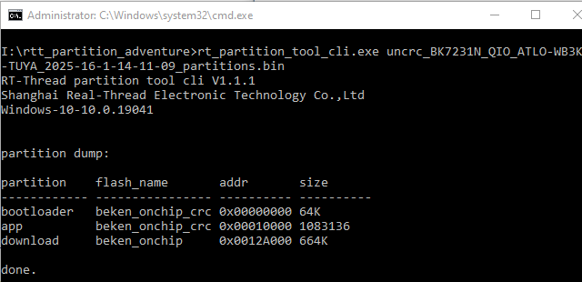

    While the result still does not reveal anything if opened with the GUI tool, it will work with the CLI
    Screenshot of rt_partition_tool_cli.exe showing flash partition data in console

    This one was interesting, and why the search for 01PE was set to cover 2mb, There's the 3 01PEs at the beginning of the flash and then another set further in
    Hex view displaying occurrences of the 01PE string in a flash dump file
    Interesting, but probably not a reason to scan beyond initial 01PE area.

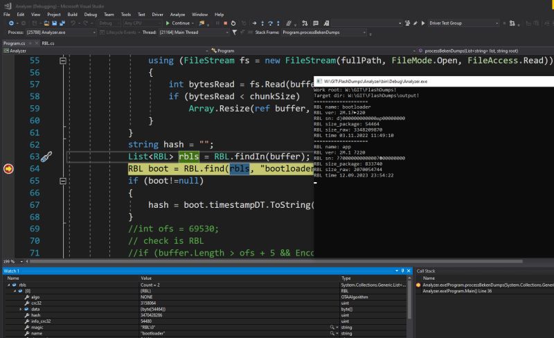

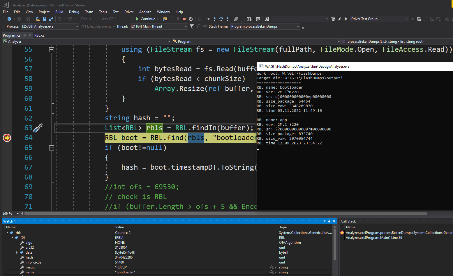

    Interesting, is it the same as the RBL extraction that I started some time ago in FlashDumps?
    Visual Studio in debug mode with C# code and console window displaying RBL data
    https://github.com/openshwprojects/FlashDumps
    https://openshwprojects.github.io/FlashDumps/
    Or wait, it seems it's not the same... RBL just finds RBL identifiers in the binary, not 01PE

    I was trying to find how many bootloader versions we know, but it didn't work too well for me. Maybe it needs more work. I think your partition table is also very good and useful to implement

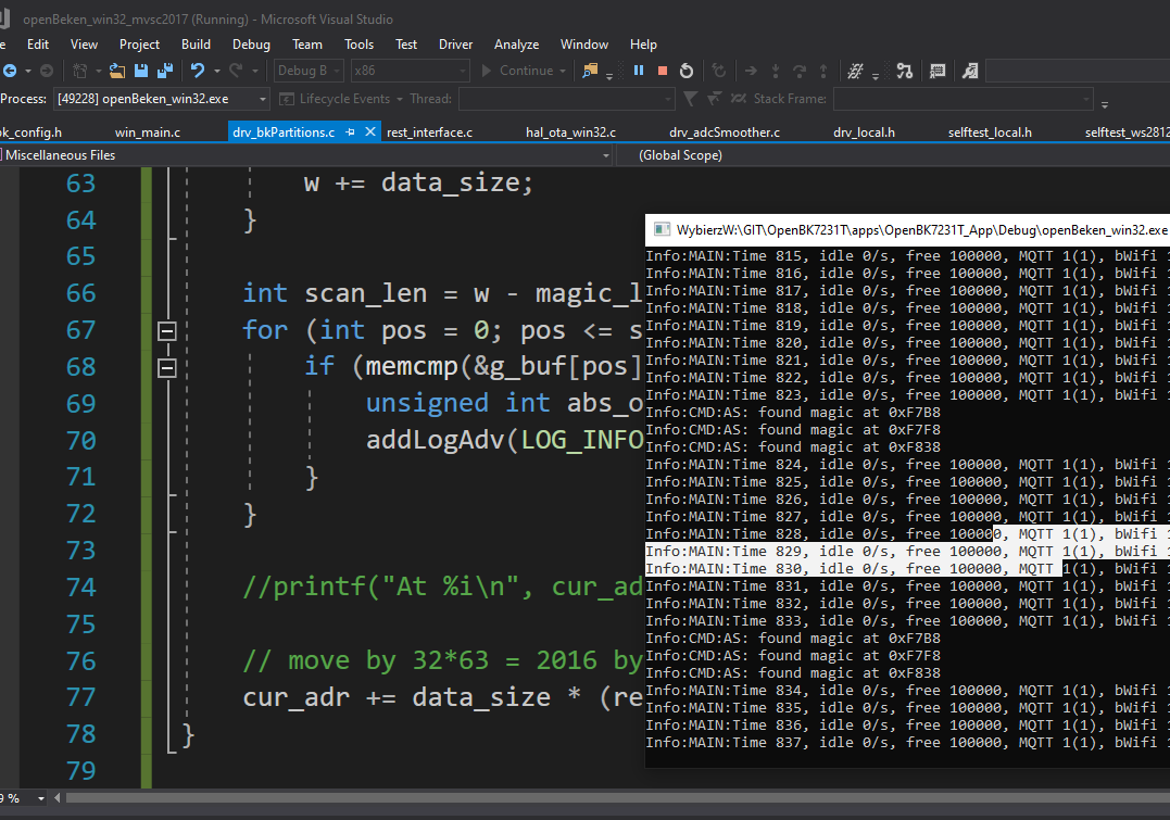

    I am not yet sure how it works internally. I've been thinking about doing flash scan for 01PE entries in OBK itself, but I would need to skip CRCs, right?
    Code: C / C++

    I am testing in the simulator with beken binary dump
    Visual Studio environment with C code and OpenBeken simulation logs shown

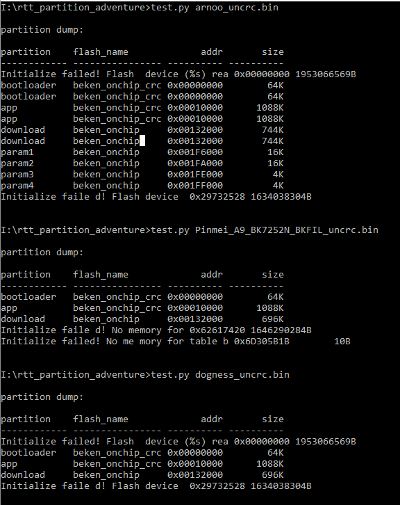

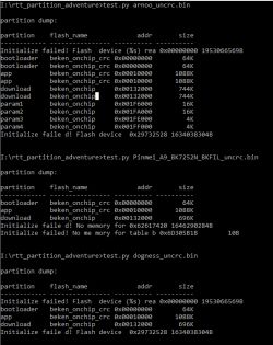

    interesting kinda
    py on uncrcd full dumps. tables plus some junk
    Console screenshot showing test.py results for various .bin files and flash errors
    Code: Python

    To be sure - we are searching for 01PE because it's not at the constant offset?
  • #13 21735714
    Posts: 5052
    Help: 438
    Rate: 893

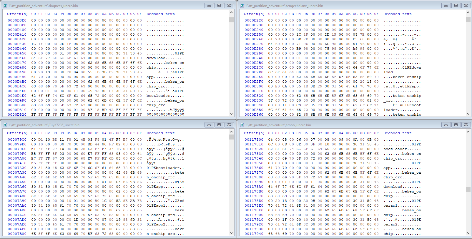

    my experience has been that it differs
    eg
    Screenshot of hex editor with four BIN files opened showing binary and decoded text
  • #14 21735727
    Posts: 14611
    Help: 654
    Rate: 12624
    I see.

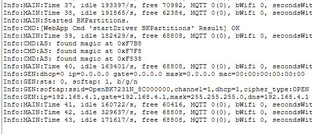

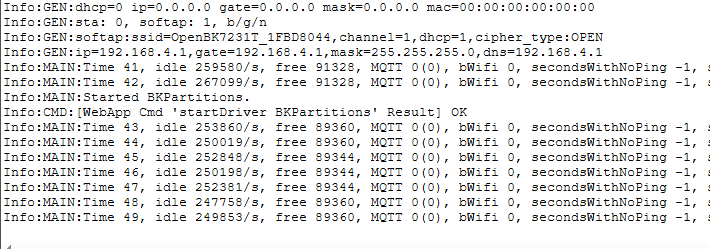

    You can try running this now:
    https://github.com/openshwprojects/OpenBK7231T_App/pull/1847
    startDriver BKPartitions
    should print offsets...
    Added after 17 [seconds]:
    wait a sec, i didn't enable it on beken i think

    Posts: 5052
    Help: 438
    Rate: 893
    N
    System logs of an IoT device booting, showing Wi-Fi network and MQTT status
    T gave no result

    I've pushed a little change. I added 0x200000 offset. I'm curious whether it will work - it's the same trick which is used by flasher.
  • #19 21736095
    Posts: 5052
    Help: 438
    Rate: 893
    negative. 1847_merge_c03a1c868c29
    Screenshot of a system log with network and MQTT connectivity status

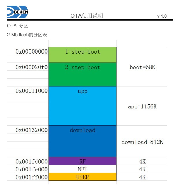

    divadiow wrote:
    Non-Tuya BK7231U - Arnoo_Winees_WS010078261_AiDot_RGBW_A60_(2ndGen)_(light.A001139)_Leedarson_CC8000_2.0.4.51.bin
    interesting.
    Memory map of 2 Mb flash divided into boot, app, download, RF, NET, and USER sections

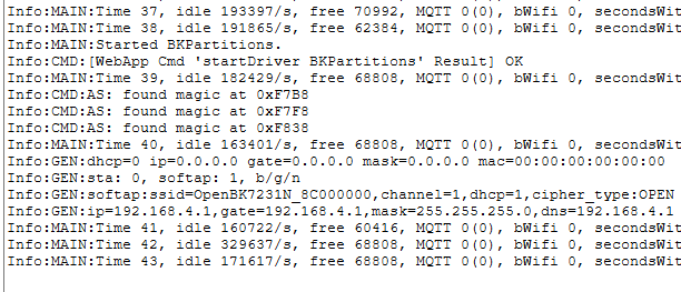

    Info:CMD:AS: found magic at 0xF7A2
    Info:CMD:AS: nearest at 0xF790
    Info:CMD:Partition found at 0xF7EC: bootloader flash=beken_onchip_crc offset=0x0 size=65536 extra=0 layout=fal64
    Info:CMD:Partition found at 0xF82C: app flash=beken_onchip_crc offset=0x10000 size=1083136 extra=0 layout=fal64
    Info:CMD:Partition found at 0xF86C: download flash=beken_onchip offset=0x12A000 size=679936 extra=0 layout=fal64
    I pushed a fix, still probably N only.

    1847_merge_c8e0bc728e21
    BK-T
    BK-N
  • #22 21737516
    Posts: 14611
    Help: 654
    Rate: 12624
    Wait, what? It suddenly started working for T? Well, there indeed was a bug...
    Why is the partition twice in T?

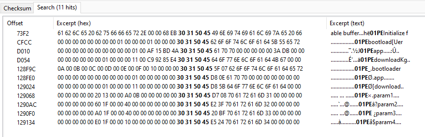

    only 3 01PE
    Hex memory dump showing 01PEbootloader, 01PEapp, and 01PEdownload labels

✨ The discussion focuses on extracting Beken flash dump partition information using the RT-Threads Partition Tool to facilitate OpenBK* firmware conversions and enable OTA updates. The main challenge is identifying partition offsets and lengths, particularly the "01PE" partition table signature, which varies in location and requires handling little-endian reverse byte order and CRC16 checksums embedded every 34 bytes. A combined Python script (combined_uncrc_extract_run.py) was developed to remove CRC16 checksums and extract partition tables from firmware dumps, followed by using the RT-Thread partition tool CLI to parse and display partition layouts. The tool supports different partition table formats (fal64 and fal48) and outputs partition names, flash types, addresses, and sizes. Attempts to integrate partition detection directly into OpenBK firmware were discussed, including scanning flash memory for "01PE" signatures and skipping CRCs. The conversation also covers challenges with bootloader compatibility, encryption, and CRC validation, especially for Uascent and Tuya bootloaders on BK7231N and BK7231T chips. Testing showed that OTA functionality depends on correct partition offsets and bootloader keys, with some success in creating replacement bootloaders that support OTA on non-standard layouts. The importance of TLV detection for MAC and RF data restoration was noted. Suggestions include adding partition detection to flashing tools like Easy Flasher and improving CRC16 verification in scripts. Overall, the approach aids in troubleshooting OTA failures by accurately identifying partition layouts and offsets in Beken-based devices.
TL;DR: Beken dumps pack a CRC16 every 34 bytes; “Every 32 bytes of data is followed by 2 bytes of crc.” Extract the 01PE table (64‑byte entries) from the first 2 MiB, then parse it to get exact bootloader/app/OTA offsets for OpenBeken. [Elektroda, divadiow, post #21734412]
Why it matters: This lets you decide if you must flash a QIO bootloader or adjust OTA to avoid bricking.
Who this is for: OpenBeken/Tuya/Beken tinkerers who need reliable partition offsets from raw flash dumps so OTA and backups work consistently.
How do I extract Beken partition info from a full flash dump?
Run a combined workflow: 1) strip the interleaved CRC (32+2 bytes), 2) scan the first 2 MiB for 01PE entries and extract the last valid group, 3) feed that file to rt_partition_tool_cli to print the table. The provided combined_uncrc_extract_run.py automates all three steps. [Elektroda, divadiow, post #21735502]
Why does the RT‑Thread GUI show nothing on a 2 MiB dump, but the CLI works?
The GUI expects a clean partition blob, while full dumps include CRC16 bytes every 34 bytes and other data. After removing CRCs and isolating the 01PE group, the CLI parses and prints partitions correctly. “It will work with the CLI.” [Elektroda, divadiow, post #21734412]
What is the “01PE” table and why are entries 64 bytes apart?
01PE is the FAL (Flash Abstraction Layer) magic used by Beken/RT‑Thread bootloaders to list partitions. Each entry is 64 bytes. Searching the first 2 MiB for contiguous 01PE entries (i, i+64, …) yields the active table that tools can decode. [Elektroda, divadiow, post #21734412]
Can OpenBeken detect partitions on the device without a PC?
Yes. The BKPartitions driver scans flash for 01PE, applies sanity checks, and logs partition name, flash type, offset, and size at boot or on command. Example logs show bootloader at 0x0, app at 0x10000, and download near 0x12A000–0x132000. [Elektroda, p.kaczmarek2, post #21737153]
Will this approach work on all Tuya/Beken variants?
No. Some Tuya BK7238 and 4 MB BK7252U dumps contain no 01PE; the scan returns nothing. In those cases, you need a different strategy (e.g., vendor bootloader knowledge or alternate tooling). That’s an expected edge case. [Elektroda, divadiow, post #21734412]
What offsets are typical on BK7231N/T devices?
Logs show common layouts: bootloader 0x00000000 (64K), app 0x00010000 (~1,083,136 bytes), and download around 0x0012A000 or 0x00132000 (≈664–680K). Values vary by build, so always read the actual table before OTA. [Elektroda, p.kaczmarek2, post #21737515]
How do I handle duplicate or multiple 01PE groups?
De‑duplicate entries and prefer the last valid group in the first 2 MiB window. 4 MB dumps can show repeated entries; sorting and deduping by address/name normalizes the output before use. [Elektroda, divadiow, post #21734412]
Could OTA fail even if I flashed the app?
Yes. OpenBeken writes OTA to a fixed offset; if the bootloader checks another offset, OTA will fail. Read the partition table first or flash a bootloader aligned with OBK’s OTA expectations (e.g., QIO release). [Elektroda, divadiow, post #21734412]
What CRC16 parameters are used when validating 34‑byte records?
Use CRC16 with polynomial 0x8005 and initial value 0xFFFF over each 32‑byte data block; the following 2 bytes store the CRC (little‑endian). Validating avoids blindly stripping bytes from unrelated data. [Elektroda, p.kaczmarek2, post #21737854]
Why does CRC checking stop working part‑way through my dump?
Not all regions use the 32+2 CRC scheme. During checks, validation can start failing (example: at offset 57,528), so switch to raw parsing or limit the CRC‑aware window to the confirmed region. [Elektroda, p.kaczmarek2, post #21737860]
Can OBK use partition scanning to pick a safe LFS/OTA offset automatically?
Yes, that’s the idea behind the BKPartitions work. OBK can scan 01PE, validate lengths, and pick offsets to reduce user error on non‑standard layouts. It’s already printing partitions from live devices. [Elektroda, p.kaczmarek2, post #21737153]
What’s special about the Uascent bootloader OTA address?
“If I remember it correctly, Uascent bootloader OTA address is 0x147000.” Using that address risks overwriting LFS and RF/config partitions unless the layout matches. Adjust tools or replace the bootloader. [Elektroda, insmod, post #21737549]
How do I quickly run the extraction on Windows? (3‑step How‑To)
  1. Run combined_uncrc_extract_run.py to remove CRC and extract the last 01PE group. 2. The script emits _partitions.bin. 3. It launches rt_partition_tool_cli.exe to print partition name/offset/size. [Elektroda, divadiow, post #21735502]
Why search for 01PE instead of reading a constant offset?
Because the table’s location varies across devices and builds. Screenshots show different 01PE offsets even for similar chips, so fixed addresses are unreliable. Searching ensures you use the active table. [Elektroda, divadiow, post #21735714]
Where can I find sample dumps to test my parser?
A public repository of IoT flash dumps is linked from the thread. Use these to validate your extraction and dedup logic across chip variants and sizes. [Elektroda, divadiow, post #21734412]
Is TLV (MAC/RF) detection useful with partition scanning?
Yes. After parsing partitions, TLV detection helps locate MAC, RF, and calibration data so you can preserve and restore them where OpenBeken expects. This is valuable during cross‑SDK migrations. [Elektroda, divadiow, post #21738157]
