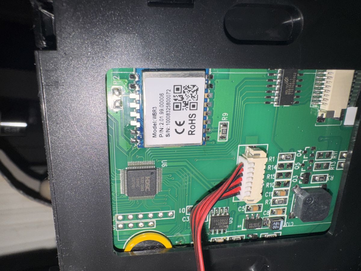

    gandi69
    Posts: 99
    Hi - I was hoping someone else had already done something of this nature so I could just buy that device. This isn't for experimentation or to see if I can make it work; more just to get my current device off cloud and I feel obk is the easiest way to achieve this. So yes, open to recommendations
    Added after 7 [hours] 41 [minutes]:
    Do you think it would be possible to replicate the config listed here:
    https://templates.blakadder.com/ME81H.html

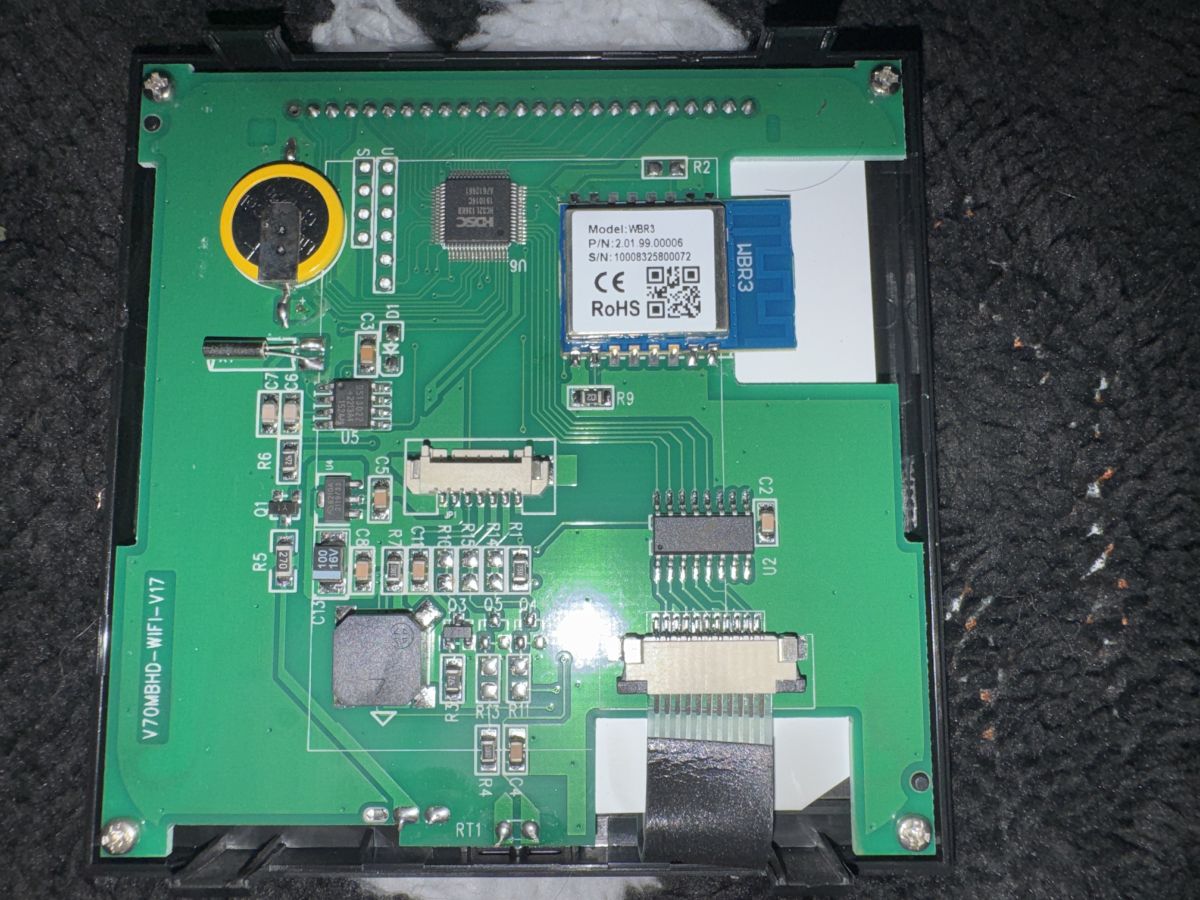

    But rather than swapping it to esp32 use the installed Realtek 8710c would I be able to replicate that config on this?
    My current thermostat has a wbr3 which is very similar to the one linked above if not the same.
    Close-up of a circuit board with WB3 module and connected red-black wires

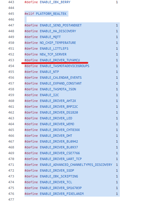

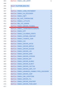

    Screenshot of code section with #define settings for REALTEK platform
    Default release does support TuyaMCU so in theory it should work - again just from my experience - I haven't tested that, maybe @insmod can say more or @p.kaczmarek2 ??

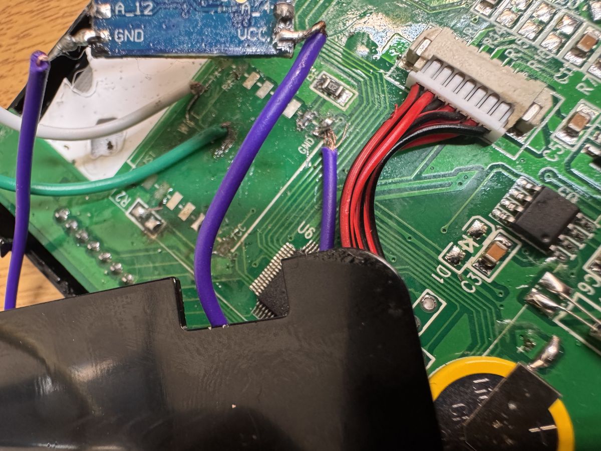

    #14 21736432
    gandi69
    Posts: 99
    therein lies the problem i've lost RX, TX and VCC.
    Added after 23 [minutes]:
    Close-up of a PCB with soldered wires, connector, and electronic components
    As you can see here pads are all but dead so I had to expose tracks on the board but scraping material away.
    It does seem to come up now but naturally this board is no good for normal use in the state it’s currently in.
    However one to test with I think maybe. Can provide the back up for dlpds

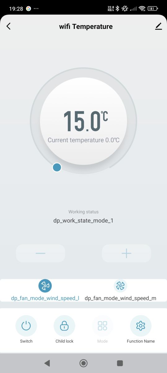

    #20 21736672
    Posts: 5213
    Help: 446
    Rate: 914

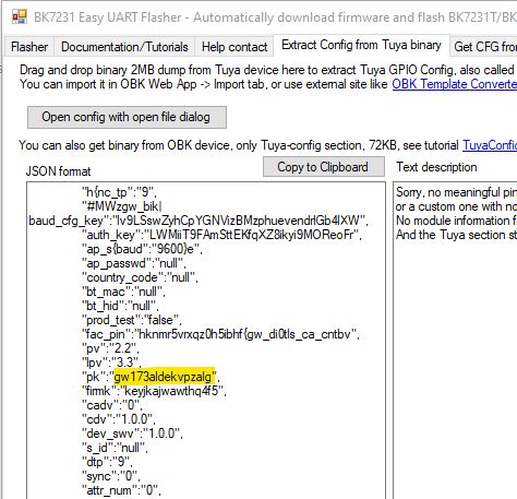

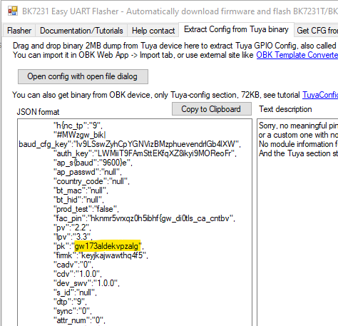

    managed to get product key but had to rebuild relaxed extraction EF to reveal more info
    Screenshot of BK7231 Easy UART Flasher with JSON configuration data
    these are dpIDs from Tuya if pairing your backup and using key gw173aldekvpzalg (search for that links to something here https://www.elektroda.com/rtvforum/topic4056015.html#21395869)
    hope it's right
    your bootlog
    Added after 9 [minutes]:
    when (if? - I was expecting to see schema ID in extraction but it's null, but your wifi creds are in backup) you paired with Tuya, which of these two is how the device looked in the app?

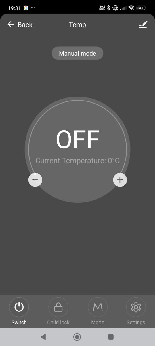

    App screen showing thermostat set to OFF and temperature at 0°C WiFi temperature control app screen set to 15.0°C

    Posts: 5213
    Help: 446
    Rate: 914
    gandi69 wrote:
    yellow background but very similar and a bit “older” looking but very similar yes
    oh. yellow. hmm ok. did you happen to capture the boot log before de-soldering?
    the relevance of the product key is so this can be achieved with backup flashed to RTL and it paired in association with the Tuya MCU Debugging Assistant: https://www.elektroda.com/rtvforum/topic4085796.html
    Added after 6 [minutes]:
    the second pic is using your factory pin instead of the product key. I thnk there's some preference of order between factory pin and product code. As in, if there's a fac_pin set, then that could mean a different schema is pulled down to the device upon pairing vs just product key. Not 100% sure of the pattern/reasoning.
    anyway, if/when you get OBK up and running you can have it query the TuyaMCU for dpIDs and the key it's using. It just won't have all the values and descriptions you can get from Tuya
  • #23 21736783
    gandi69
    Posts: 99
    Wall thermostat and smartphone app showing 26.5°C temperature
    This is what the controls looked like in app. Going to try soldering and flashing a new one up (I have a spare similar one at hand) and then see what I can do about this dpid situation - it’s dpID not Dpld right?
