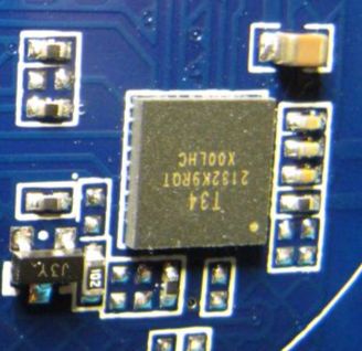

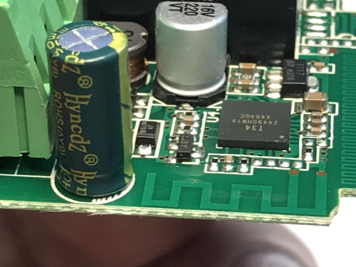

  • T34 module in LGA package with fine wires soldered to pads
    There are an increasing number of backplane relay modules on the market based on the T34 chip. The T34 is an integrated Wi-Fi chip that is a smaller version of the popular CB2S/CB3S/itd based on the BK7231N core. Although it is still the same chip from the software side, changing its software is more difficult, because in new devices there is no longer a derived serial port and you have to solder this chip in the LGA case off the board. Here I will try to show this process.
    Let me remind you of the main topic about the T34: T34 datasheet, pinout, flashing and common mistakes - soldering to QFN pins, smart plug
    In that topic, the T34 occurred in a version where you could solder wires to its pads:
    Close-up of T34 LGA chip soldered to green PCB circuit board
    Here it will be more difficult - access to the pads is not available! This means that we no longer have a "shortcut" and we have to solder the whole T34 off the PCB, and after programming it has to go back in place.

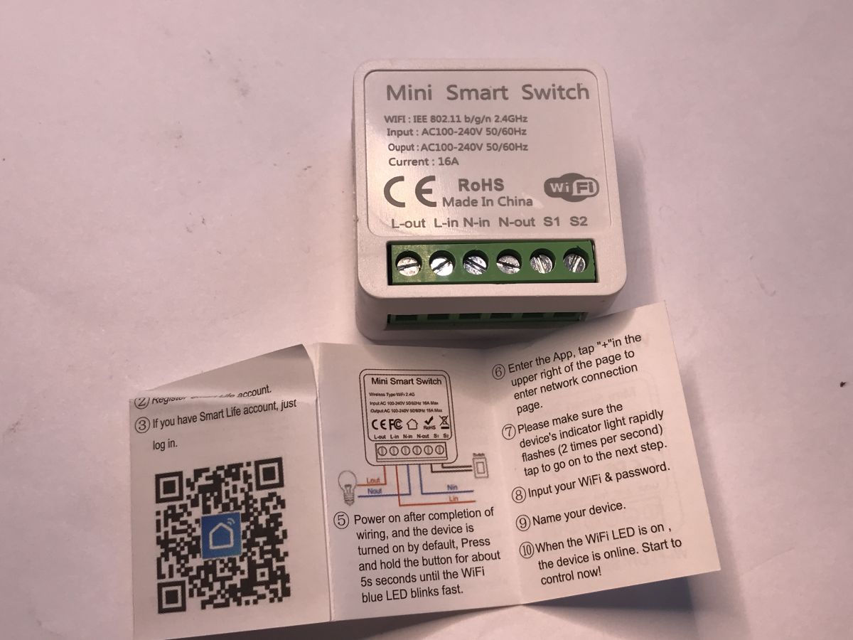

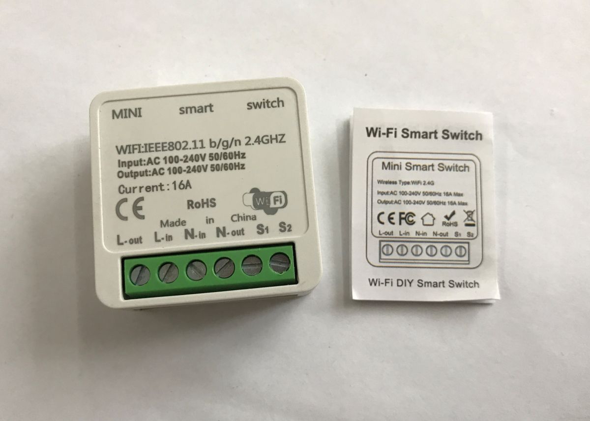

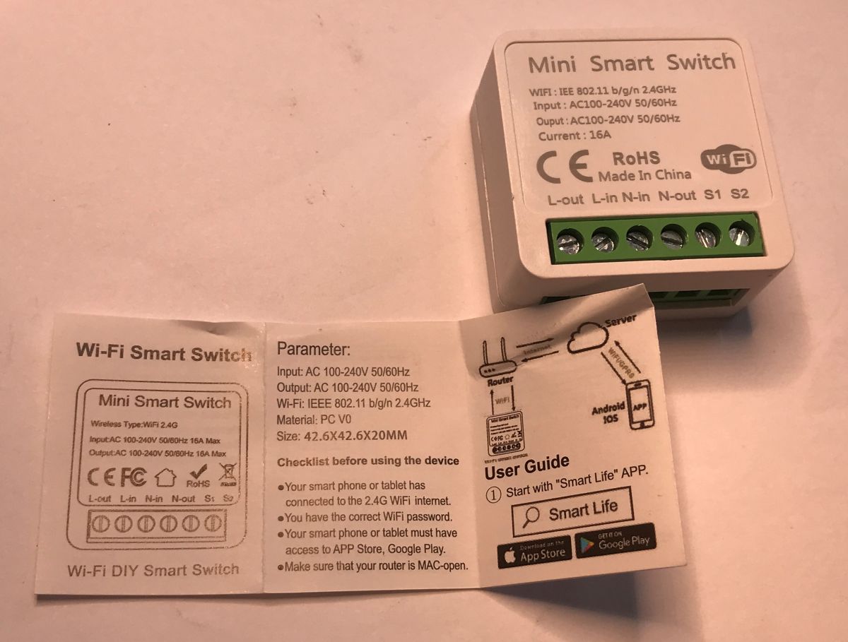

    There is a module and instructions inside:
    Wi-Fi Mini Smart Switch with English-language instruction manual Mini Smart Switch with quick start guide and QR code for Smart Life app Wi-Fi relay module and instruction sheet with labeled connectors and specs

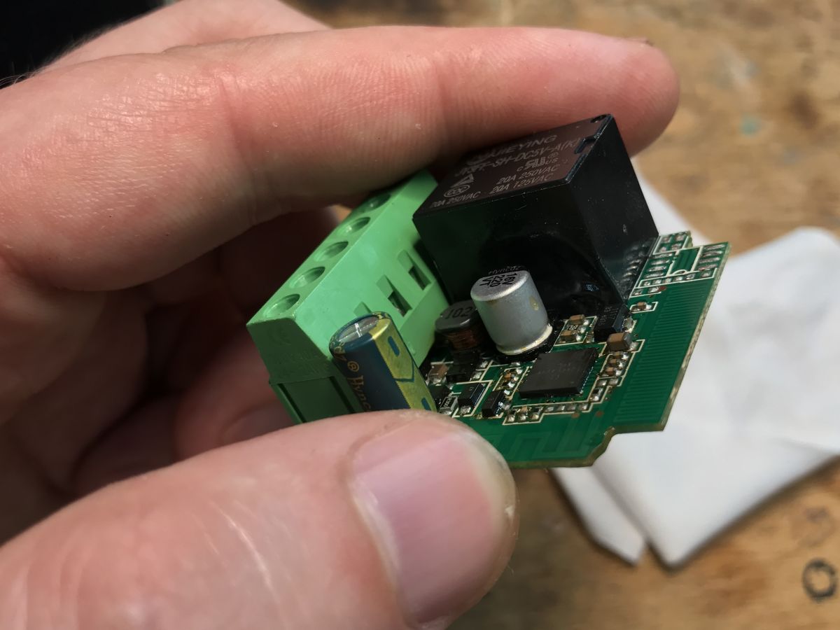

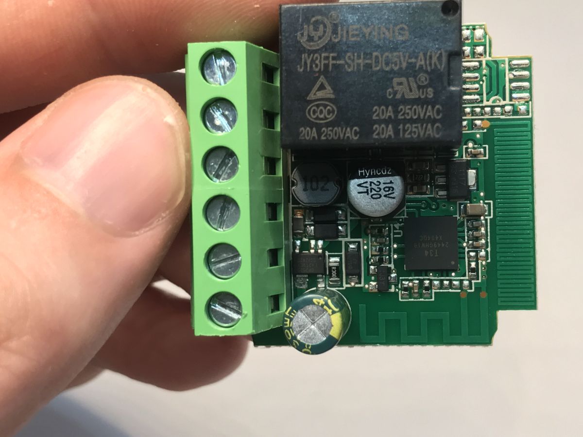

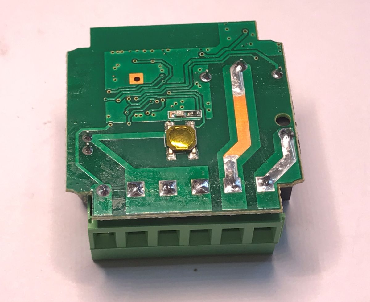

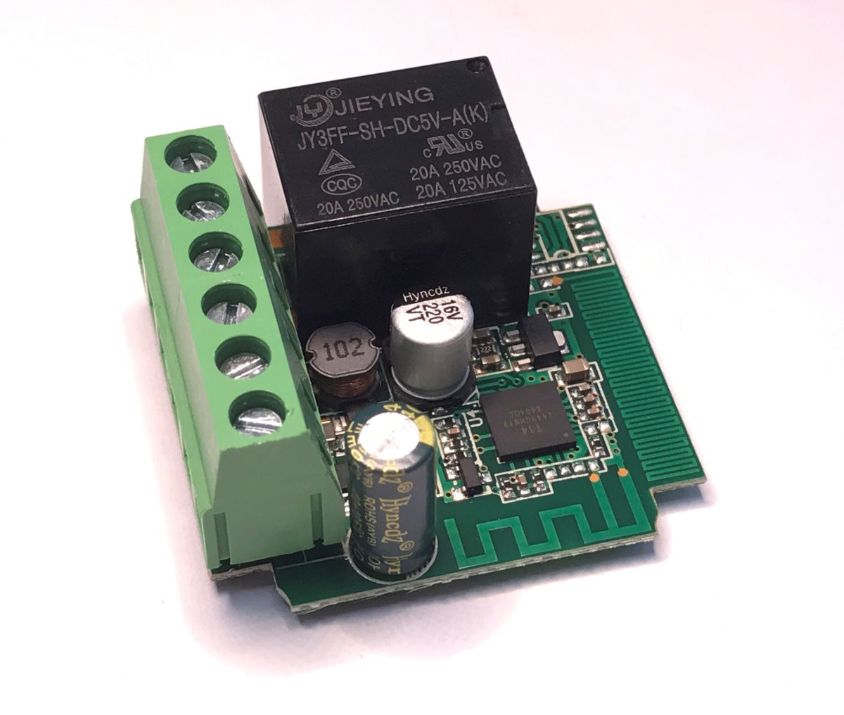

    Let's take a look inside:

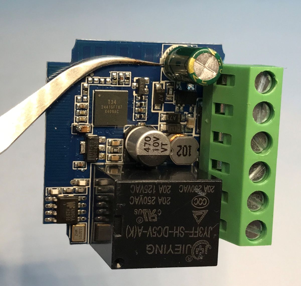

    Green PCB with visible traces, terminal block and soldered components. Remote relay module with green terminal block and black JY3FF relay Electronic circuit board with relay and screw terminal block in close-up
    Electronic module with relay, capacitors, and screw terminal Close-up of a blue PCB with electronic components and a green screw terminal Electronic module with relay, capacitors, and screw terminal block

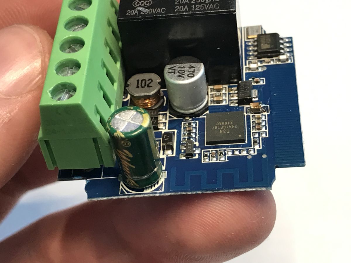

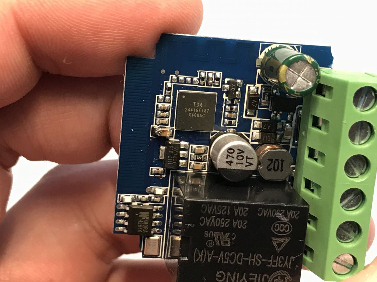

    There is no access to the pads mentioned in the subject line about T34 catalogue note .
    Close-up of T34 Wi-Fi module on PCB with capacitor and SMD components
    We'll have something on this in a moment, but the construction of such a module can still be discussed briefly.
    Here we have a single relay supplied with 5 V (JY3FF-SH-DC5V-A(K) or similar), a step-down converter providing 5 V from 230 V AC (after rectification), probably on a BP2525, an LDO AMS1117-3.3 providing 3.3 V from 5 V, and a title T34 together with an antenna on the PCB. In addition, some of these modules also support an RF control option thanks to an additional WF480RA IC in the corner of the PCB along with its quartz resonator and antenna.

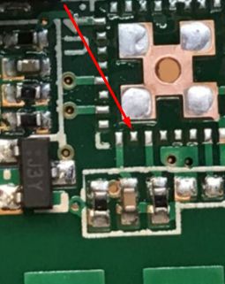

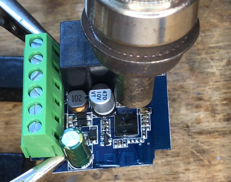

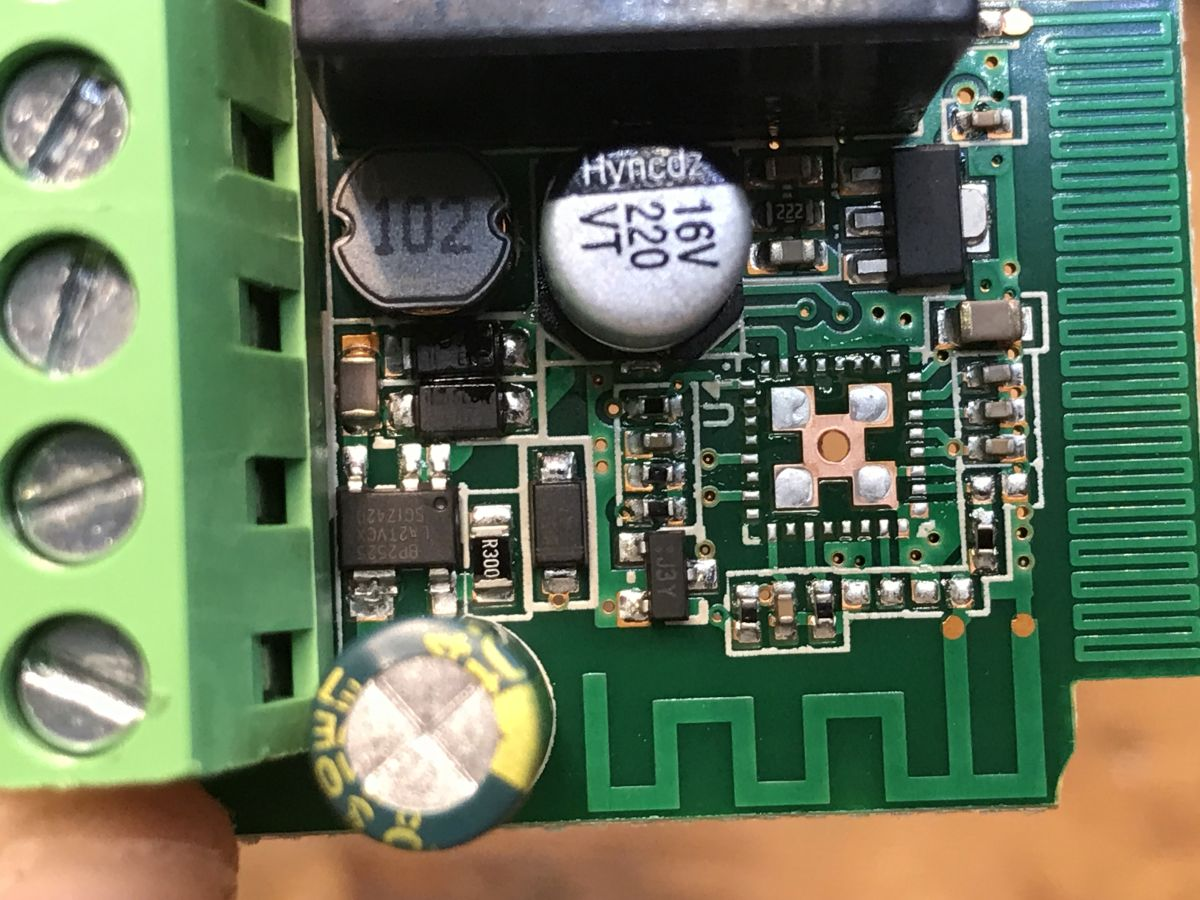

    Verification with the datalogue note shows that one of the UART pins needed for programming is not brought out here. You need to apply flux, ideally also protect nearby components with kapton tape and solder the T34 using hot air. The temperature and blow settings depend on the station - I always try to limit the blow, the temperature is not needed too high either. The board is small and has little heat capacity, it's not a big multilayer PCB from a laptop with huge copper spouts.
    Electronic module with T34 chip heated by hot air soldering station nozzle

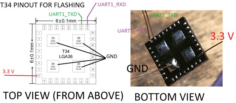

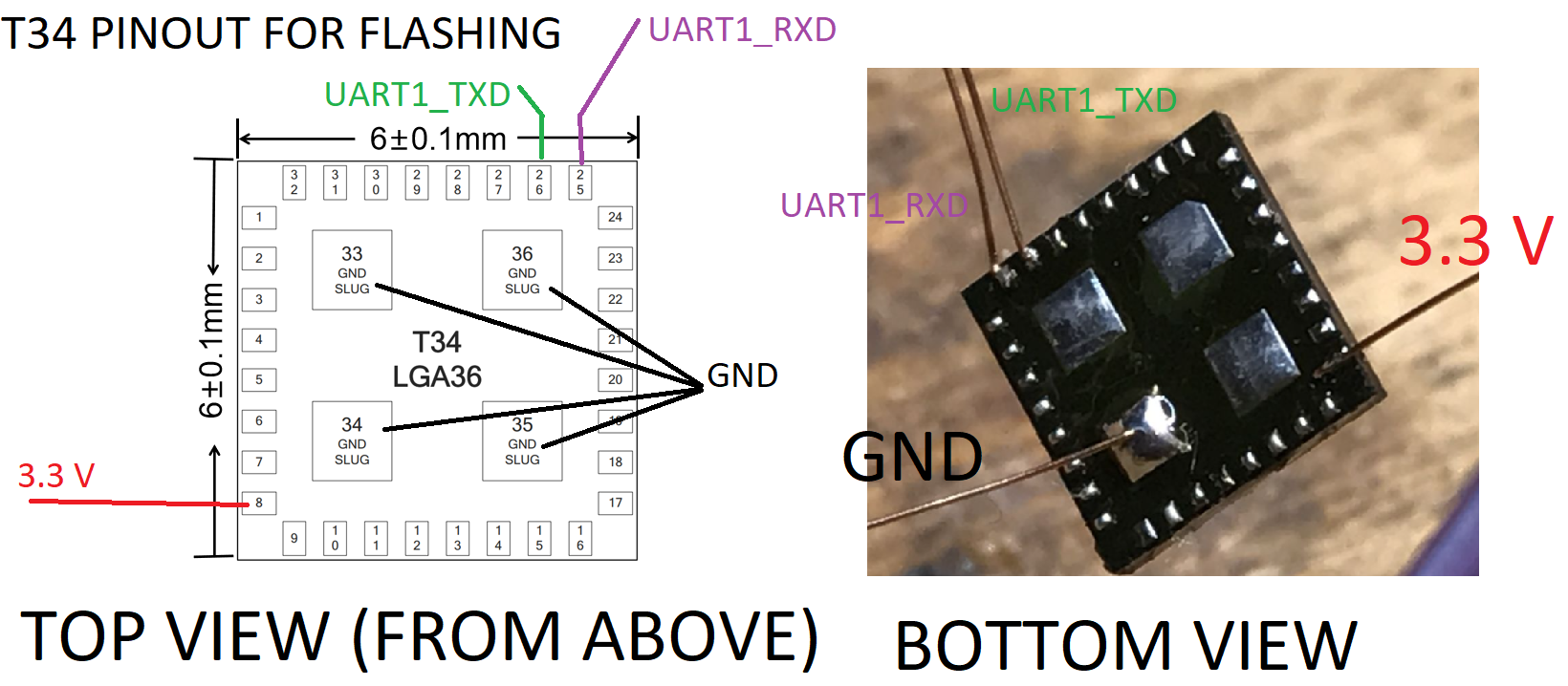

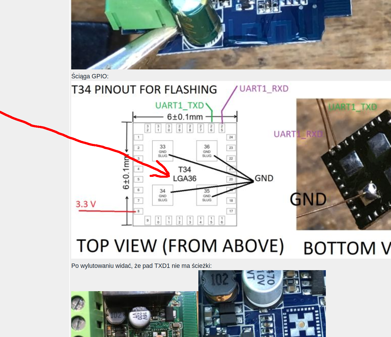

    GPIO download:
    T34 pinout diagram and photo with UART wires soldered for flashing
    After soldering, it can be seen that the TXD1 pad has no path:
    Close-up of relay PCB with desoldered T34 Wi-Fi module in LGA package Close-up of a PCB with removed LGA chip and visible QFN pads

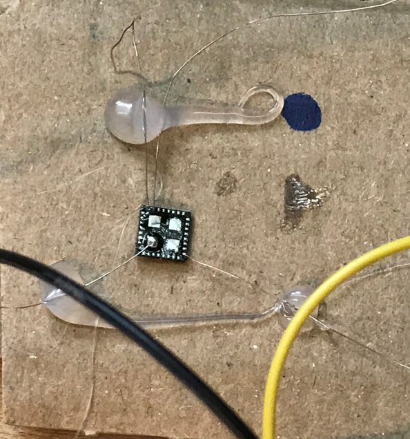

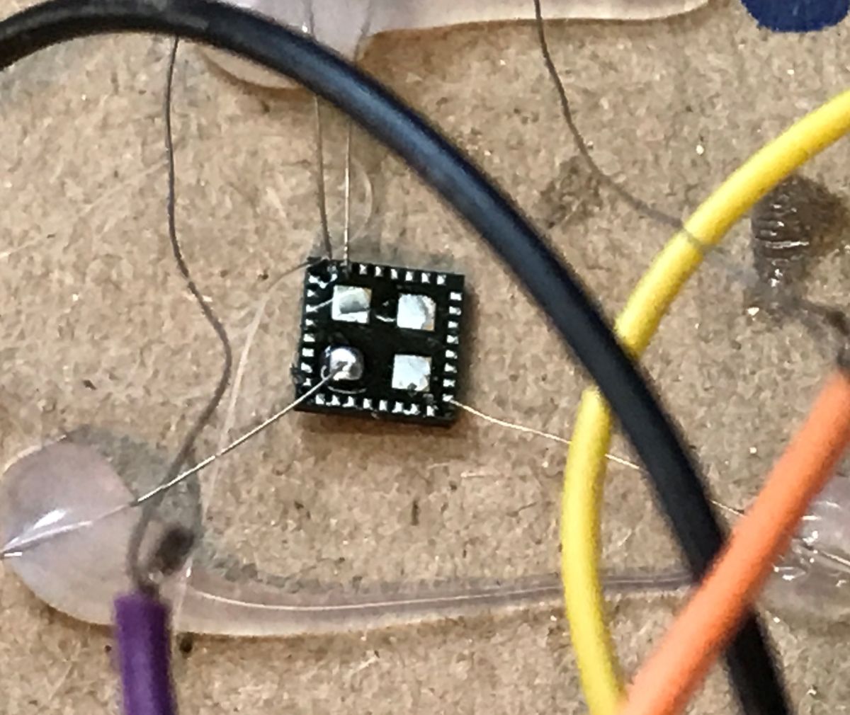

    This way we have the module soldered out. I necessarily advise against soldering thick wires to it - it is easy for it to tear off the pad, I have already been through this, I broke one circuit myself this way. It is better to make a stand, e.g. from a cardboard box, mark the first pin and then fix the wires to the stand (e.g. with hot glue) and solder to them:

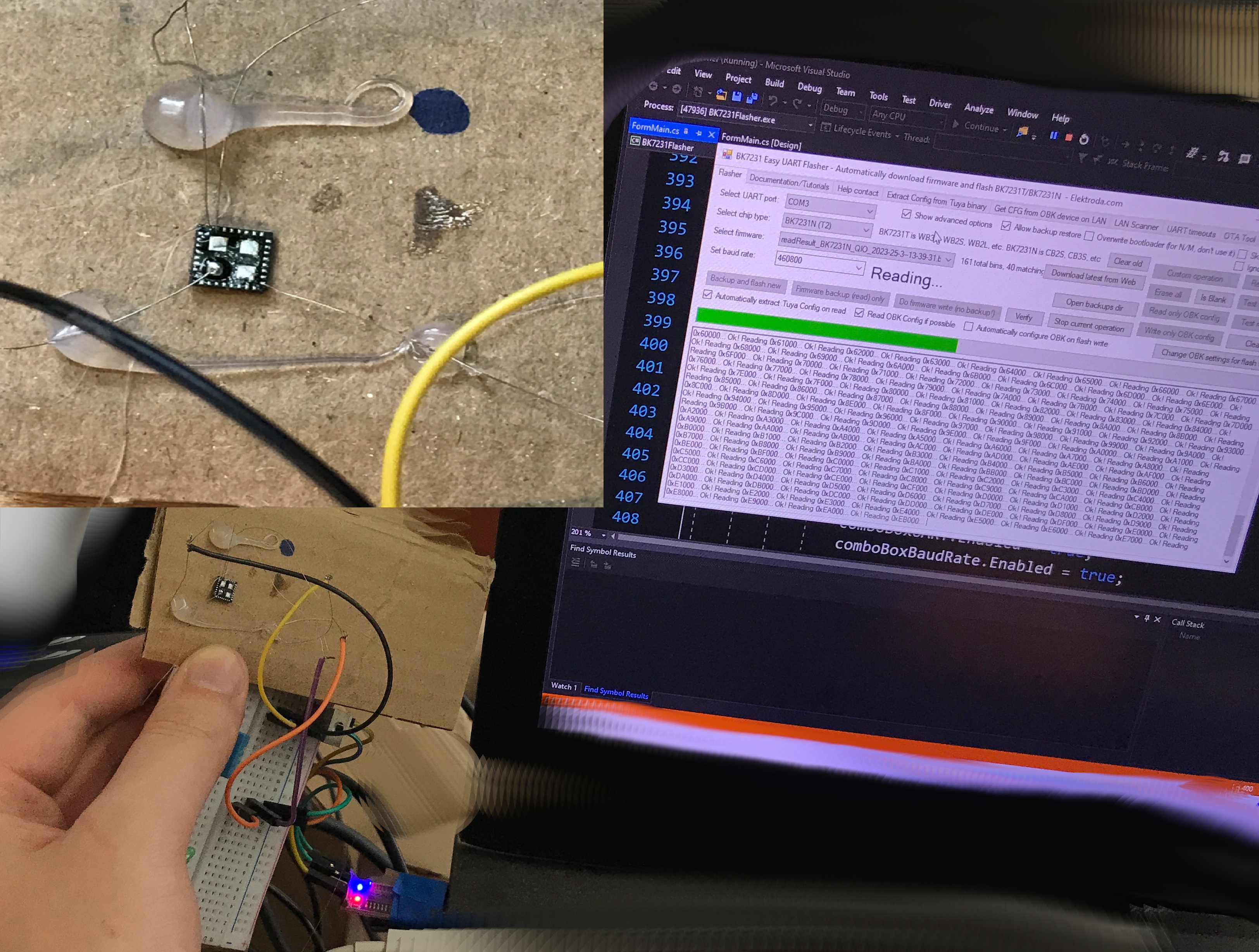

    T34 chip mounted on cardboard with thin wires soldered to its sides
    You can also buy a QFN breakout board with a compatible number of pins and raster. I didn't have one on hand myself, but my method works too - I even took a souvenir photo while reading the Flash memory:
    T34 chip on cardboard with soldered wires, flashing tool software visible on screen

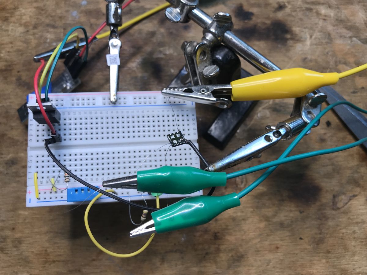

    Another copy - another risky method, but again, wires to not break the pads:
    Desoldered T34 chip connected to a breadboard with alligator clip wires

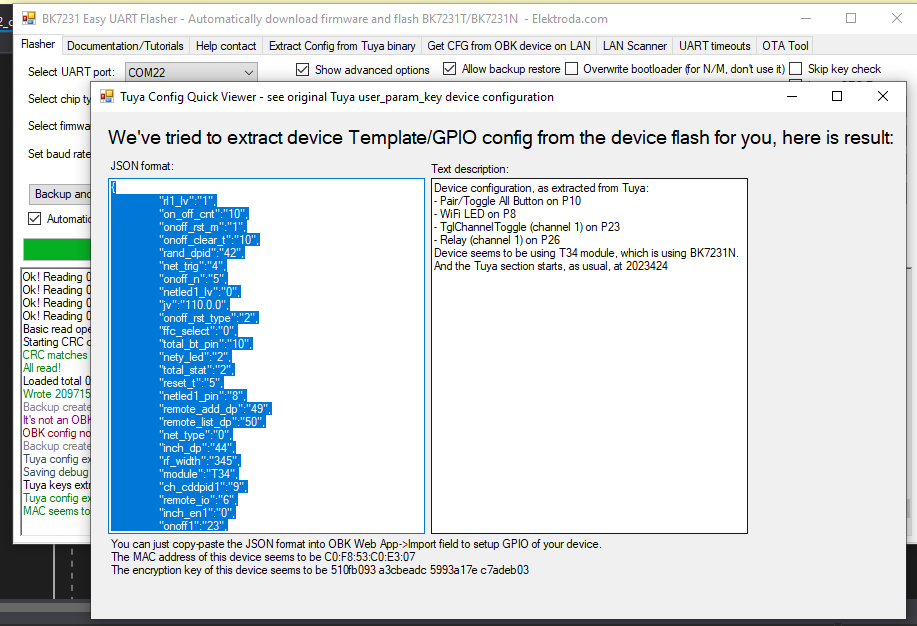

    We use our flasher and USB to UART converter for programming:
    The programmer correctly discovers the GPIO configuration:
    Screenshot of BK7231 GUI Flash Tool showing extracted T34 GPIO configuration

    Relay module with QFN-packaged T34 chip held in hand
    I do not reapply binder to such a layout. I just add a bit of flux, not too much, position it and heat it with hot air. With a bit of luck the layout sits and positions itself correctly. Sometimes it needs a little help with tweezers.
    Tuya's JSON detected (GPIO configuration):
    Verbal description:
    Device seems to be using T34 module, which is BK7231T chip.
    - Relay (channel 1) on P26
    - WiFi LED on P8
    - TglChannelToggle (channel 1) on P23
    - Pair/Toggle All Pin on P10
    We perform the rest of the configuration as usual.

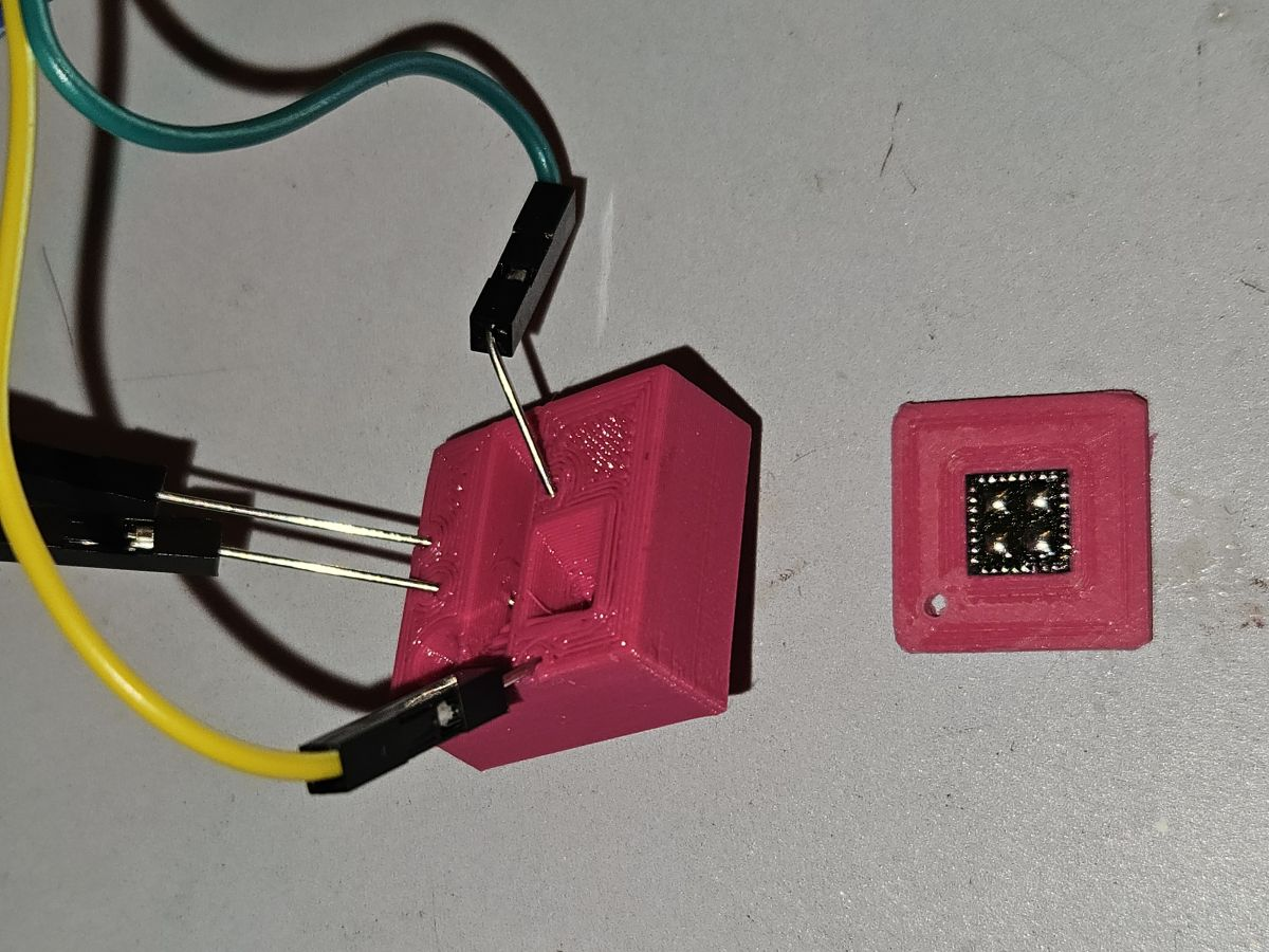

    Is there any way to make your job easier? There was one suggestion on Elektroda.com:
    Pink 3D-printed adapter with pins and desoldered QFN-package T34 chip on a surface
    This is a printed adapter for programming the T34 without soldering. It simplifies the second step, as the T34 has to be further soldered and re-soldered from the PCB. Source: https://www.elektroda.com/rtvforum/topic4079733.html#21732349
    Interesting concept, although it still requires probably the most difficult step.

  • #2 21737271
    piotr_go
    DIY electronics designer
    Posts: 2910
    Help: 94
    Rate: 3351
    LGA not QFN.

    Well, I don't know. To hook up to ground and plus you will probably find somewhere on the pcb. The question is whether the Rx and Tx go somewhere on the pcb so you can catch them, you need to look closely at the photo with the soldered circuit.
  • Missing UART line on the soldered circuit board
    #4 21737307
    Posts: 14770
    Rate: 12913

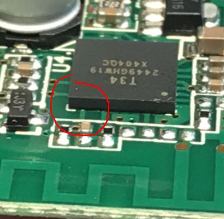

    Precisely the problem is that one of the UART lines is not led anywhere. That's why I gave pictures with the circuit soldered out:
    Close-up of QFN chip on PCB with exposed pads, one area marked with red circle. Close-up of a PCB with an LGA pad unconnected, pointed by a red arrow
    So you have 3.3 volts, you have ground, and you have one of the UART pins too - but what about the other?

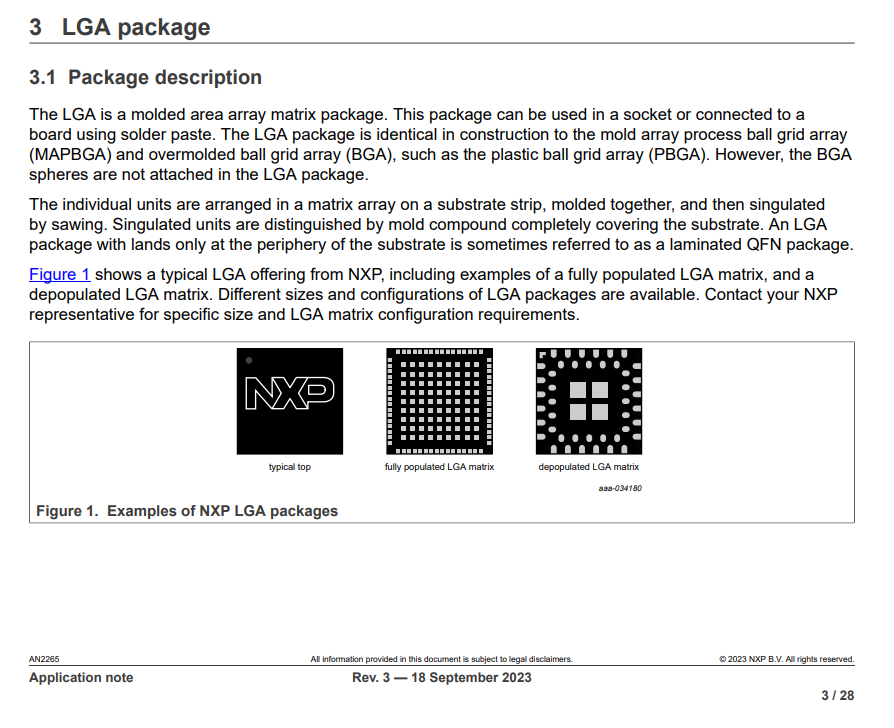

    As for the nomenclature, I'll have to check, as when I looked before publishing it didn't seem to fit me neatly with that LGA name, but I'm probably looking wrong.
    NXP documentation page showing LGA package description with three package diagrams
    "is sometimes referred to as a laminated QFN package"

    :) Darkest under the torch:
    T34 pinout diagram with TXD1, GND, and UART connections marked
  • T34 package variants and side-access pads
    #7 21737429
    Posts: 14770
    Rate: 12913
    And that's what I saw, but about that I had doubts because I know that T34s come in two versions - with pads accessible from the side and without. Although I guess that document from NXP what I gave a screenshot earlier clarified the difference for me a bit, there it says that LGA with pads only at the edges, it is also called as "laminated QFN".
    So there are at least two types of this T34 - with or without "side" access.
    @chemik_16 I'll try it at the next switch. File the side of the chip?

    LGA with pads only at the edges, is also referred to as "laminated QFN".
    "laminated QFN" - as many as 15 links on google :)
    Since you are describing a problem that occurs in an LGA chassis and does not occur in QFN, it would be appropriate to write LGA.

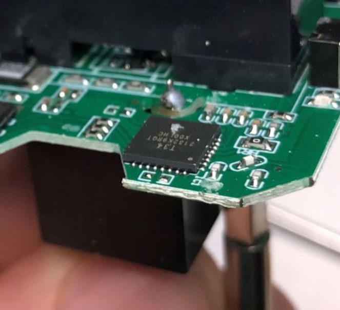

    Was there any space under the chip for even the thinnest of needles to reach the IC legs? This method was a pain and you need to keep a steady hand for a short period but I was able to flash with two sewing needles carefully positioned with this device once:
    https://www.elektroda.com/rtvforum/topic4036975-60.html#21117203
    https://www.elektroda.com/rtvforum/topic4036975-60.html#21117908
  • #12 21737848
    Posts: 14770
    Rate: 12913
    @divadiow I checked your picture.
    Close-up of an integrated circuit on a blue PCB with SMD components
    It indeed looks like LGA (no pads on right side) but it seems it's solder in such a way that solder joins are still accessible. That was not the case for me. It seems that much depends on the board designer as well.

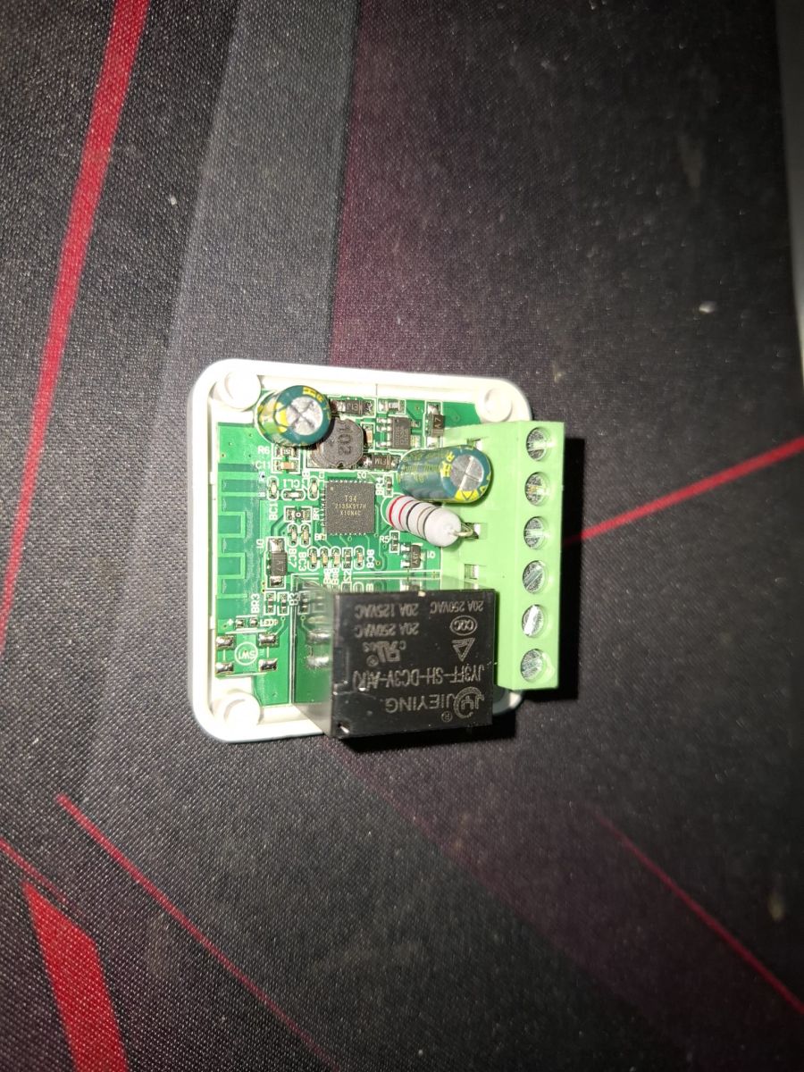

    Electromagnetic relay module with screw terminals on a PCB
    I have such a switch and am gathering up the courage.

  • Possible QFN or LGA package identification
    #17 21738061
    Posts: 14770
    Rate: 12913
    Now I'm wondering if the one in @Nargo's photo is a QFN, or is it also an LGA, but only on longer pads?
    Anyway, what's there is a simple version, also you could probably get away with such a stand with pins to embrace it.
    Or maybe there is just a UART brought out to the bottom of the PCB?
    If you succeed, @Nargo, remember that we are still collecting factory batches from the circuits (you can give on the forum as an attachment or give PR to us here: https://github.com/openshwprojects/FlashDumps ), and if our flasher detects a configuration, you can share the JSON + image and we'll add the entry to the list: https://openbekeniot.github.io/webapp/devicesList.html

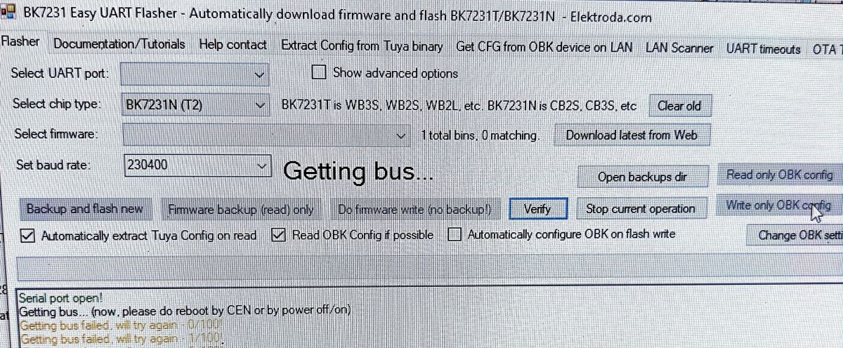

    I'm trying to flashing it, but I'm getting this error. Anyone knows why?
    BK7231 Easy UART Flasher interface showing bus connection errors
  • #21 21746796
    Posts: 14770
    Rate: 12913
    This is not an error. You need to do a quick power off and on cycle, so it can "get bus".
    See guides for BK7231 here:
    https://www.youtube.com/playlist?list=PLzbXEc2ebpH0CZDbczAXT94BuSGrd_GoM

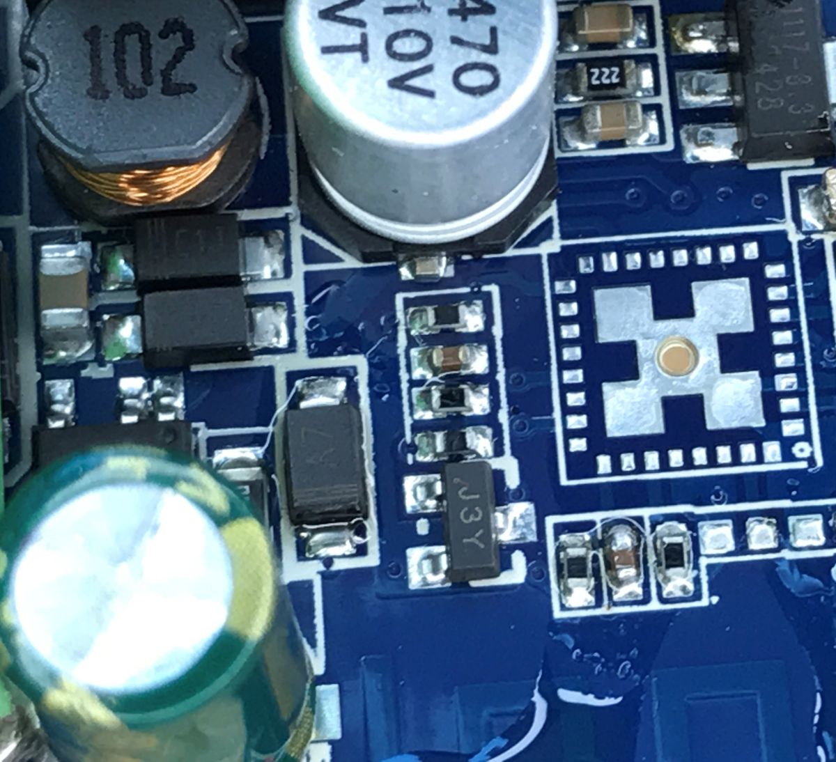

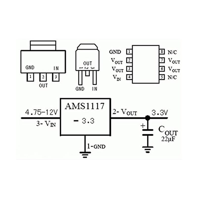

    @rchristescu see here, only one of UART signals has a pad that you can solder to:
    Close-up of a PCB with capacitors, an inductor, and screw terminals
    For VDD and GND, see LDO pinout:
    AMS1117-3.3 voltage regulator schematic and package layout
    Interestingly enough, you can either choose 3.3V and solder to output of LDO, or you can use 5V and solder it to input of LDO, so there is still a safe 3.3V at the output. Just don't confuse pins! 5V may damage Beken.
    @Atgeek25 as in the first post - T34 is BK7231N . BK7231T is a different kind of Beken. If that's what you mean...

What is the T34 module and why is flashing harder now?
T34 is a compact Wi‑Fi module based on the BK7231T/N core. Many new relay boards place T34 in an LGA package with no accessible side pads. One UART line is often unrouted on the PCB, blocking in‑circuit serial flashing. Initial reprogramming typically requires hot‑air removal, wiring, then reflowing the chip. “Access to the pads is not available!” [Elektroda, p.kaczmarek2, post #21737021]
Is my module LGA or QFN, and does it matter?
It matters. In QFN you may catch the side pads; in LGA the metal lands sit underneath, often with no side access. The thread corrects the naming: these problematic versions are LGA, sometimes described as “laminated QFN.” Expect harder access and plan for chip lift. [Elektroda, piotr_go, post #21737271]
Can I find 3.3 V, GND, RX, and TX somewhere else on the board?
You can locate 3.3 V and GND easily. However, at least one UART pin (TXD1) is not routed on certain boards. Photos show no trace for that pad, so you cannot complete the UART without accessing the package lands directly. [Elektroda, p.kaczmarek2, post #21737307]
How do I flash OpenBeken onto a T34 safely?
Three steps: 1) Hot‑air lift the T34 after masking nearby parts and applying flux. 2) Solder thin leads or use a breakout/fixture; connect USB‑UART and use BK7231 GUI Flash Tool. 3) Reflow the T34 back, align with flux. Avoid thick wires to prevent pad lift. [Elektroda, p.kaczmarek2, post #21737021]
What tools and files do I need to program it?
Use a USB‑to‑UART adapter and the BK7231 GUI Flash Tool. Flash the OpenBeken binary for BK7231T. The tool can auto‑discover GPIO configuration, and the project repository provides firmware and device lists for reference. [Elektroda, p.kaczmarek2, post #21737021]

Sometimes. If solder joints are slightly exposed around the chip, two fine sewing needles or a printed press‑adapter can touch the UART lands. Success varies by pad length and board design. “The accessibility of the legs on these T34s do seem to vary.” [Elektroda, divadiow, post #21737850]
Is grinding a corner of the package a valid access method?
Yes, carefully filing only the corner with the target pin can create permanent access without full removal. Several users suggest this to expose a single UART pad, reducing future rework. Proceed slowly to avoid damaging internal layers. [Elektroda, Mastertech, post #21737477]
What’s the risk of ripping pads during wiring?
High if you use stiff or heavy wires. The author reports breaking a circuit this way. Secure the module in a small stand, hot‑glue strain‑relieved jumpers, or use a QFN/LGA breakout to protect pads during flashing. [Elektroda, p.kaczmarek2, post #21737021]
How do I configure GPIOs after flashing?
Use the detected Tuya JSON or manual mapping: Relay on P26, Wi‑Fi LED on P8, Toggle on P23, Pair/All on P10. Confirm behavior in OpenBeken, then pair with Home Assistant. A video walkthrough is linked in the thread. [Elektroda, p.kaczmarek2, post #21737021]

Edge case: what if my board has UART broken out underneath?
Check for test pads on the PCB bottom. Some versions route UART to hidden pads, enabling flashing without chip removal. If absent, use lift, corner‑file, or a press‑adapter approach. [Elektroda, p.kaczmarek2, post #21738061]
What if the chip sits mid‑PCB with no side access?
It’s harder but still possible. Add fine cables without full removal if any metal is exposed, or use a printed programming adapter to press contacts. Placement increases difficulty, not impossibility. [Elektroda, Mastertech, post #21738014]
