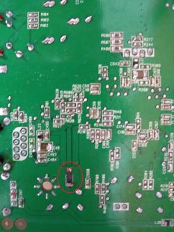

    Is it possible to fire ubot still from another address? For example, A17, or A18? Do they have to be uploaded there during the conversion?
    Could someone please mark in the following picture where A18, A19 and A20 are located?

  • #12 17639446
    rtomek
    Level 19  
    Posts: 358
    Help: 26
    Rate: 60
    The picture below from the subject [url=]https://www.elektroda.pl/rtvforum/topic2748290.html[/url]
    Section of a circuit board with labeled address lines A15-A20.
    If there are programmed bypasses in the M28W320FST memory of type NOR then they can be started by applying a high state >1.9V to a single address line or to several lines, e.g.:
    A20 runs a bypass from address A0200000
    A19 ----------------------------------A0100000
    A18 A0080000
    A17 A0040000
    A20+ A19 A0300000
    It is possible that a bypass at address A0300000 survived, so I would additionally supply 3.3V from the disk connector to the second line of A20.To the board you need to have a cable connected to the debug connector or connected display then you will see if the uboot is there.

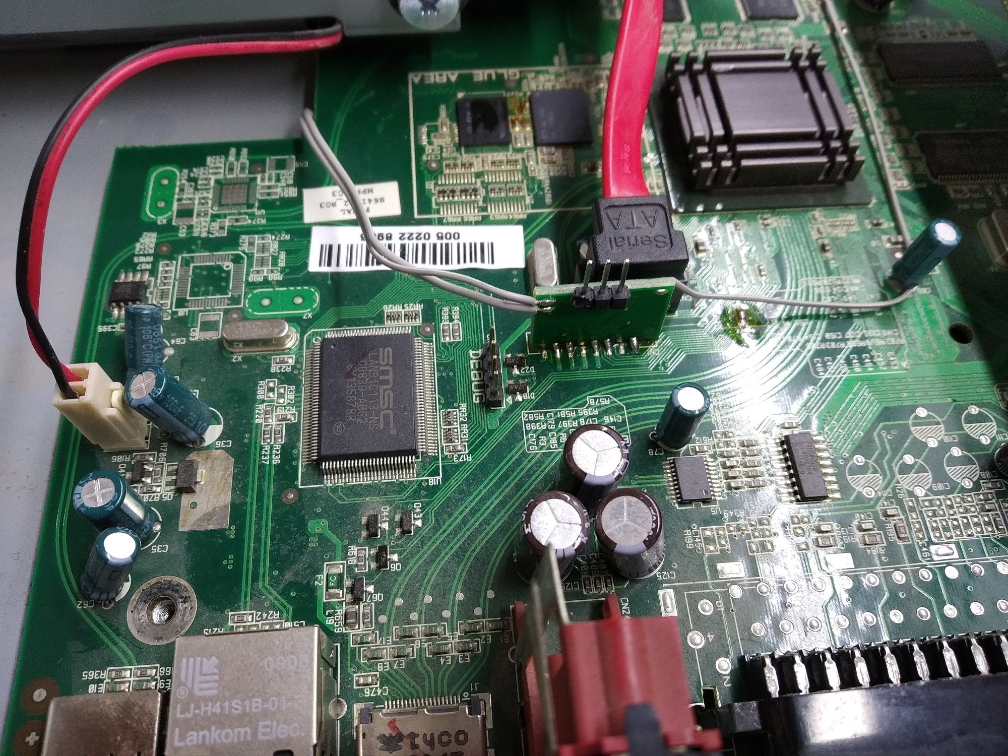

    In that case, since I have the modchip and brought out A19 and A20 on the jumper it is enough to short all 3 pins with each other. Am I right
    I shorted A19+A20, but it looks like there is nothing there, because immediately TEST turned on. The same with A16.

    If you connect two points A20 and A19, the voltage will be too small for the processor to read this as high state H.I wrote that you have to connect the second line, that is, give a jumper-cable between +3.3V from the disk connector and point A20 . Point A19 you have already connected to 3.3V of the debug connector and there is about 1.9V or state H.Voltage to the debug connector is given by three resistors 100 Ohm connected in parallel and therefore the voltage drops when we connect more current consumers - in this case, these are the address lines .
  • #15 17641085
    Zelu00
    Posts: 327
    Help: 7
    Rate: 68
    In my case, 3.3V is not taken from DEBUG (taken from the transistor near the HDD power supply). It looks like the following pictures.
    On the modchip pins I have in sequence (counting from the DEBUG side):
    1 - A20
    2 - 3.3V
    3 - A19
    With the jumper disconnected I have pin 1 = 0V, pin 2 = 3.3V, pin 3 = 3.3V. Is this how it should be?

    To check if there is a bypass at address A0300000 then:
    1.Unplug the RESET cable from the first photo
    2.From the modchip board, unsolder both cables A20 and A19 and solder to 3.3V - drive power
    If it displays a bypass then you can continue to upload the other bypasses, and if not then replace the NOR memory (this is the one closer to the processor and the other is the NAND memory)
    Programmed memory can be purchased, for example, on Allegro.

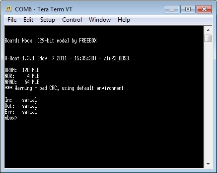

    After shorting A19+A20, I hooked up to DEBUG this time and got this info.
    Any tips on what to do next?
    Nbox BZZB 5800sx Decoder: Startup Failures, Uboot Issues and Debug Connector Flashing .

  • #23 17671143
    Zelu00
    Posts: 327
    Help: 7
    Rate: 68
    Thanks a lot! Tuner works from under A20.
    However, after uploading u-boot under A19 only nbox text appears.
    Debug shows:
    U-Boot 1.3.1 (Sep 21 2014 - 19:22:00) - stm23_0053
    DRAM: 128 MiB
    NOR: 4 MiB
    NAND: 64 MiB
    *** Warning - bad CRC, using default environment
    In: serial
    Out: serial
    Err: serial
    nbox>
    I understand that I should upload env yet? Just how?
