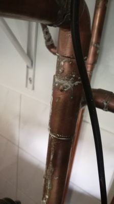

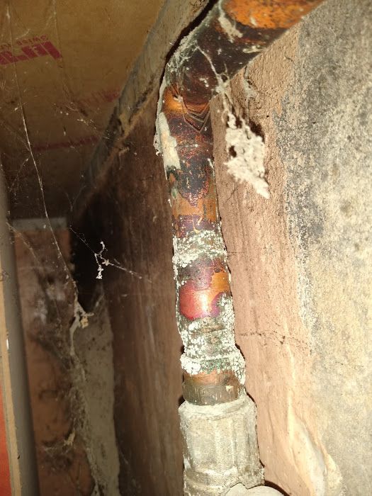

    I have deposits on the pipes as in the attached photo, tell me what this may be caused by? It was created some time after the boiler was in operation. Is it normal? What Causes Sediment Deposits on Copper Pipes in a Central Heating System? What Causes Sediment Deposits on Copper Pipes in a Central Heating System?
  • #2 17639399
    viayner
    Posts: 10638
    Help: 1563
    Rate: 2052
    There may be several sources, for example:
    - water codensation, in a slightly alkaline/acidic environment and you have corrosion products
    - leaks of water containing a lot of carbonates (hard water), evaporation of water and crystallization of carbonates.
    - if you have contact of different metals, you have "electrochemical" products, a cell is created.
    Regards

    it looks like surface deposits, I don`t know what your environment is? brazed pipes - how are they connected? Warm water accelerates corrosion processes, although copper is a metal on the "precious" side, corrosion occurs, it`s all a matter of conditions.
    Can you determine the source of the problem? leak, thin stream or rather condensation?

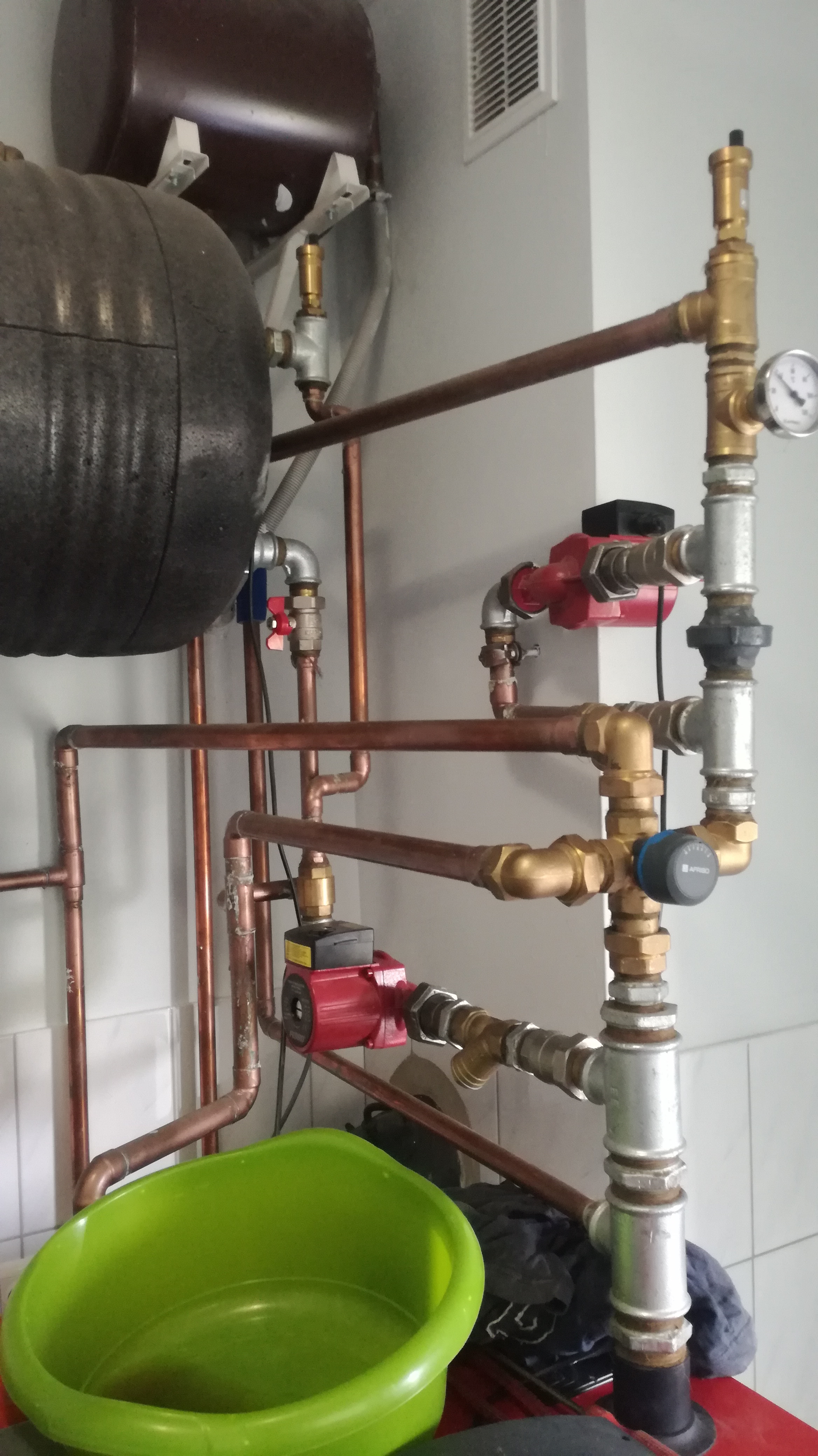

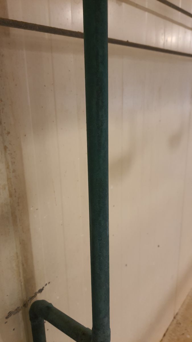

    There are no leaks. The environment is as in the second photo, i.e. just an ordinary home boiler room, about 6 m2

    In my opinion this is the norm. copper reacts vigorously. these deposits should be easy to remove.

    Such deposits are the result of the sloppiness of the installer who did not want to clean the tubes after soldering to remove any solder paste remnants. Solder paste contains acids and powdered tin.

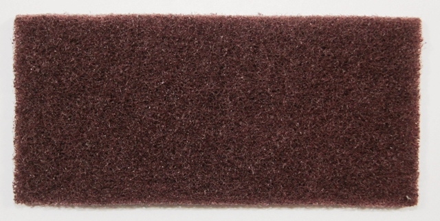

    That`s why it`s always worth having a damp microfiber and ALWAYS wipe the place after soldering. You can then paint with copper spray.
    Buy yourself a copper pipe cleaner and clean these places.

    it looks like surface deposits, I don`t know what your environment is? brazed pipes - how are they connected? Warm water accelerates corrosion processes, although copper is a metal on the "precious" side, corrosion does occur, it`s all a matter of conditions.
    Yes, copper is rather resistant to corrosion, but slightly less than brass (an alloy of copper and zinc), in which the addition of zinc increases the resistance to oxidation.

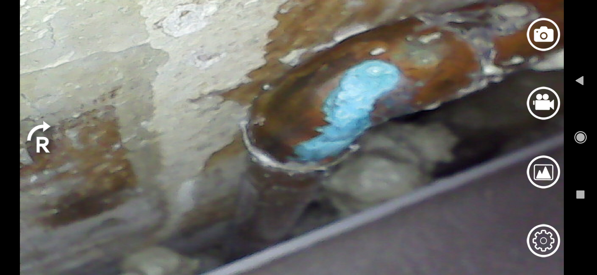

    And today, using an inspection camera behind the bathtub, I saw something blue on the radiator pipe. It looks like a piece of mortar that has turned blue, is this normal?

    this is malachite, a basic copper carbonate, formed as a result of the corrosion of copper in an alkaline environment, a completely normal and surface phenomenon, compare, for example, the roofs of churches covered with copper. The color may be between green and blue, depending on corrosion conditions

    olekolo
    Posts: 13
    Rate: 9
    Thank you for your answer. So it won't eat through my knee :)
    I know that a greenish coating is normal. I was surprised by the blue one. The backlight may be a bit misleading, but the blue one surprised me. And I'm a bit oversensitive because in my previous apartment everything was made of indestructible copper and it washed out my elbow

    it all depends on whether the "environment" in which this element works is acidic or alkaline, more or less humid, etc. it is still the same substance but with a slightly different relative composition.

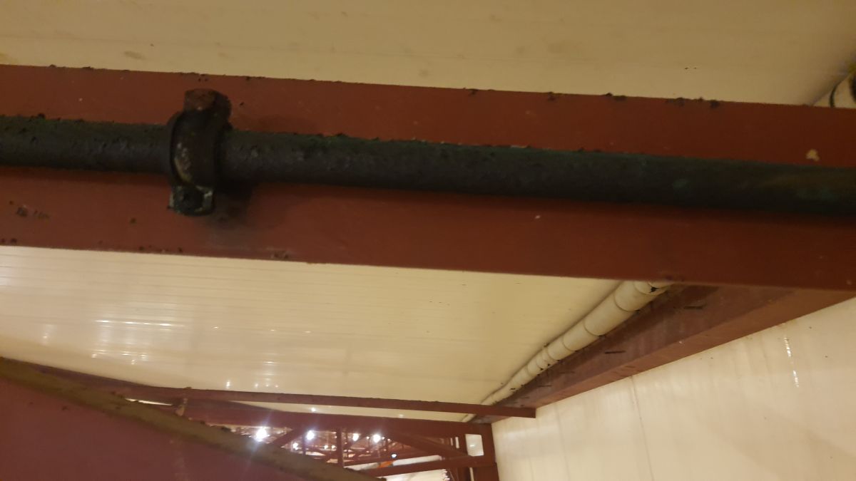

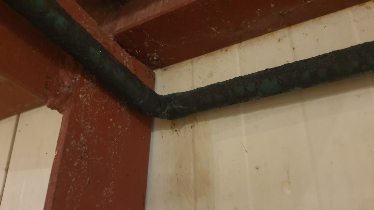

    I will join the thread with my problem.
    Basically, after reading this, I know more or less what and how.
    I have a copper gas installation in the hen houses. Chicken manure itself contains a lot of nitrogen and ammonia.
    In addition, when cleaning, I use ammonia, sodium hypochlorite, lime and many other substances.
    Is it possible to check whether it is a surface sediment or whether it has gone deeper?
    The closer to the ridge, the worse, but that`s where the moisture comes in.
    In the worst places it fades to black.
    Regards
