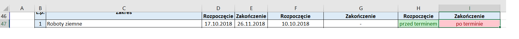

    I have such a problem - I need to compare the dates, namely I want to verify that the start date is consistent with the scheduled date. I want him to return the results: before the deadline, on time, after the deadline, and in addition, if he does not indicate the start date of the task, he verifies whether or not the date is required in relation to today's date. While there is no problem with the first part of the task, the comparison with today's (set) date is a problem. Excel goes crazy when the column it compares to is empty ...
    Excel Date Comparison: Verify Start & Deadline Dates, Return Results Based on Today's Date
    = IF (E47> G47; "before due date"; IF (E47 = G47; "on time"; "late"))
    = IF (D48> F48; "before due date"; IF (D48 = F48; "on time"; IF (F48 = "-"; "ATTENTION !!!"; IF (D48 F51; "before due date"; IF (D51 = F51; "on time"; IF (D51

    Your formula does not take into account whether the due date has been exceeded. My point is that it should also return this information within one cell.
    In summary, I am interested in:
    1. is it ahead of schedule
    2. is it on time
    3. is it late
    4. if no start date is given, whether or not a start is required due to a reference date (eg today).

    Unfortunately, still not what I mean. Now, if there is no due date, shows NOT GIVEN, the point was to verify whether it is before or after the date for example today.
    For early start, it shows "not required" and should "ahead of schedule".
    Perhaps it cannot be done within one formula and you have to break it down into 2 columns ...

Yes. Example (Start=D2, Due=F2, Ref=G2): =IF(ISBLANK(F2),"Schedule missing",IF(ISBLANK(D2),IF(IF(ISBLANK(G2),TODAY(),G2)<F2,"Not required yet","Start required"),IF(D2<F2,"Ahead of schedule",IF(D2=F2,"On time","Late")))). It checks due date, then whether start is blank, then compares dates. Replace cell refs as needed. [“IF function”]
