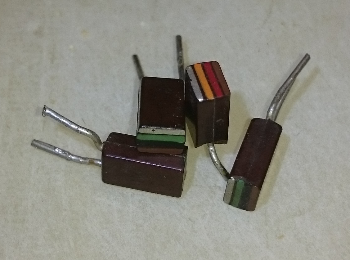

  • #33 17680096
    Rafikusa
    Posts: 179
    Help: 27
    Rate: 66
    Let me show you a device I desoldered a long time ago.
    As far as I`ve noticed, these haven`t been mentioned yet, so I`m showing them as a curiosity.
    It looked nice back then when several were soldered next to each other.
    Does Resistor Orientation Matter in Soldering Due to Color Bands?
