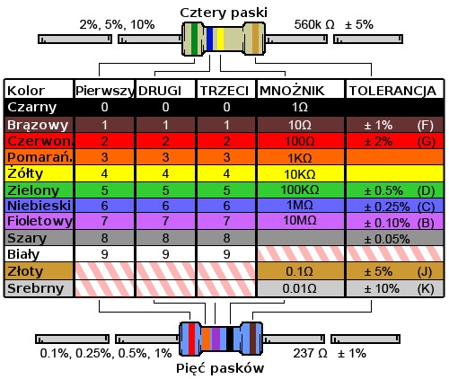

    I understand that it makes no difference which side the resistor is soldered in, e.g. https://www.google.com/search?q=rezystor&clie...CpwQ_AUIDigB&biw=1280&bih=888#imgrc=81klBoOys wDn7M:
    There are four colors, I understand that it doesn`t matter which side I solder - brown or gold?
    I understand that the colors mean the power of the resistor and nothing else?
    Of course, I mean a resistor with two legs.

    You can solder the resistor in any direction.
  • #3 17650062
    sosarek
    Posts: 83875
    Help: 9318
    Rate: 15497
    I dare say that it doesn`t matter which side and not the power but the resistance.
    NO. Resistor resistances.
    Does Resistor Orientation Matter in Soldering Due to Color Bands?
    Which side you solder doesn`t matter.

What do the colour bands on a resistor actually indicate?
The bands encode resistance value and tolerance, not power rating; size sets power rating [Elektroda, zybex, post #17650269]

How do I read a 4-band colour code?
  1. First band = first digit. 2. Second band = second digit. 3. Third band = multiplier (10^n). 4. Fourth band = tolerance (e.g., gold ±5 %) [IEC 60062].
