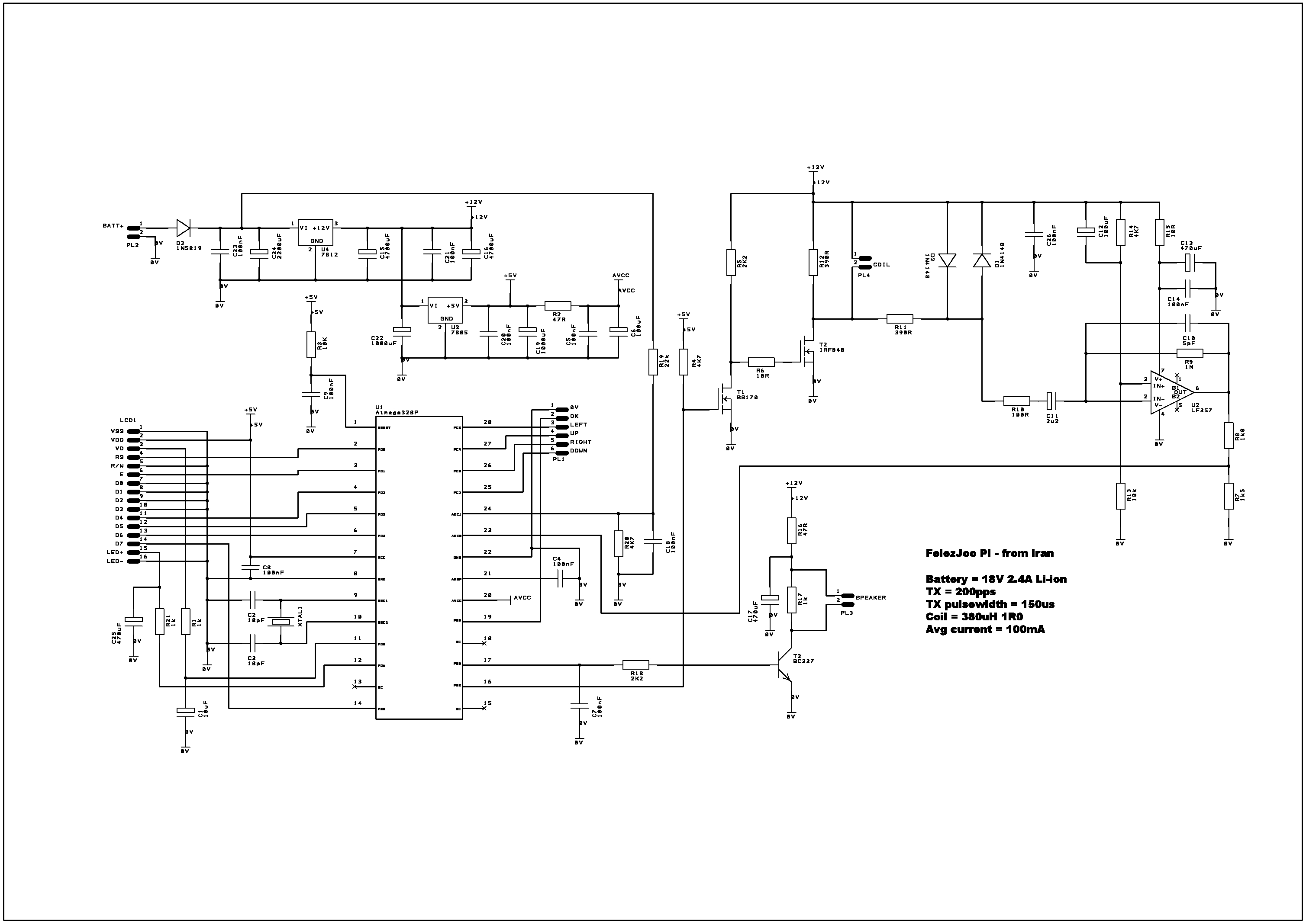

    If you want something new, I recommend the Felezjoo.pi detector DIY Pulse Metal Detector Projects: AVT 5196, JABEL 267/297, or Newer Designs? DIY PCB & Assembly
    I have had one of the most advanced impulse detectors for quite some time. It has a lot of settings, especially iron discrimination. The construction is a bit problematic but still manageable.
  • #7 17689914
    Krzys55
    Level 28  
    Posts: 1146
    Help: 89
    Rate: 303
    You can give some specific pointers to this detector, because as far as I know, no discrimination can be obtained in impulse detectors. Someone once proposed pseudo-discrimination, but somehow it didn't work. In general, from the way the PI detector works, this is impossible.

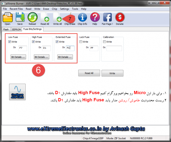

    Unless you have HEX without a counter :D The detector is difficult to calibrate. You have to carefully select the parameters of the LF357 amplifier and sometimes you need to buy even a dozen or so pieces to choose the right one. But there are ways too :) The detector itself requires quite a lot of experience with the PI system, but once you get to know it, it can amaze you.

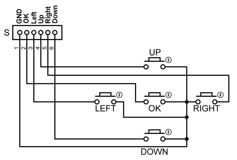

    I have all the materials but in English. I will. Hex will unfortunately be limited to 300 actuations. In this case, it can be called discrimination because iron can be omitted in the way I wrote above. It's just a bit different than in the VLFs.

    • DIY Pulse Metal Detector Projects: AVT 5196, JABEL 267/297, or Newer Designs? DIY PCB & Assembly fuse.jpg (106.8 KB) You must be logged in to download this attachment.
    • DIY Pulse Metal Detector Projects: AVT 5196, JABEL 267/297, or Newer Designs? DIY PCB & Assembly FelezJoo-PI-Schematic.jpg (439.24 KB) You must be logged in to download this attachment.
    • FelezJoo-PI - Schematic.pdf (138.63 KB) You must be logged in to download this attachment.
    • FelezJoo_PI_v3_35.hex (58.13 KB) You must be logged in to download this attachment.
    • felezjoo pi - part list.pdf (395.07 KB) You must be logged in to download this attachment.

    You're welcome. You will probably fire the detector 200 times during the launch :) I propose to bring out the kanda socket, you will be able to upload soft without removing the prock.
