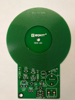

    Let's start with the technical parameters:
    1. The supply voltage is from 3VDC to 5VDC.
    2. Power is supplied to the ARK connector. The polarity is described on the PCB.
    3. The device consumes approx. 40mA during operation and approx. 5mA in standby mode.
    4. The declared "range" is 60mm.
    5. Detection of a ferromagnetic object is signaled by a LED diode (it lights up) and a buzzer squeaking.
    The whole system consists of literally a dozen or so elements, the most important of which is the PCB, which is also a double coil and acts as a probe.
    Apart from the plate, we also have:
    - two 0.022uF ceramic capacitors (C2, C3).
    - two S9012 transistors (Q2, Q3).
    - two 0.1uF ceramic capacitors (C1, C4).
    - 470Ohm resistor (R3).
    - 2kOhm resistor (R2).
    - 200kOhm resistor (R1).
    - 100Ohm mounting potentiometer (VR1).
    - 100uF electrolytic capacitor (C5).
    - a red 5mm LED (LED1).
    - S9018 transistor (Q1).
    - 6mm x 5mm bistable power switch (SW1).
    - 12mm diameter buzzer (SP1).
    - two-pin ARK power socket (J1).

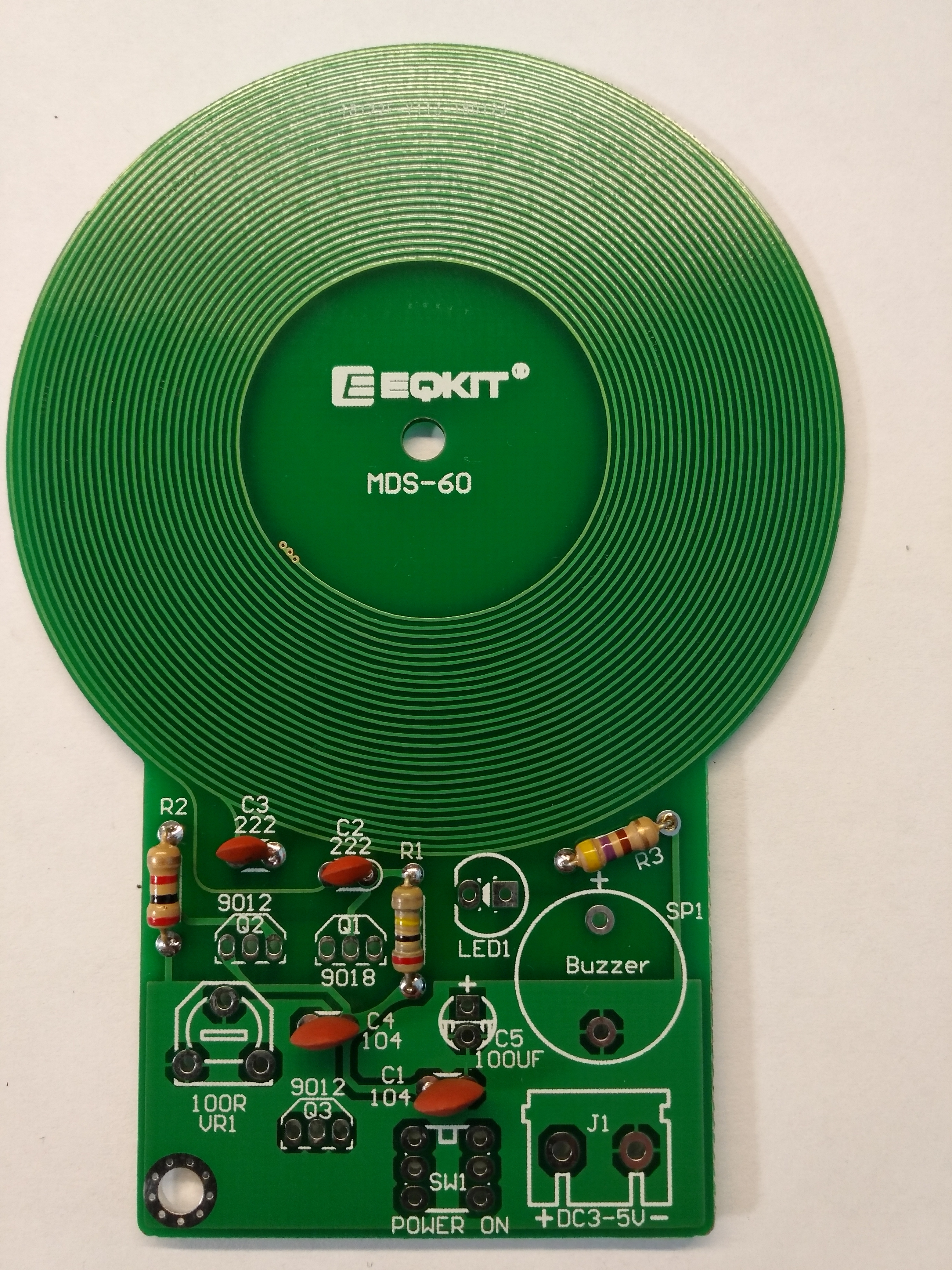

    Time for some assembly photos. As usual, we start with soldering the lowest elements.
    Self-assembly metal mini detector. Made in China. Description, Review. Self-assembly metal mini detector. Made in China. Description, Review. Self-assembly metal mini detector. Made in China. Description, Review.
    The assembly of the system is very easy. All components are clearly and legibly labeled on the PCB.
    After assembly and commissioning, I immediately say that it is only a gadget.
    Below is a video of the operation of the device:
    I adjusted the system as much as possible. Another brush of the adjustment potentiometer makes the system catch everything possible from the air. Hence, it squeaks endlessly.
    In my humble opinion, this chip can only work as an interesting gadget for very beginners and very young future electronics. I quietly hoped that the toto would be useful for detecting wires in the walls, when trying to "hang a picture", but if at 1.5cm - 3cmplaster this gadget is doing better or worse, in the case of plasterboard (where the wires are often a few inches below the surface) it is much worse.
    In a word, it is a toy that primarily has educational value.

    In general, such a mini detector is a nice "gadget". It is a pity that the range is 6 cm, but what more to expect.

    I am disappointed. It just looks like a DIY kit for schoolchildren to experiment a bit. It can be used to detect the type of material or conductors in regular walls. I don't know why people buy it in such quantities, it's not worth it, unless you want to practice soldering.
    But since metal detectors are quite popular among users (I did not expect it, all in all), let me order much more expensive for testing :)
