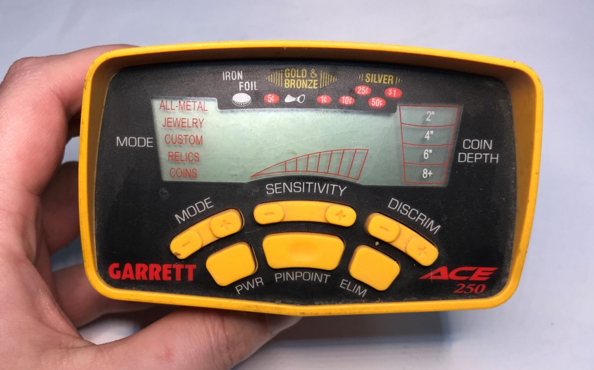

  • Control panel of Garrett Ace 250 metal detector. .

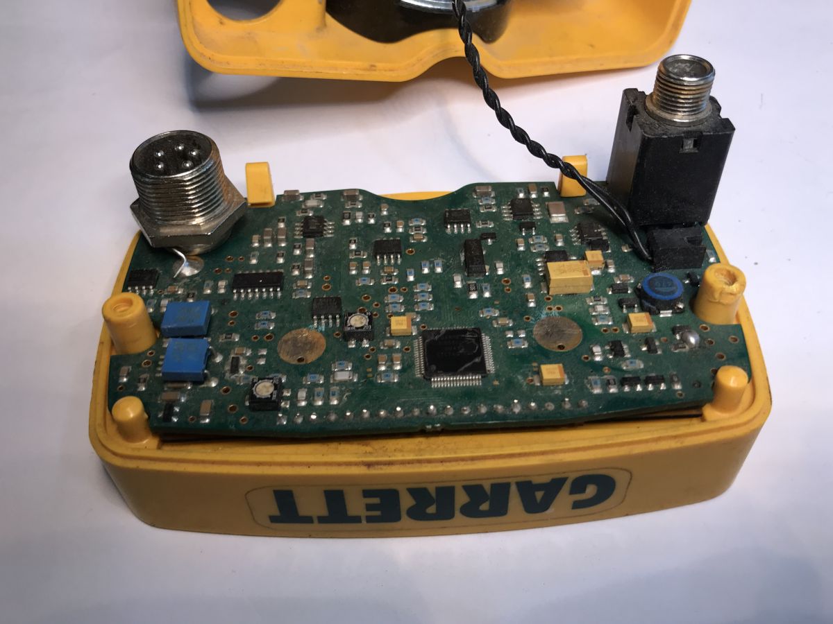

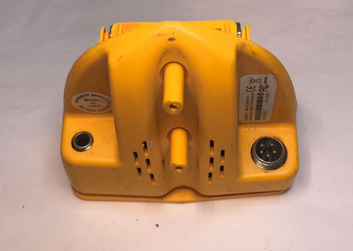

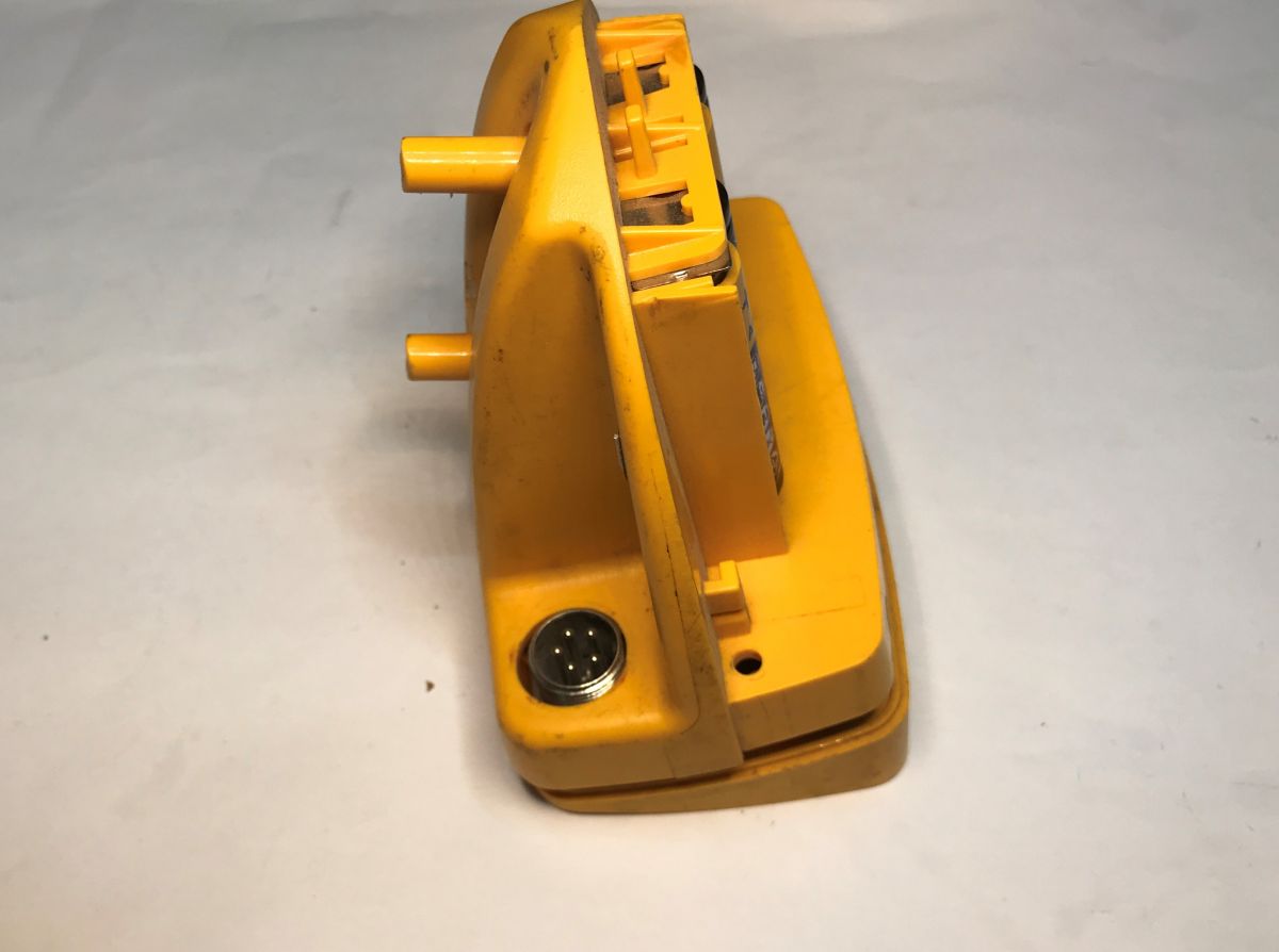

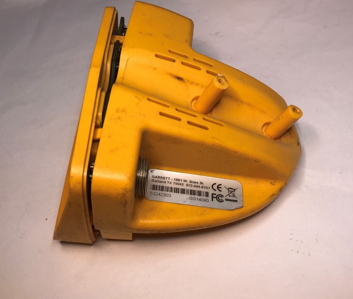

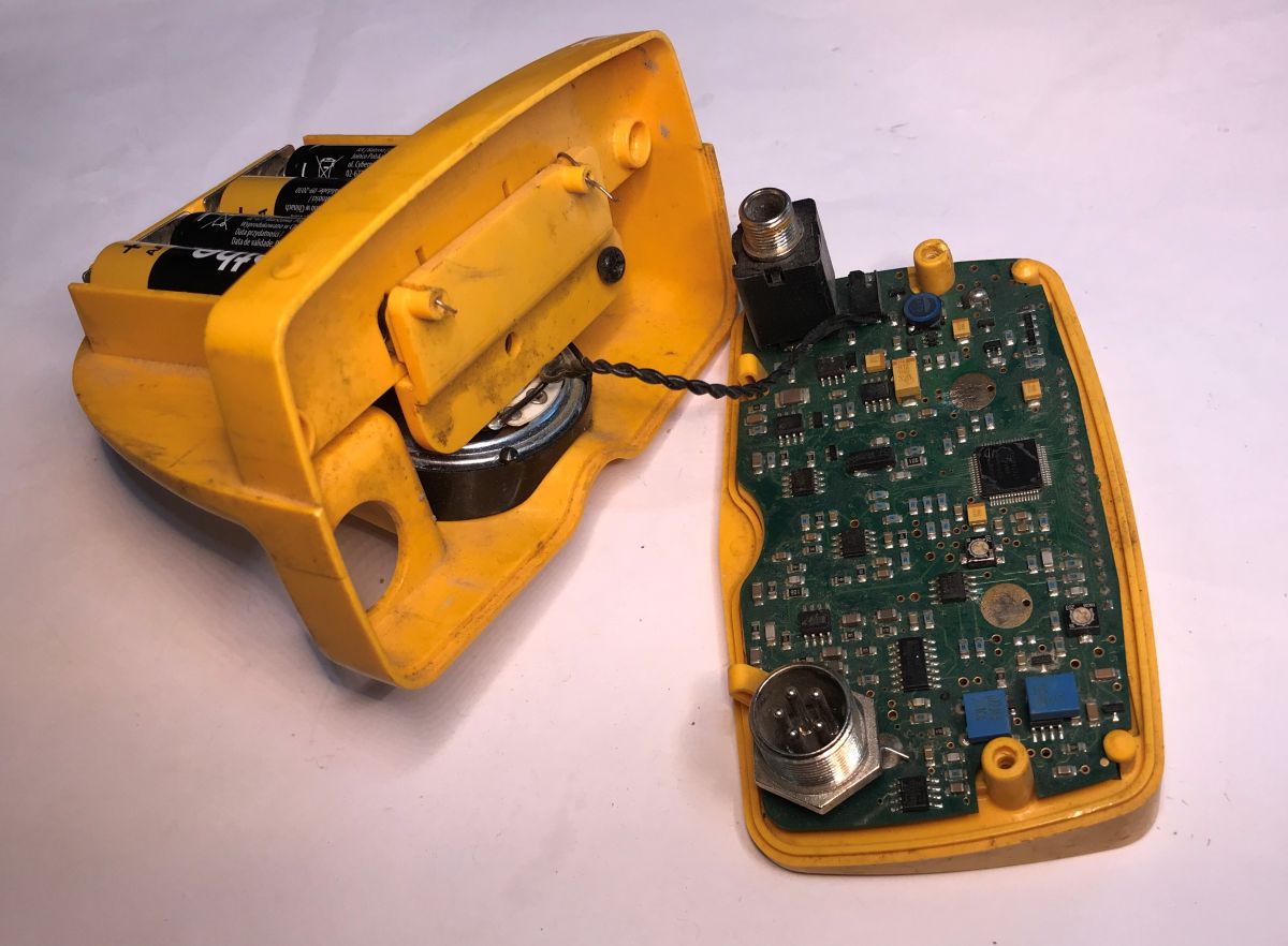

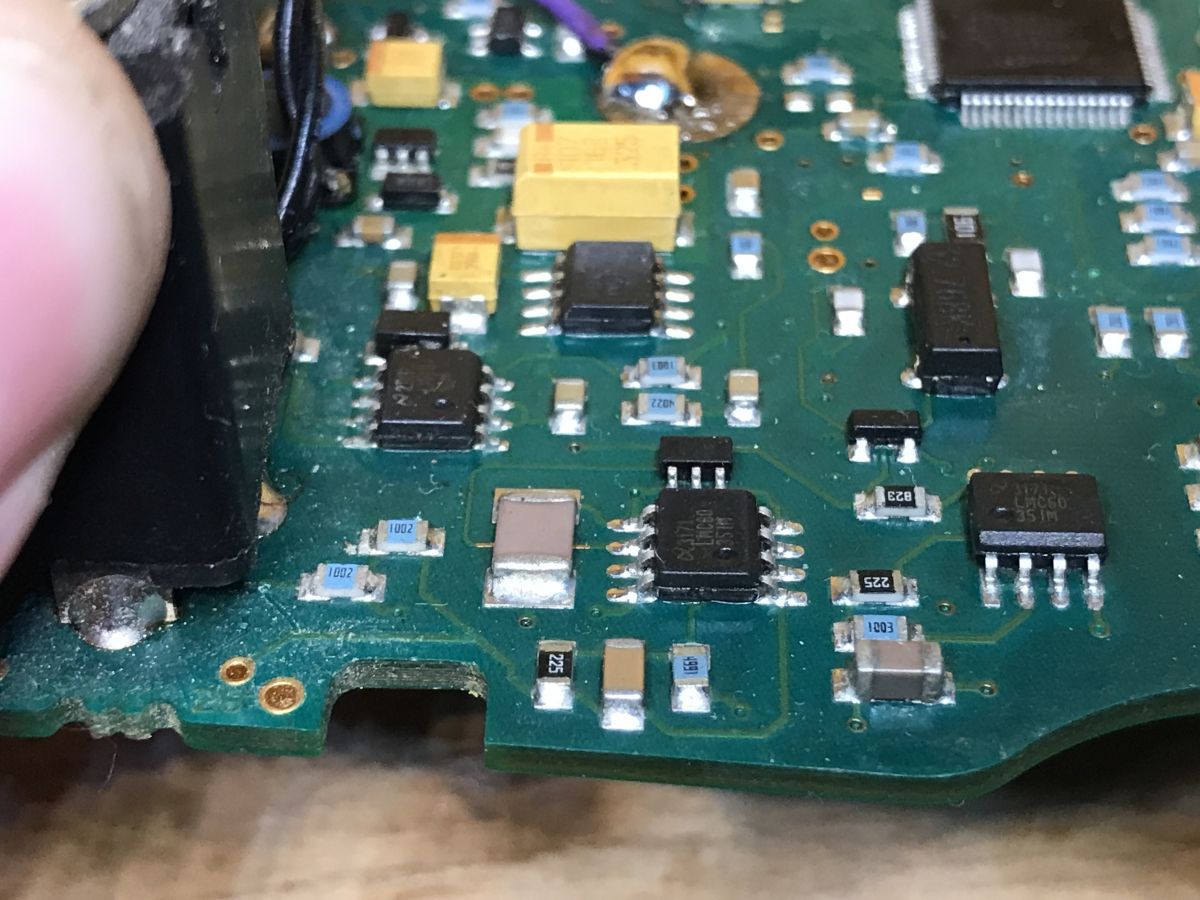

    Here's a look at the inside of a mid-range metal detector. The Garrett Ace 250 is generally available to buy for around PLN1,250, although I sometimes see used pieces being sold much cheaper. The detector itself is quite capable, as it offers graphical imaging of the conductive properties of the find and the current discrimination settings, various modes of operation (metals, jewellery, coins, etc), selective discrimination, pinpointing and so on....
    Except that the detector came to me for inspection after a 'battery drain', so here I will focus on the presentation of the interior rather than the treasure hunt. I received the base itself:
    Garrett Ace 250 metal detector housing with exposed PCB underneath. Image of a yellow casing base of a Garrett Ace 250 metal detector with visible ports and manufacturer label. View of the yellow housing of the Garrett Ace 250 metal detector with a label. Bottom of a yellow Garrett Ace 250 device casing with a quality control sticker. .
    We take a look inside:
    Interior of a metal detector showing the PCB and battery compartment. .

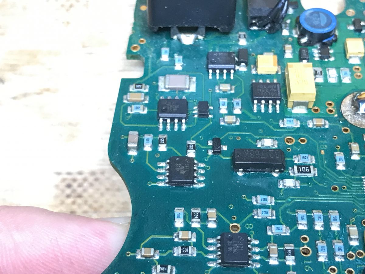

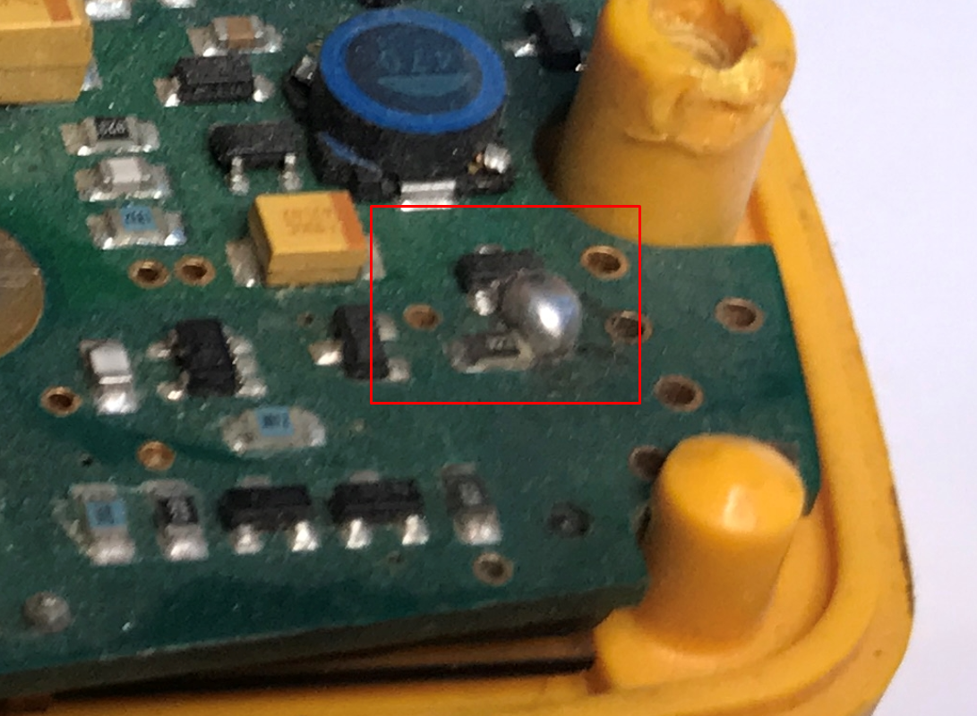

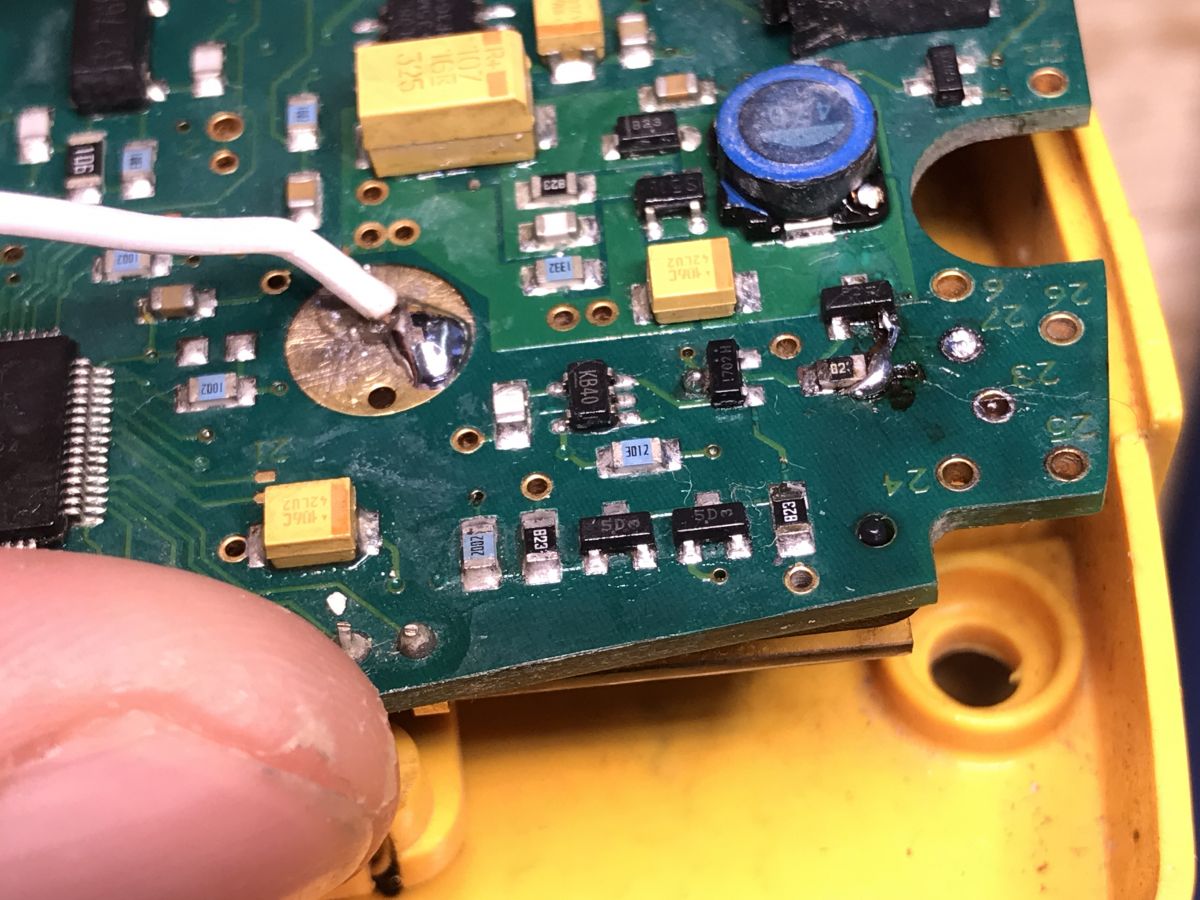

    It vaguely reminds me of a battery spill, but it looks like there was a protective coating on the PCB which has largely washed off? Strange, but not the strangest thing.

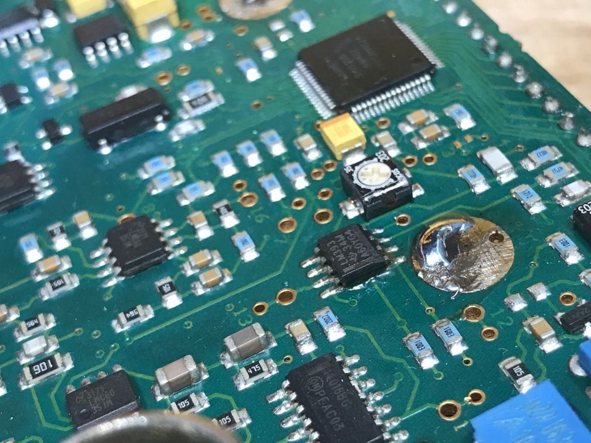

    Close-up of a circuit board inside a metal detector. Close-up of a damaged PCB from a Garrett Ace 250 metal detector. Interior of Garrett Ace 250 metal detector with visible PCB and components. Close-up of disassembled electronics of a Garrett Ace 250 metal detector, showing the PCB. Close-up of disassembled electronics of a Garrett Ace 250 metal detector, showing the PCB. .
    What happened here and who was here?

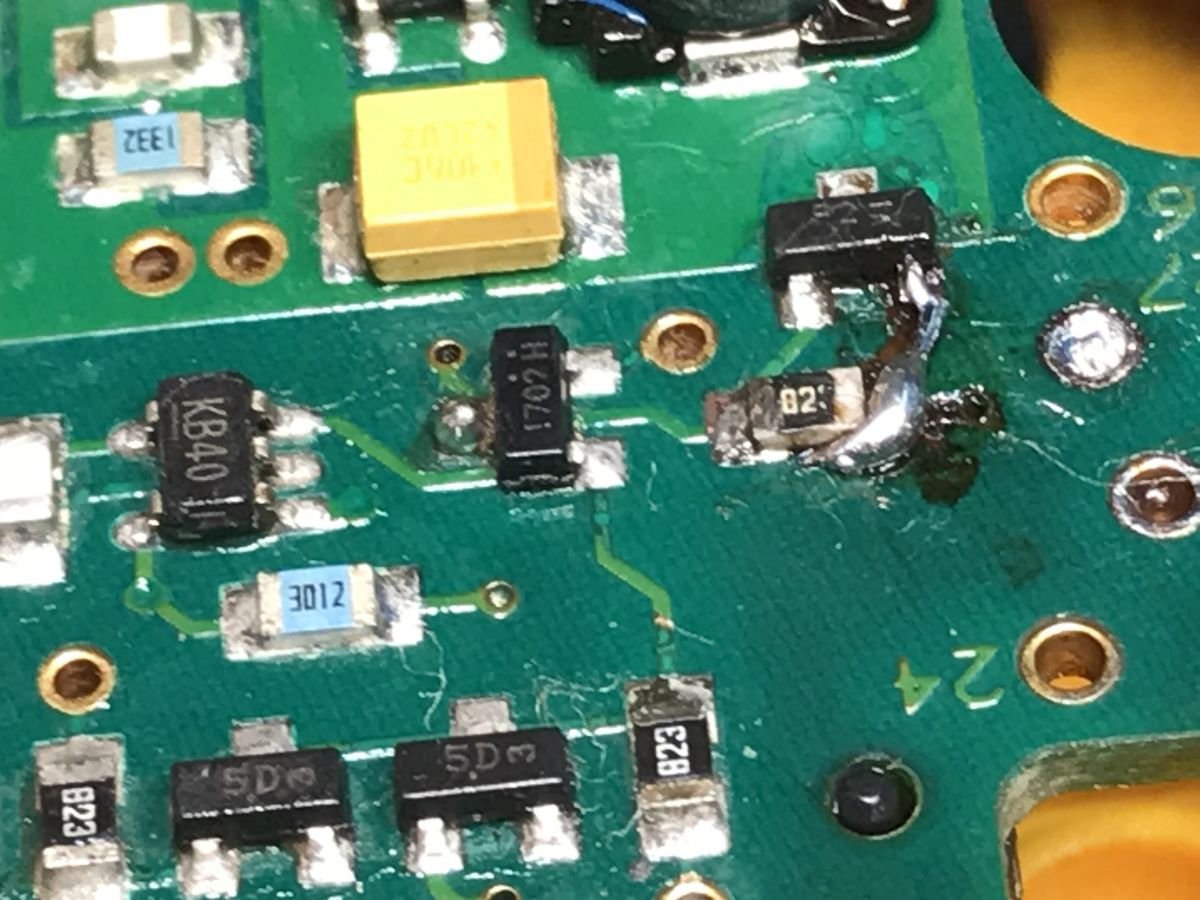

    Close-up of a metal detector PCB with a damaged resistor. .
    This is unlikely to be a factory job, additionally the 82k (?) resistor has lost one leg so there is no contact there at all....

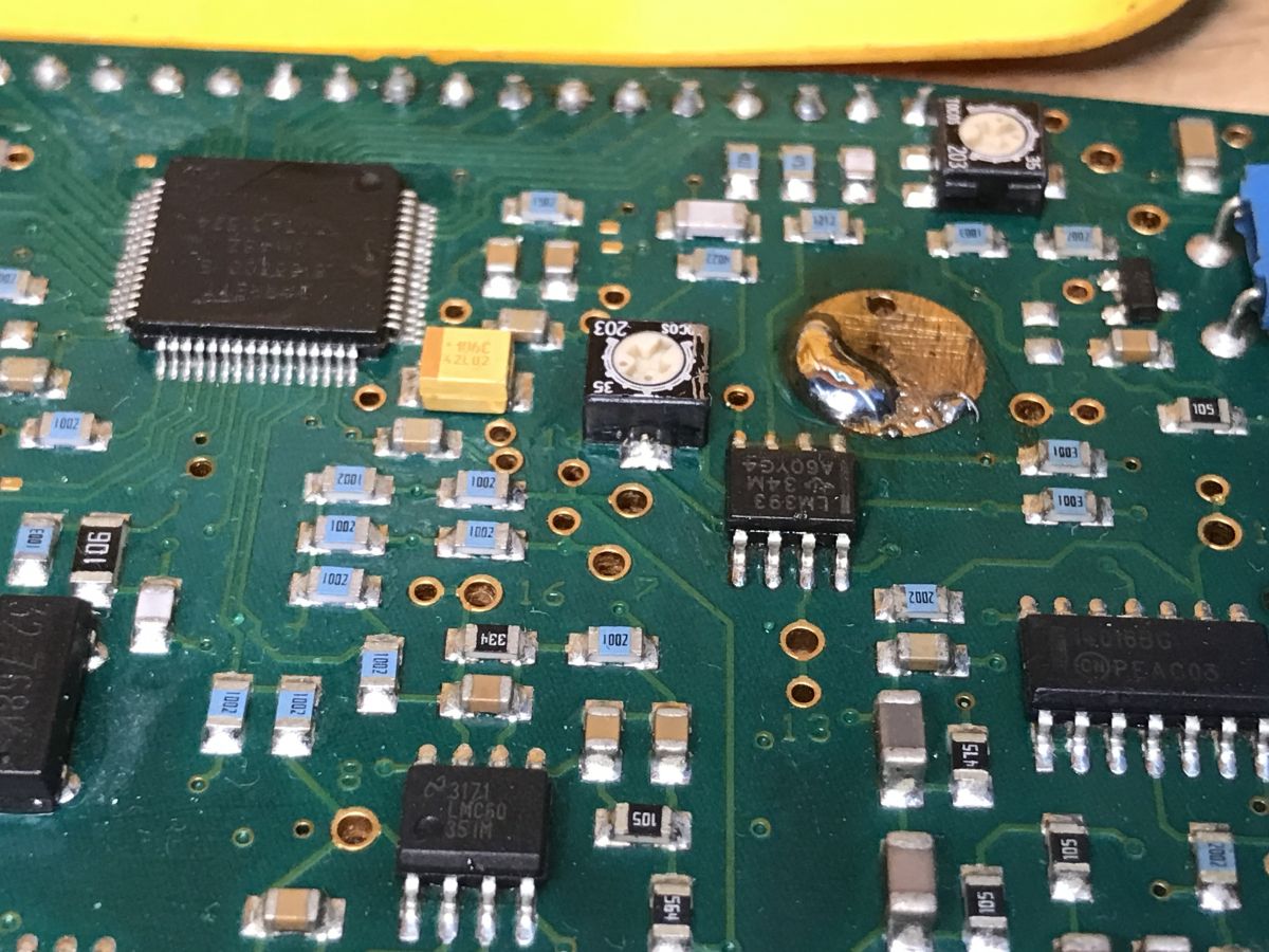

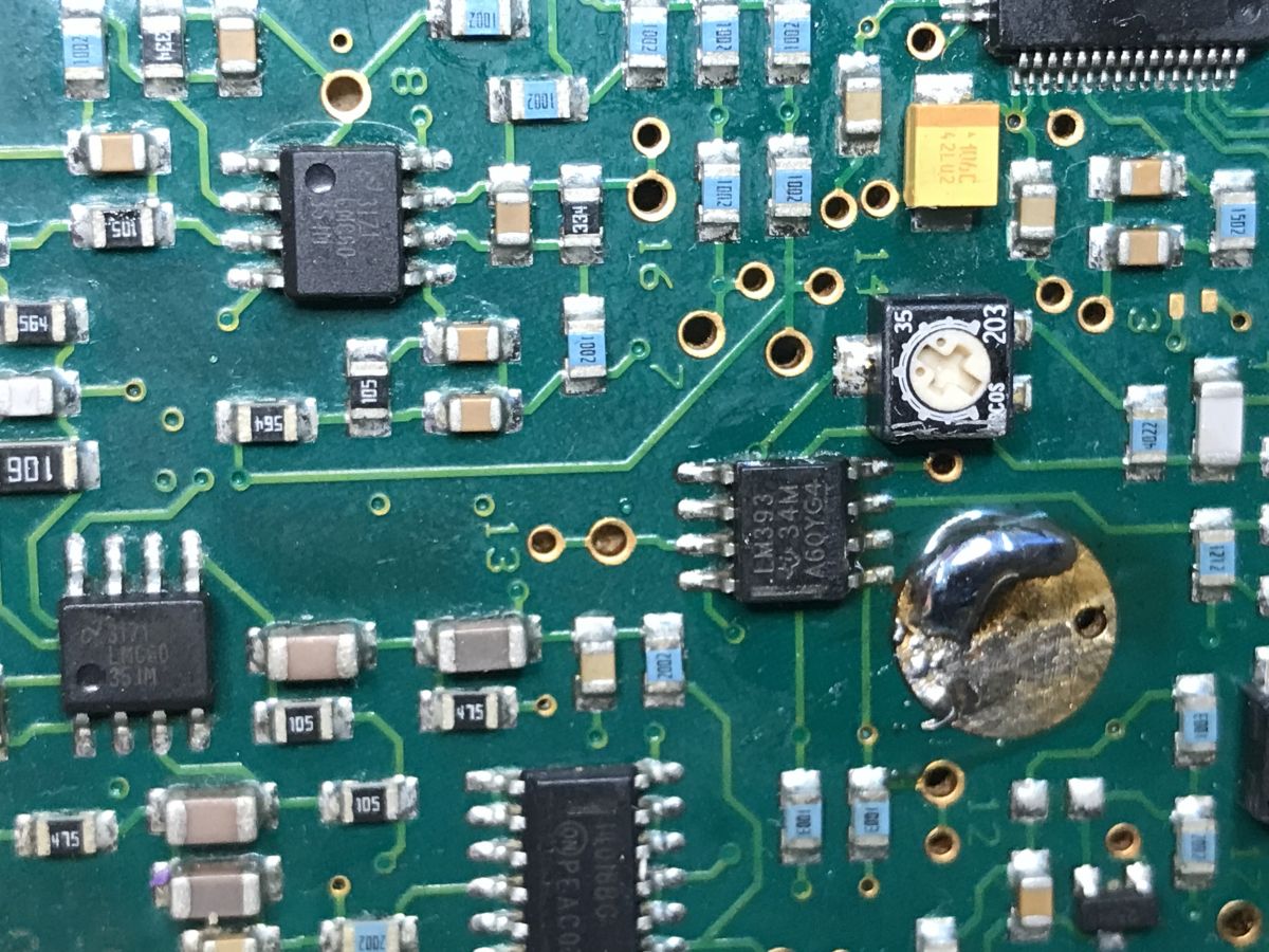

    I cleaned the PCB of dust with isopropanol and then tried to touch this ball with flux. I also wired myself a lab power supply:
    Close-up of a damaged PCB with electronic components. .
    Close-up of a damaged metal detector PCB. .
    The detector does not turn on and the resistor is clearly missing one pad. In addition, what's more, on the right you can see that there was a path and a via, and it's not there either....
    This does not look at all like battery drain damage.
    The path needs to be reconstructed, just where does it lead to?

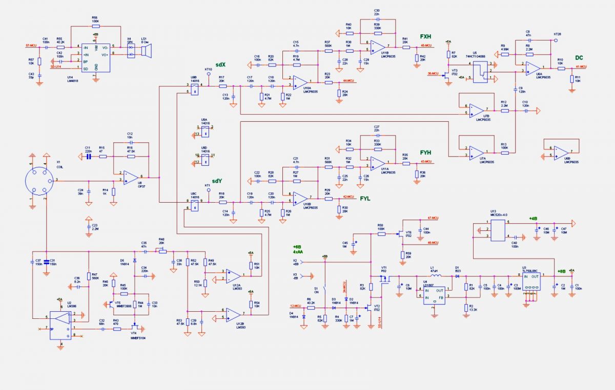

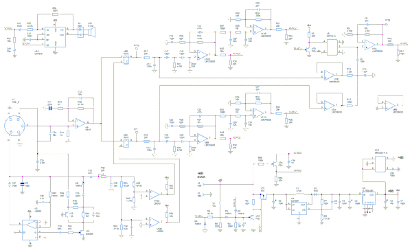

    Fortunately, I was able to find a diagram:
    Electronic schematic diagram of part of a Garrett Ace 250 metal detector. .
    Electronic schematic diagram of the Garrett Ace 250 metal detector. .

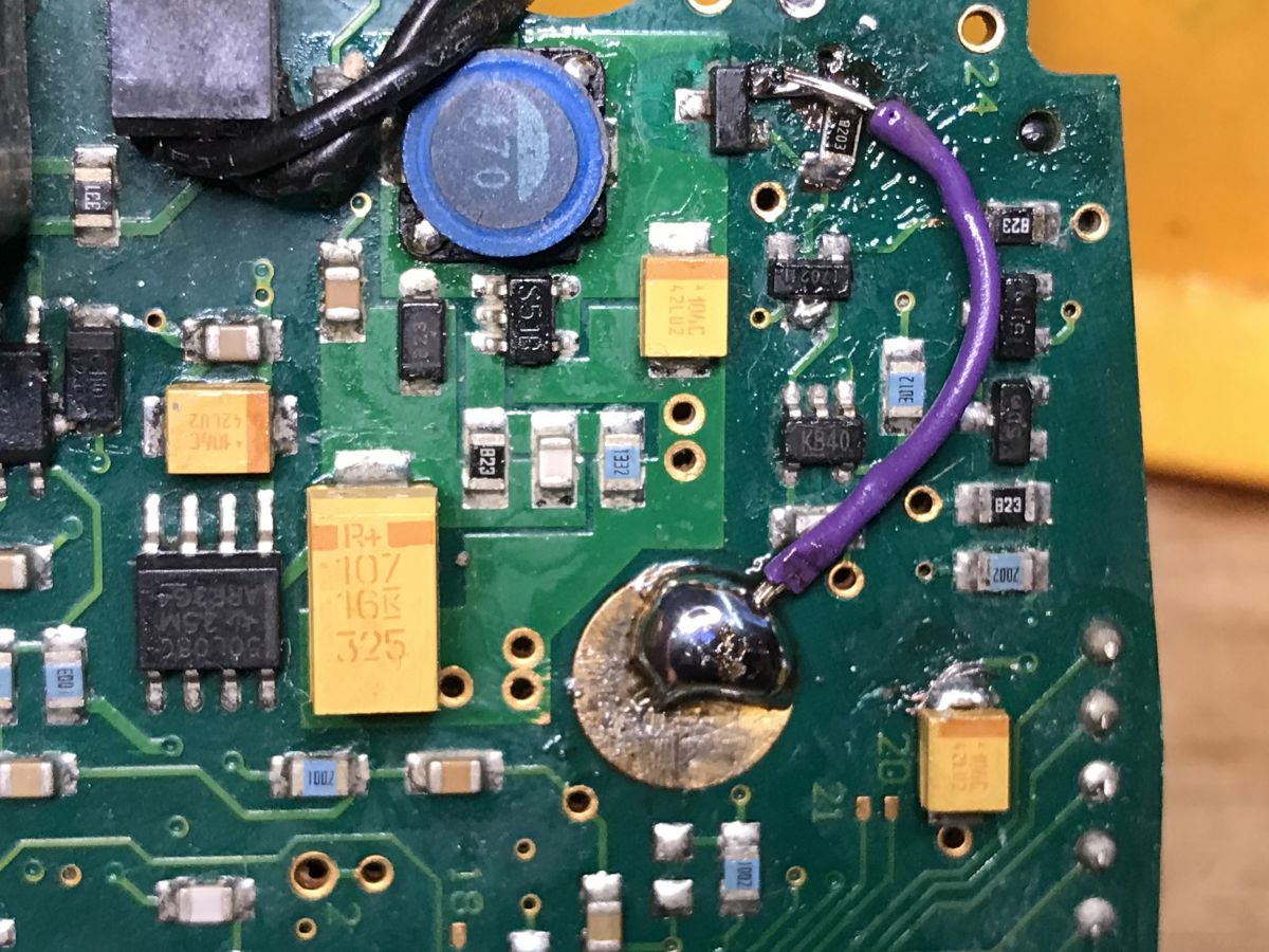

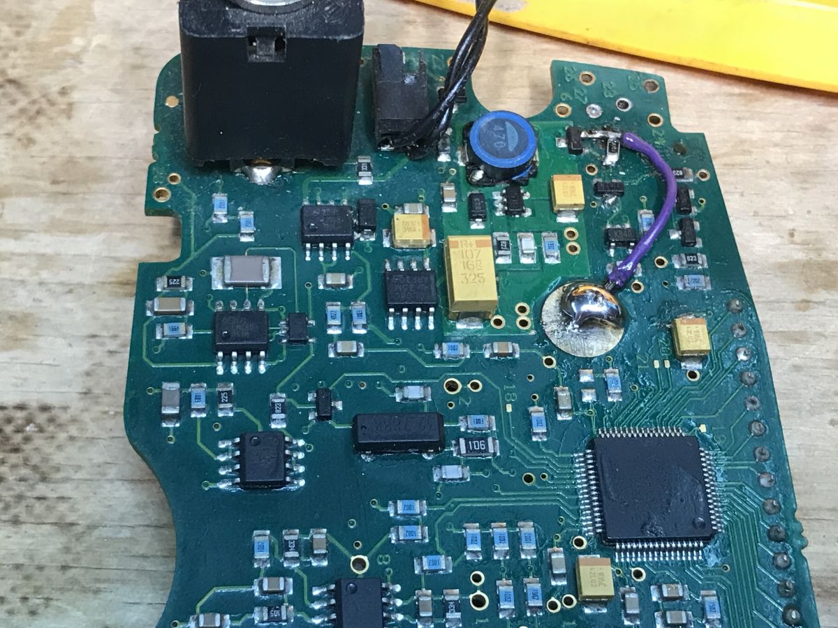

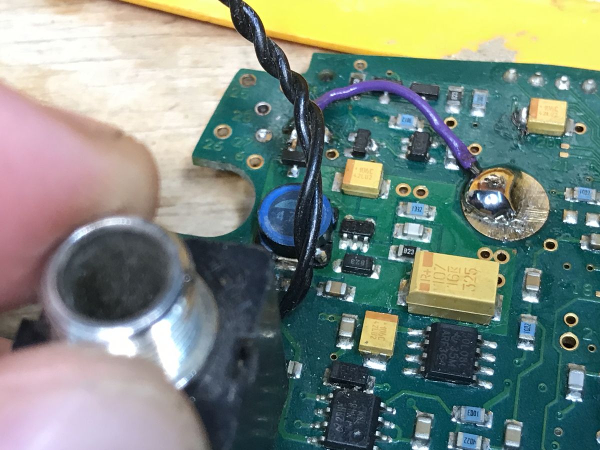

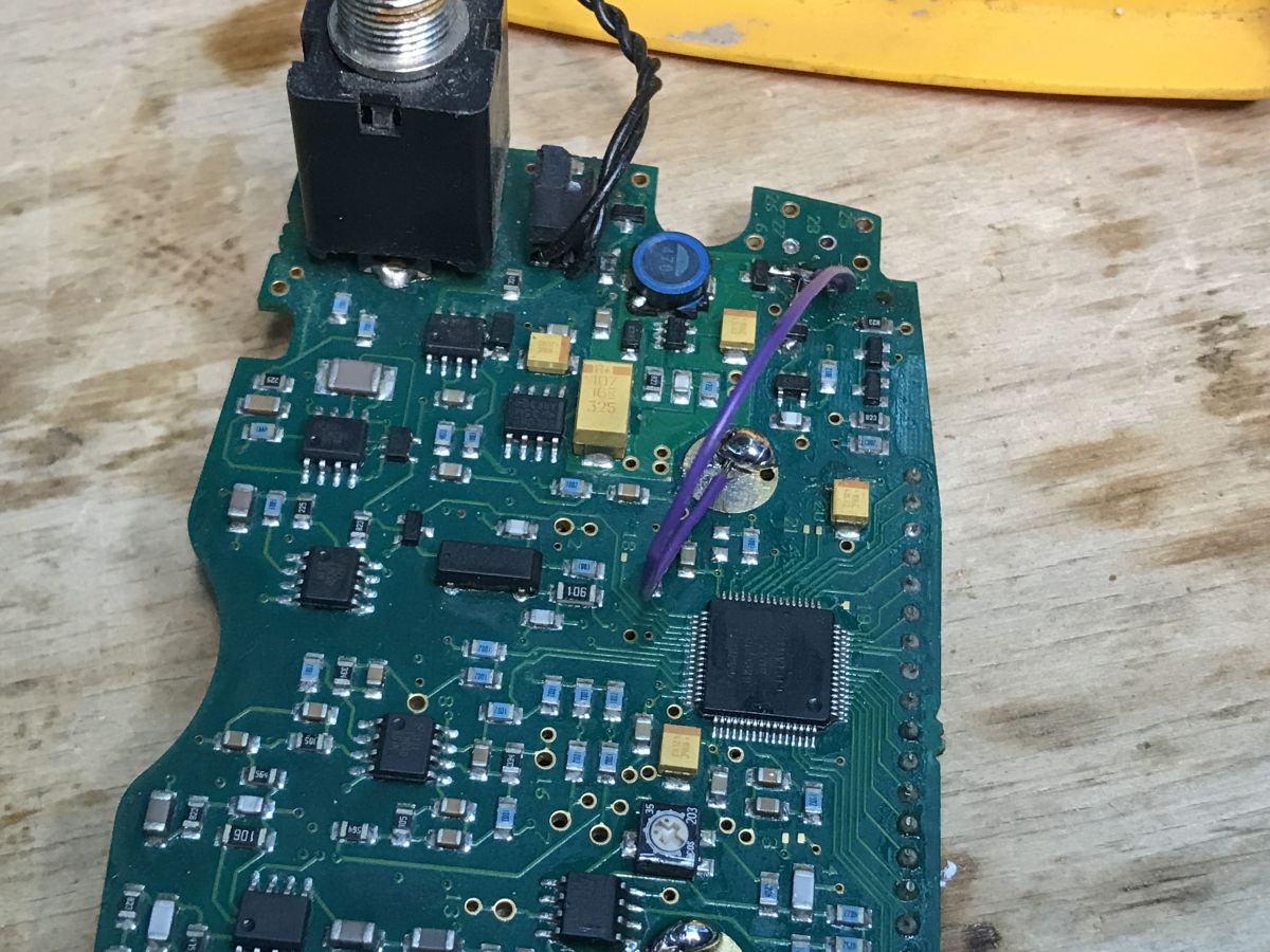

    The defective resistor is resistor R3 82k. The missing path is from the battery (X2, +EB) to R3 82k and VT1 P02. I added a jumper, first as a test:
    Close-up of the PCB interior of a Garrett Ace 250 metal detector. .

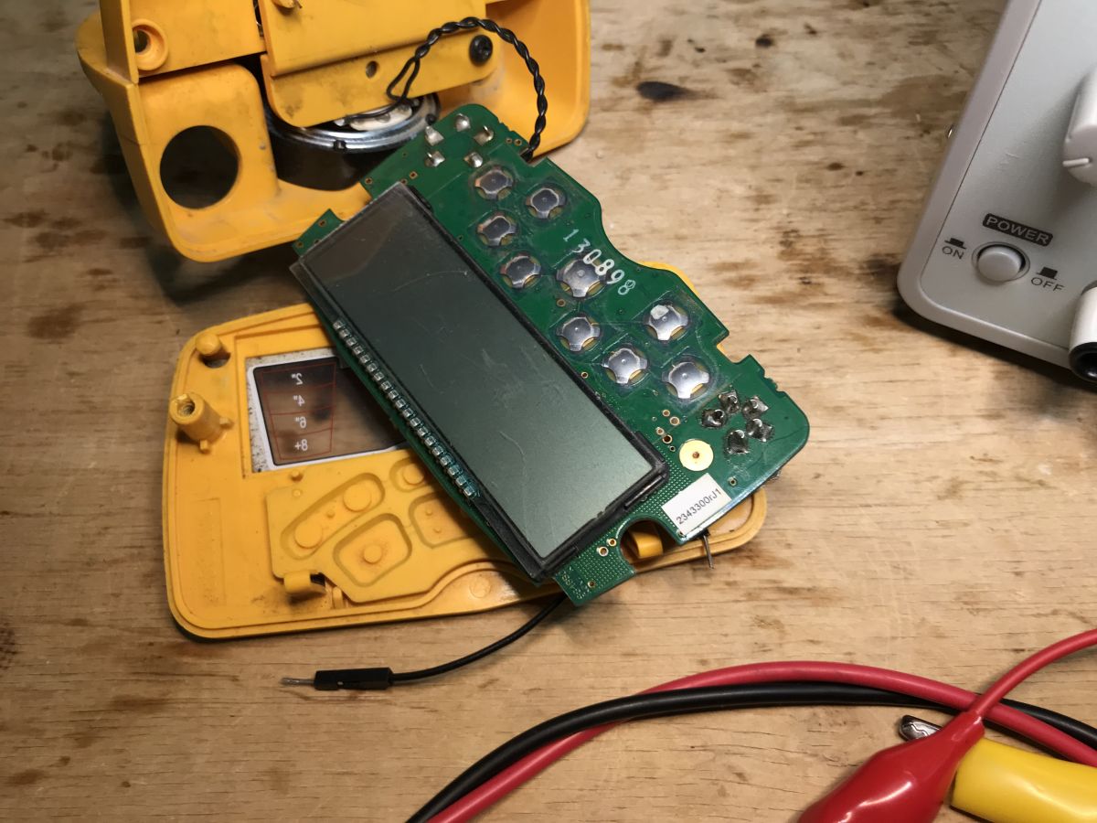

    I replaced the resistor - I have these booklets:
    Prepared organizers for SMD components (Sample Book) - how to organize SMD? .
    Then, carefully, with the current limitation, I fired up the detector. The power button should wake it up:
    The interior of a metal detector with exposed PCB and base housing. .
    The hardware seems to have woken up. The current draw isn't very high either.... that doesn't explain why the path burned? Or maybe someone burned it earlier, played with it?
    Now need to probe and test, see what happens next.

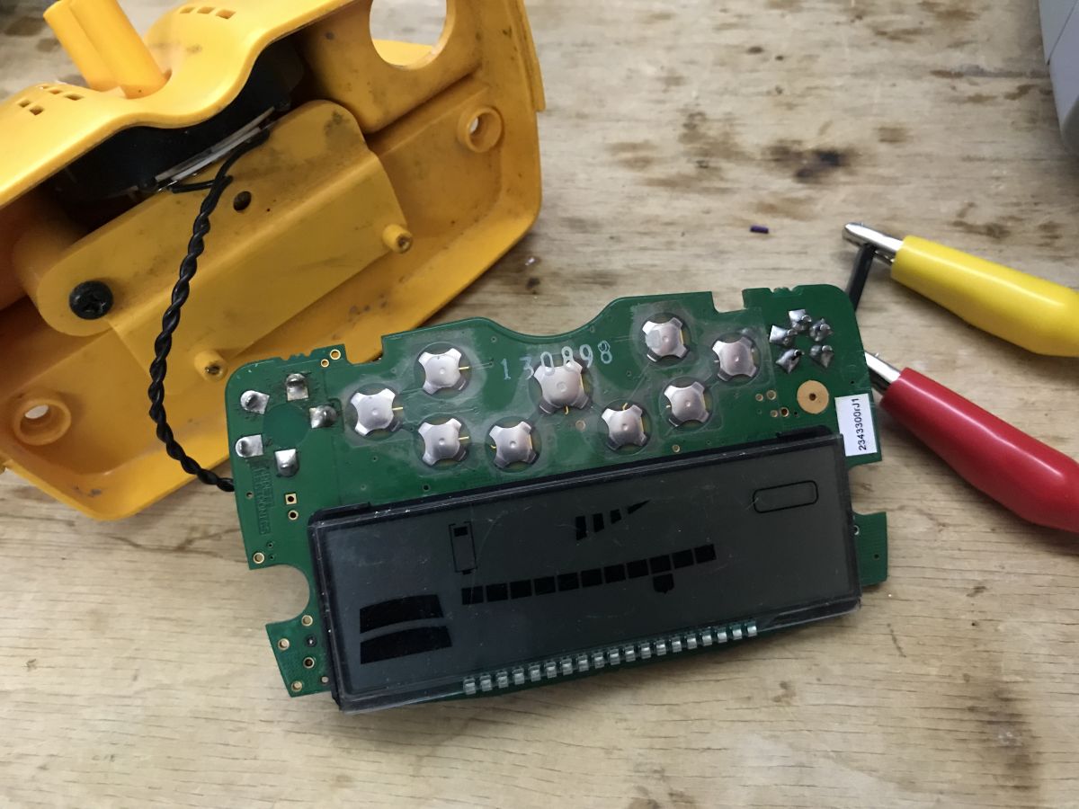

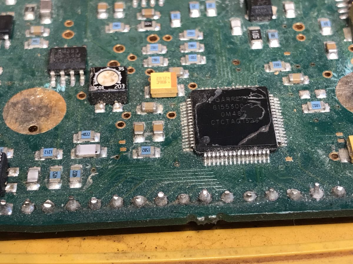

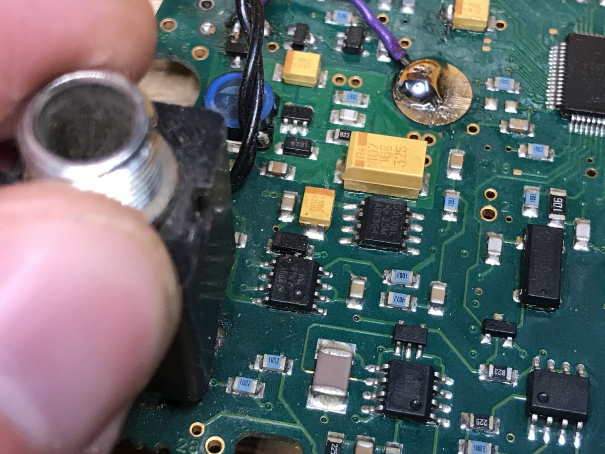

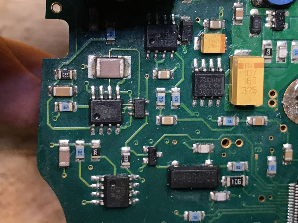

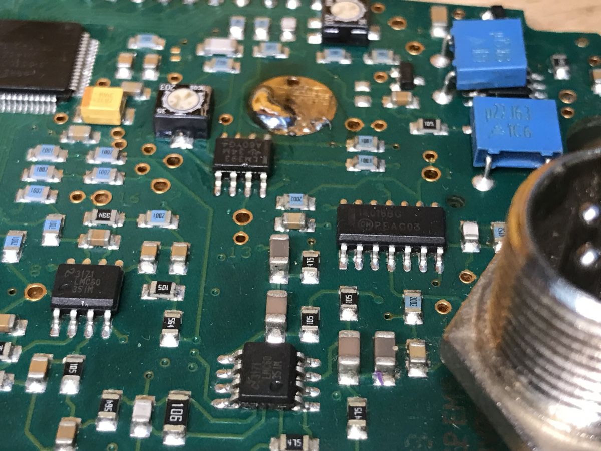

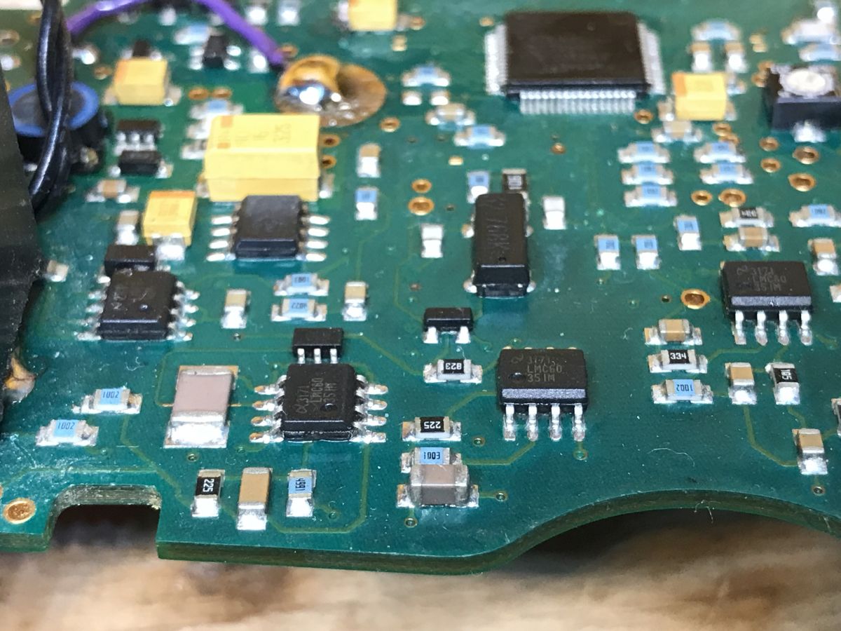

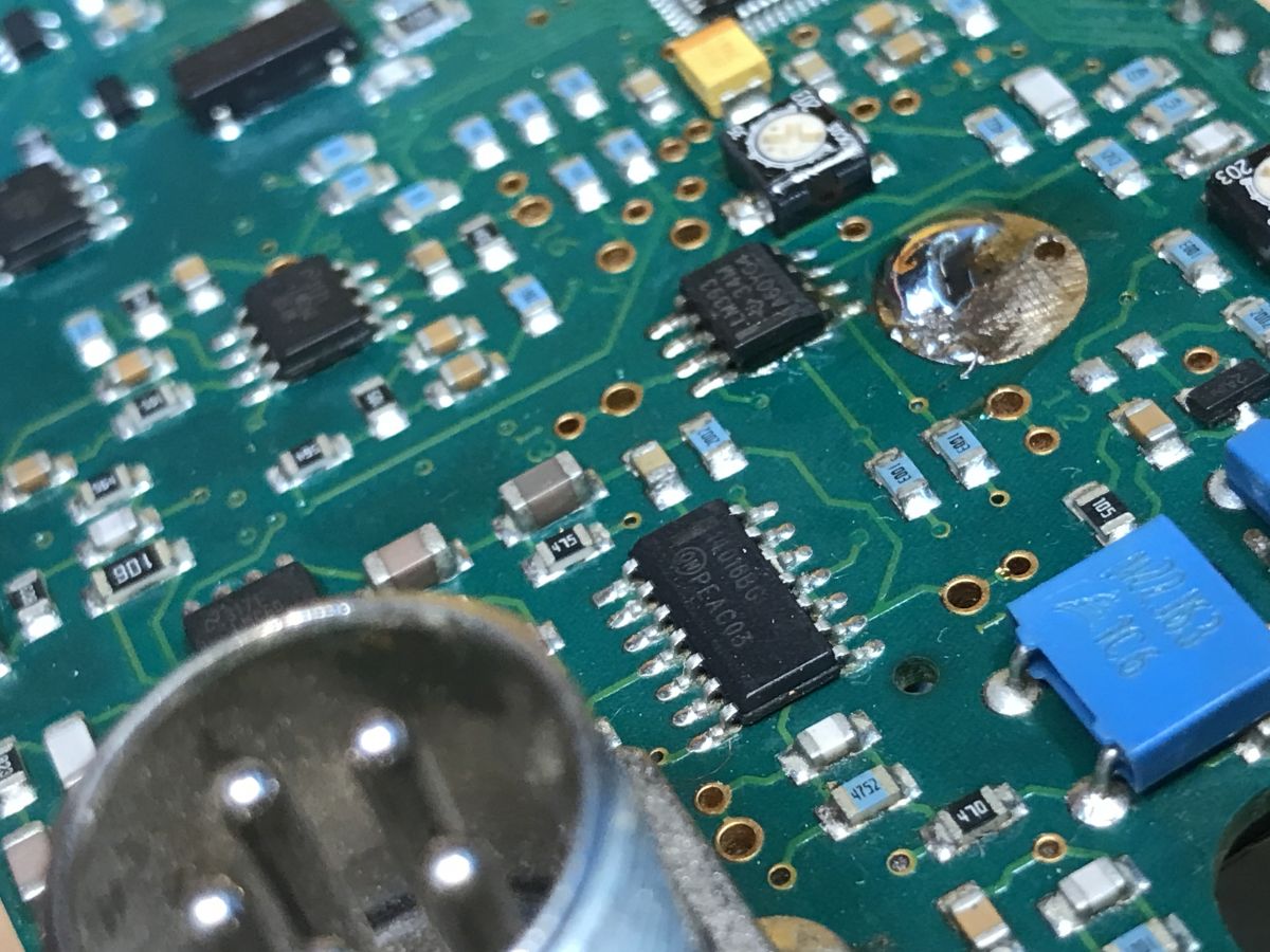

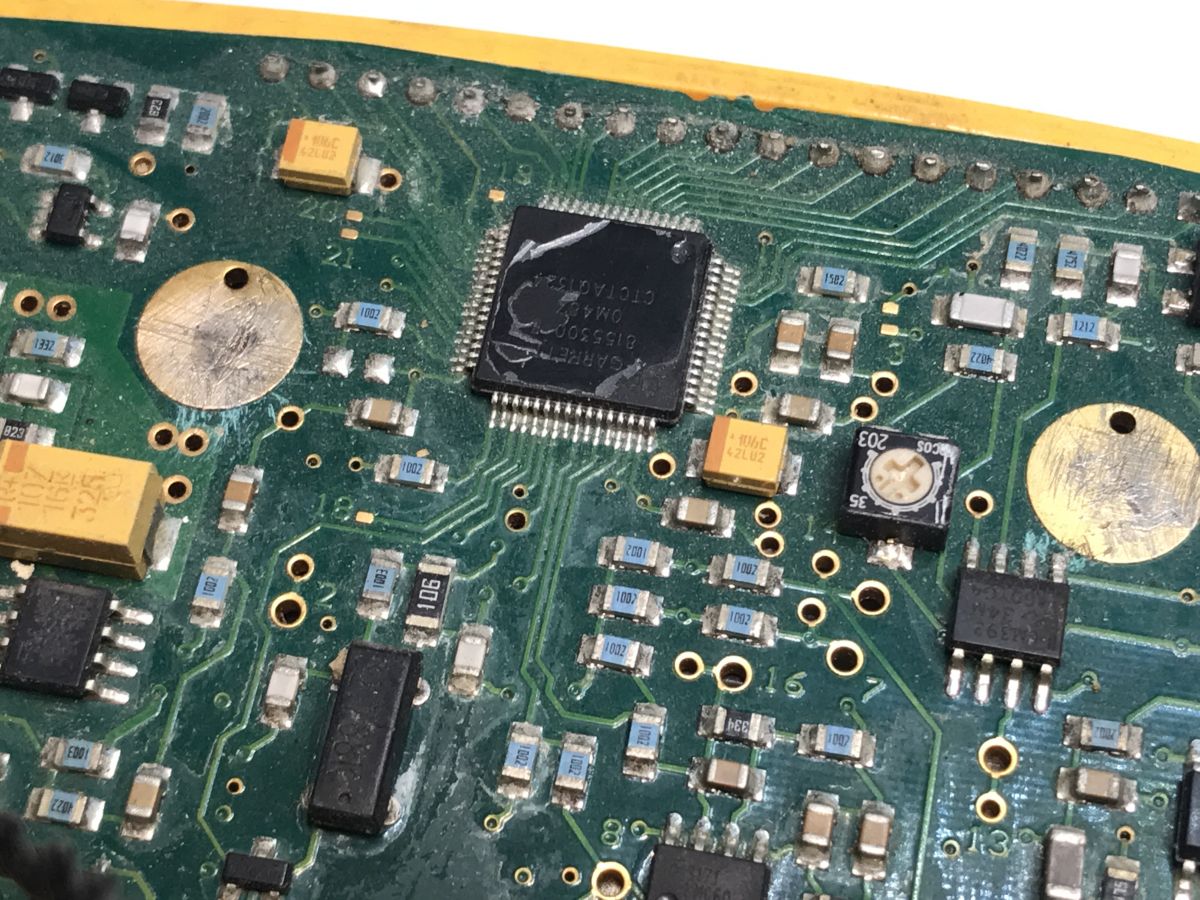

    In the meantime here is a collection of photos of the rest of the PCB, maybe someone will find it useful:
    Circuit board of Garrett Ace 250 metal detector with damaged trace. Close-up of the metal detector's PCB interior. Close-up of a PCB from the Garrett Ace 250 metal detector. Close-up of a metal detector circuit board with various electronic components. Close-up of the metal detector PCB with visible electronic components. Close-up of the metal detector PCB with visible electronic components. Close-up of a metal detector PCB with electronic components and a detached socket. Close-up of a metal detector's PCB with various electronic components. Metal detector PCB with visible components and damage. The interior of a damaged PCB from a metal detector. Close-up of a PCB with various electronic components. Close-up of a metal detector's PCB with visible repair. A close-up of a metal detector PCB with visible electronic components and a damaged trace. <br/span> <br/span>Close-up of a circuit board with electronic components and soldered elements. .
    After taking the photos, I had to do some more tweaking - removing some bonding from the battery contacts. Connecting the wire in the situation in the photos with this interfered, I had to fix the solder.
    The owner was happy to take back the detector, if there were any problems he was to let us know, and there have been no reports since, so it seems to have run its course. The mystery, however, remains a mystery - what really happened inside there. All in all, that's it for now, the presentation would have been more interesting if I'd had a probe as I'd have checked how the detector performed in practice, but maybe that's sometime, maybe I'll borrow it for testing.... To conclude, have any of you perhaps come into contact with any detectors, if so, which ones?

    R3 pulls up the gate of the P-MOSFET to the source in the power circuit. There is still some SD_U14 going to this gate, perhaps this is connected to the complementary output.
    Error or sloppy assembly or someone has been messing around with the power supply.

    To me that massive drop of tin looks like an attempt to make a bridge. I know from experience that if the distances are a bit bigger, it's not easy.

    Using too high a temperature when soldering can end up like this, so it's worth experimenting at an electro-smashing shop first and breaking down the pads/elements there to avoid spoiling the equipment for repair. Flux is also essential.
