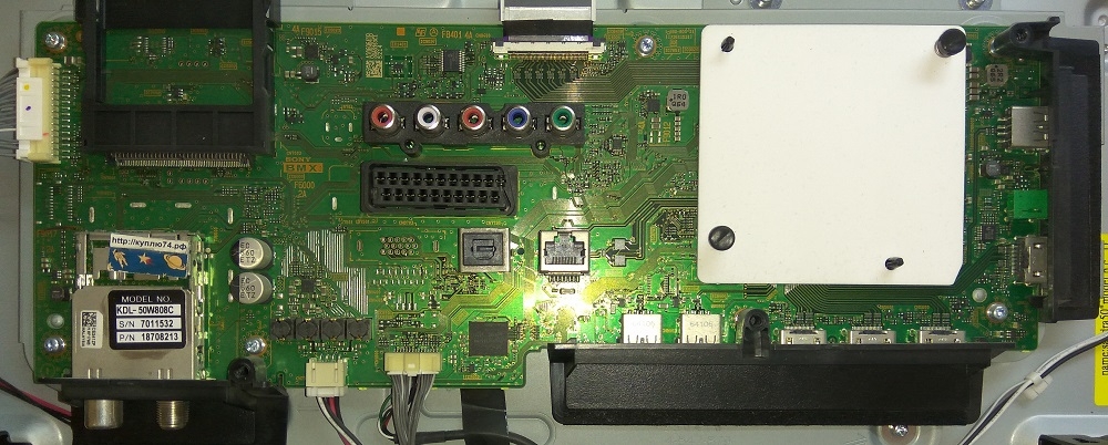

    Hello, the TV keeps rebooting after turning on, turning on the colorful circles start spinning and after about 3 seconds it turns off and on again and so over and over again I suspect that it may be software on emmc on the motherboard. The backlight works properly when the hob is disconnected.
    The voltage on the board is correct.
    I called the store to buy a new board and was told that the board fits different sony TV models and should be properly programmed.
    Is it about programming with a batch of emmc memory, or are such new discs programmed in a different way? Where can I find the batch for this TV?
    I heated the hot-air processor it did not help.
    Emmc SK hynix H26M52103FMR memory
    MB 1-980-805-31 (173611531)

    turns on, the colored circles start to spin and after about 3 seconds, it turns off and on again and so over and over again I suspect that it may be emmc software
    Quite right, but sony has self-diagnostic, if something is wrong it's red blinking ..

    I forgot to write about it, the diode is not blinking red. Lights up white all the time goes off when restarting and lights up white again.

    the LED is not flashing red.
    So self-test doesn't work, it should throw out the blinking code

    It didn't blink red and that's why I heated the processor up, but no changes were made after warming it up.

    I'm sorry to be monothematic, you did right, it follows that something with the processor ... balls?

    Hello, I have the same problem with the Sony KDL 50w809c TV, the pena soft did not give anything, the hard reset also did not, the diode only blinks white and at the time of restart it goes out for a moment, sometimes android wheels will appear and after a second restart ... someone has Any more ideas, what could I check? The TV is 2.5 years old and I feel a pity ...

    pcb: 1-980-805-31 Sony Kdl-55w807c Main Board
    Sony p.nr .: 173611531 / A2071539a
    chassis BMX2 / GN1G CHASSIS
    It's from this forum Link
    Available (was) for 129 EUR Link
    SM e.g. Link
    ps
    Because e.g. ver.43 "1-980-805-31 (173611531)
    A2069641b Sony Kdl-43w808c
    It is available
    1-980-805-31 173611531 A20696418 Main for SONY KDL-50W808C
    - eMMC H26M52103FMR
    - matrix V500FWME01
    - Difference in LVDS etc.

    Or maybe someone knows where I can find a batch for this MB model for eMMC memory?

    Only from donor (donor) or Sony service.
