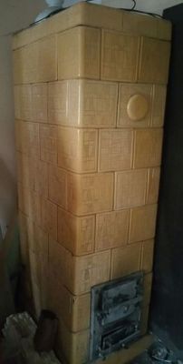

    Demolition of the tiled stove.
    Is it true that 100-150 liters of water should be poured into the stove from the top to avoid dust during demolition?
    This water will soak into the tiles, bricks?
    Will it flood the apartment?
    How much does the stove weigh? I have 300 kg per person/year as a free reception at the landfill, each additional kg is 18 groszy.
    It will flood.
    Unless you seal the firebox and ash pan doors.
    And will these 100 liters of water soak into the tiles?

    You can moisten from the inside to make it less dusty, but fill it completely from the inside ... I doubt it would be a good idea.
    While the bricks will absorb some water, I doubt the tiles.

    You could possibly pour water on the stove from the top, but only after removing the first layer of tiles from the top, unless the entire top is made of tiles. Tiles do not absorb water from the outside because they have a glaze similar to tiles. Only the middle part of the tile absorbs water. To prevent dusting, you would have to pour water slowly and wait for it to soak in, I don't know if it makes sense, because a small amount of water will probably not be effective, and excessive water will probably flow down through the smoke channels and you will only make grands (mud + soot) . It's best to slowly dismantle the tile, tile by piece, picking everything you find inside into buckets and taking it outside.

    it will be best to take it apart layer by layer, spray each layer with water from a small sprayer during the demolition. This should effectively reduce the amount of rising dust.
    Either way, it's going to be hard to take it apart completely without making a mess. Of course, you need to put foil on the floor, because the remains of debris / sand / soot very badly damage (scratch) the floor.

    I dismantled a similar stove during the holidays. We removed one level of tiles and then with an industrial vacuum cleaner (Starmix with filters shaking and a filter bag) we extracted the content of the inside of the furnace. And so on down to the bottom. The part of the room where the stove was located was separated with a double curtain made of thick construction foil, and the furniture was protected with painting foil. The spoil was thrown out of the window in buckets onto a wheelbarrow. The pedestal of the stove was shackled with a demolition hammer - there was a bit more dust here, but spraying with water on a regular basis gave advice. To sum up: there was not much dust, ash and soot, at least not as much as we thought at first - it was enough to vacuum the room and wash the floor. In my opinion, pouring water is pointless, because if there is soot inside, the water will run off it like a duck.

    I dismantled three such furnaces. Always slowly, without haste, using a lot of water from a sprayer, such as for windows or cabin. This is especially true of flues that are full of soot and ash. It's not only about not dusting, but about moisturizing the clay. Leave the door for last. As for the weight, I haven't weighed it but it will be more than 300 kg.

    8 hours, that's how long it took to demolish with the elevation from the 1st floor to the ground floor.
    1 person.
    A little long, but dismantled brick by brick, everything packed in cardboard boxes.
    The sprayer is good, but halfway through the stove, the hand falls off from pressing ... If one sprays and the other disassembles, you can dismantle this stove almost without dust.
    The height of the stove is ... well, I did not measure it, but it comes out to be 7 tiles + the base and the upper end of the stove in the form of half-tiles.
    The weight of the stove is 1050 kg. (weighed on in-run scale)
