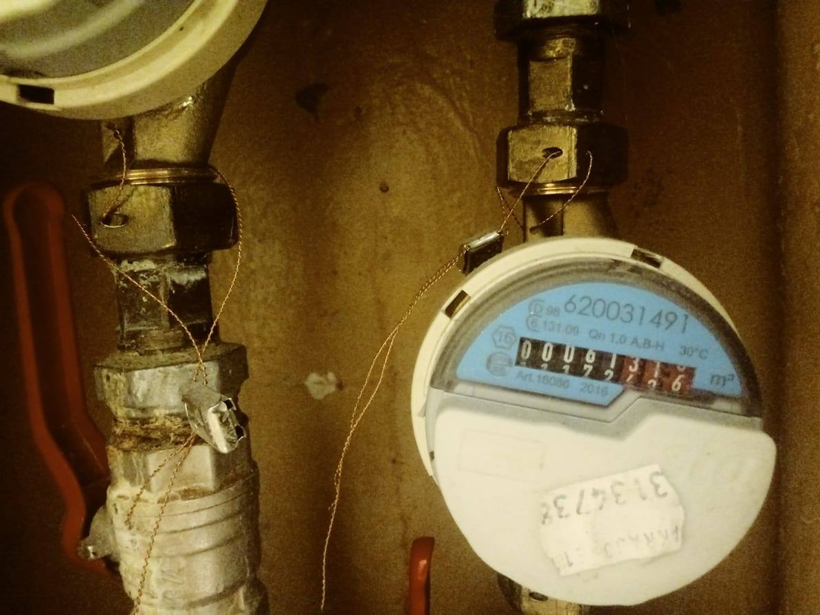

    I have a problem in the sense that I am renting a flat to one person for about 3 years and for a half a year increased water consumption, the case reported to the cooperative, there was a plumber and supposedly checked the installation but it took about 5 minutes. Today, the renter has sent me a photo of the meter and it seems to me that it should not indicate consumption?

    Thanks for the answer. I do not know who owns the meter, but it is possible that the cooperative because its employees deal with their exchange. This article shows that I should force the cooperative to send a meter to the producer. I will write an e-mail to them today, I will see how to address this idea, although I have the impression that in a moment, from a meter reading from 61 m3, it will jump to 72 m3: /

    Of course, the Waterworks have their own scope of work and are responsible only for feeding the pipe to the block and are responsible for the work and legalization and replacement of the water meter counting the water consumption for the whole block. This ends the role of Waterworks. The photo shows that there is a failure of the water meter and this problem should be reported to Spółdzielnia Mieszkaniowa. The co-operative issues a tender for the installation of water meters and removal of faults on working water meters. The company conducts the exchange of water meters in buildings every 5 years.Mounted water meters in apartments have a guarantee and approval and just This company deals with the replacement of damaged water meters and unblocking when the sieve built in the water meter's inlet is clogged with sand and small stones. Leave the letter saying that your meter has a meter failure and let you sign the recipient of the copy. The Cooperative phone calls the company that won the tender for the replacement of water meters is completed by the installer.
  • Mechanical meter digits cannot jump ahead

    xiabn wrote:
    michalek1988 wrote:
    Who is the owner of a water meter? Water supply? Cooperative? http://forum.nikoniarze.pl/showthread.php?t=162494" target="_blank" rel="nofollow noopener ugc" class="postlink inline" title="" > link See this, in my opinion, the situation here can be analogous.
    Hello, calmly, nothing will jump you ;) the mechanical design of the water meter's counter makes this impossible. Decades have a gentle play on the teeth, hence the impression
    that "already" is the number 7. In practice, you can check it by tapping gently with your finger
    in the abacus - the numbers will be arranged in their places, however, it is not possible to switch to a different position. The fact of increasing consumption should be related to lifestyle or leakage in the installation.
    Best wishes.
  • Mechanical play makes the meter reading ambiguous
    Impression? I can not tell if the abacus indicates 61 or 72. Forgive me, but the light clearance is not half a turn.
    Of course it is. How many court cases did the bobbing jump over and people had 20,000 bills?
    The counter should work so that the reading is unambiguous. It is not here.
  • Mechanical play can make the meter reading ambiguous

    telecaster1951 wrote:
    Do not be annoyed, half a turn would be if 6 jump over you for example 1 - once.
    In the courts, there may be "matters", another matter with which judgments end :) . But believe me, the construction and operation of the barrel precludes its spontaneous skipping (the exception is the situation when someone physically damages the mechanism to block it) which will come out during the additional mechanoscopic expertise. In practice, however, the court will rely mainly on metrological expertise carried out by the official GUM where the accuracy of the water meter will be assessed, the errors can not exceed circulating errors, which currently amount to +/- 4% for the main scope and +/- 10% for Qmin / Q4 for water meters for cold water and the validity of verification features.
    I have been dealing with such expertise for almost 30 years and if I write to you that it is natural clearance, in 99 cases out of 100 I am right.
    Greetings,
    N.
