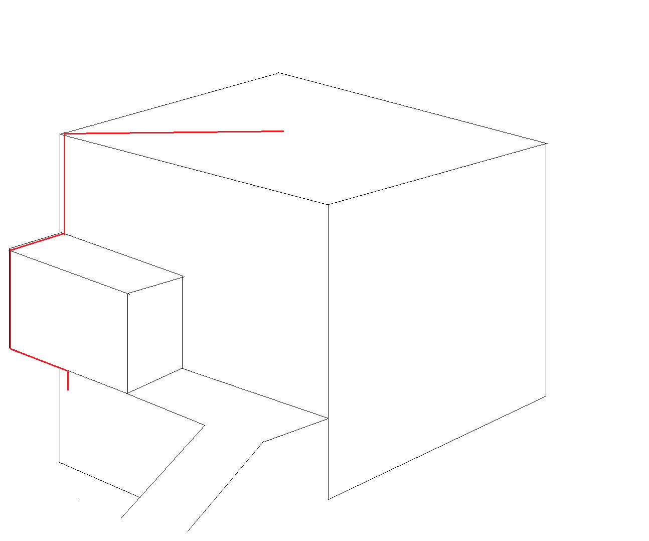

What cable cross-section should I use for a 3-phase AC line from microinverters over about 30 m for a 9 kWp PV installation?
Use a 5×6 mm² cable; it was stated to be sufficient with plenty of margin for three single-phase microinverter groups of about 3 kWp each over 30 m [#17774790] Another reply said the minimum is 5×2.5 mm² and the practical optimum is 5×4 mm², with anything larger mostly wasting money unless you specifically want less voltage drop [#17775810] For a 3-phase inverter, 5×2.5 mm² was also described as enough, but a thicker cable can make sense if the network voltage is already high and you want to avoid inverter shutdown from overvoltage [#17750178] Several replies favored copper over aluminum for reliability at the connectors and to avoid oxidation issues [#17776113]

    Well, there will be some 90-degree bends, see the illustrative drawing below
    Isometric drawing of cubes with 90-degree bend lines.
  • Conduit or surface routing for easier cable access

    hindoos wrote:
    o there will be some 90-degree bends, see the illustrative drawing below
    In this configuration, the routes are only inspections at the bends of the sewage system (pipes) in order to be able to do anything with this piping in the future. Of course, they are designed so that the cabling can be pushed through them.
    An alternative - in a conduit or some piping on the ground and together with it on the wall. Or strips or channels. You can do it differently - whatever is most convenient and economical.
