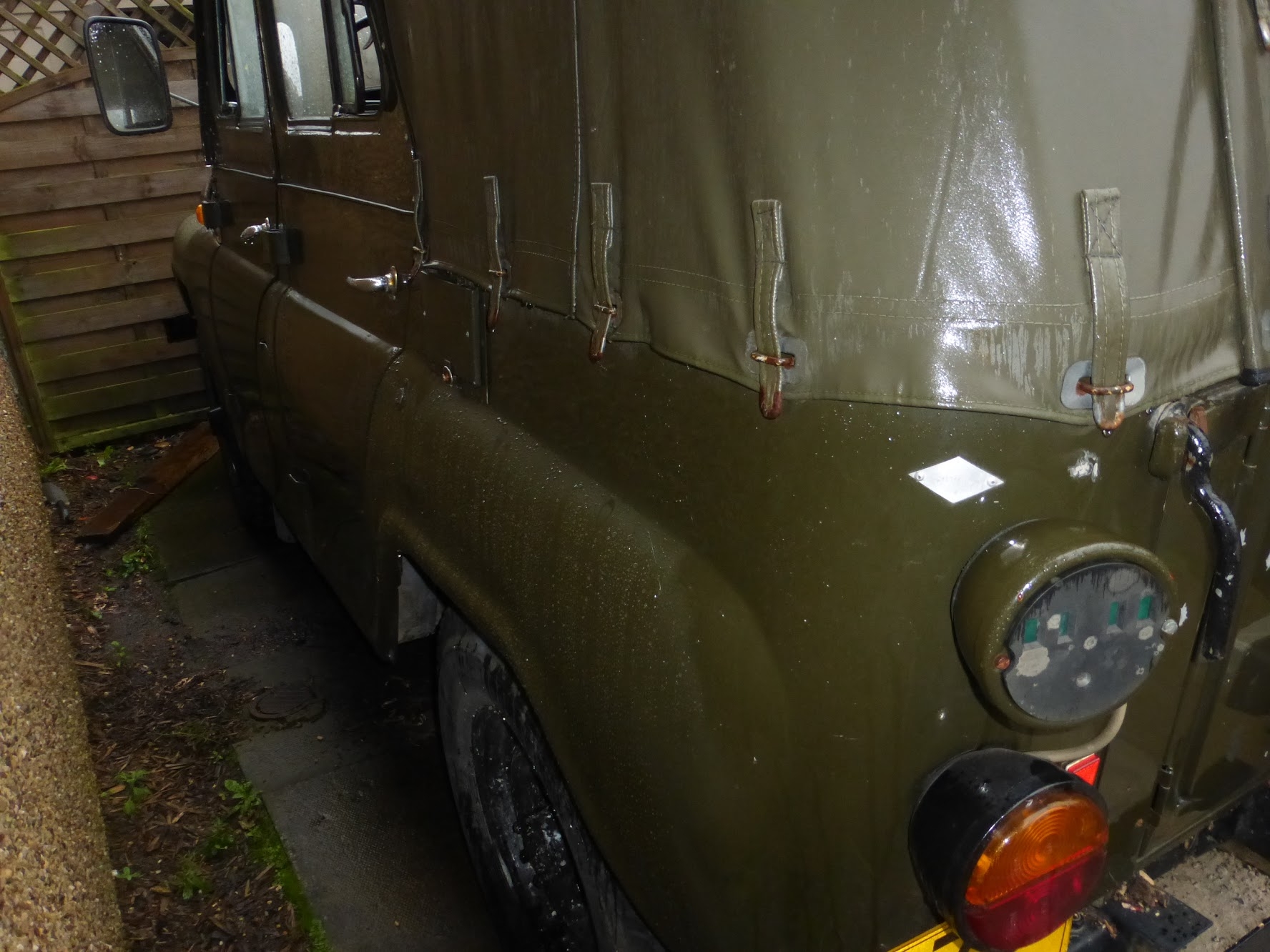

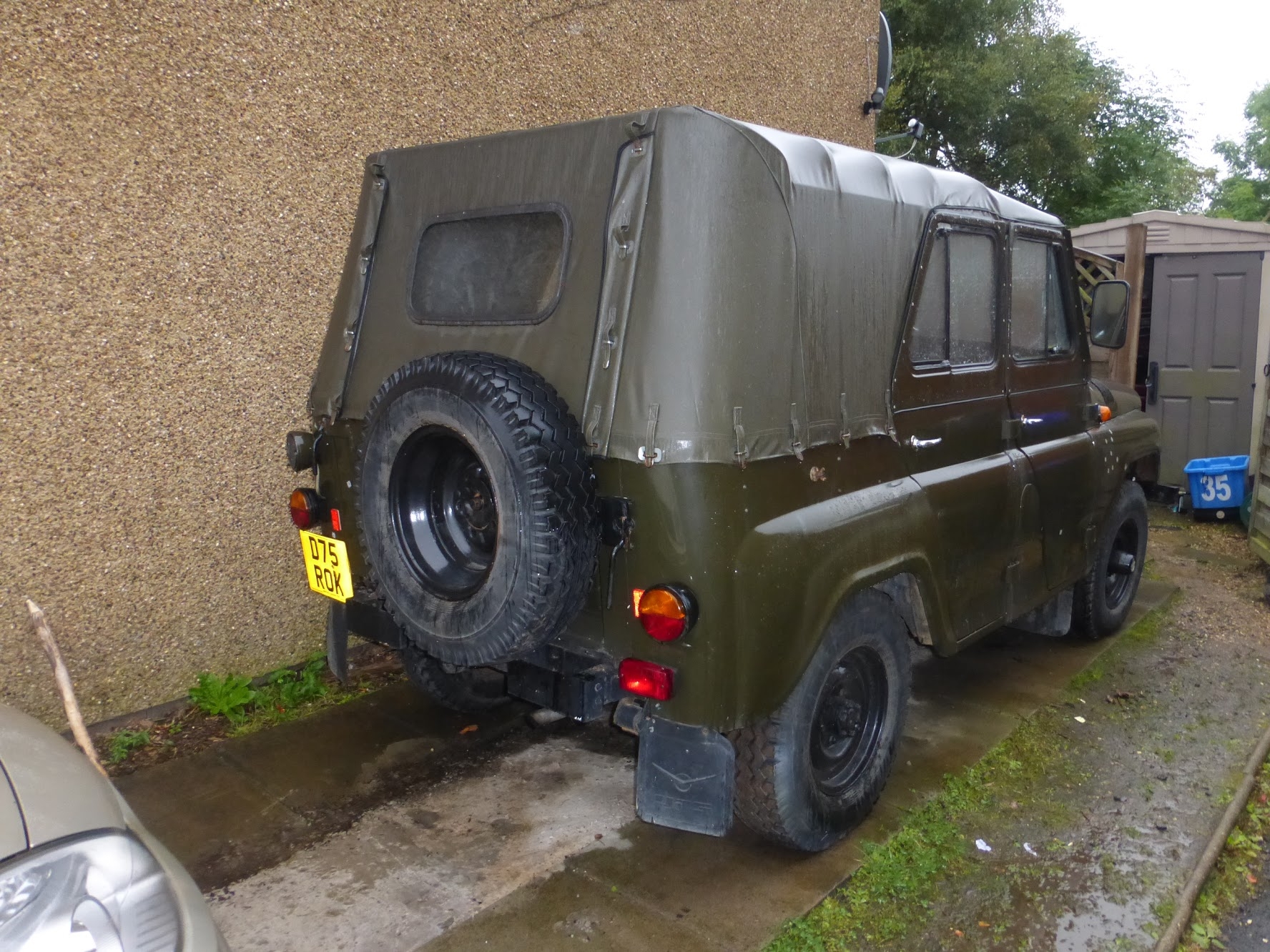

    If you have to do something once a Russian year, such a contraption is not bad.
    It is good for home work, first I welded the thresholds on the Nissan Micra, then and even from this:
    Best Self-Shielding Wire for Lidl Welder to Reduce Spatter?
    I did it:
    Here's a close-up.

    #8 17743222
    sanfran
    Posts: 9987
    Help: 963
    Rate: 3004
    Oh there, immediately tragedy :-P
    When I started to weld it, I was a novice. After a few days, when I finished welding UAZ, I am already a specialist. How much fun !!!
    In addition, no seam is visible under the paint
    Best Self-Shielding Wire for Lidl Welder to Reduce Spatter? Best Self-Shielding Wire for Lidl Welder to Reduce Spatter?
