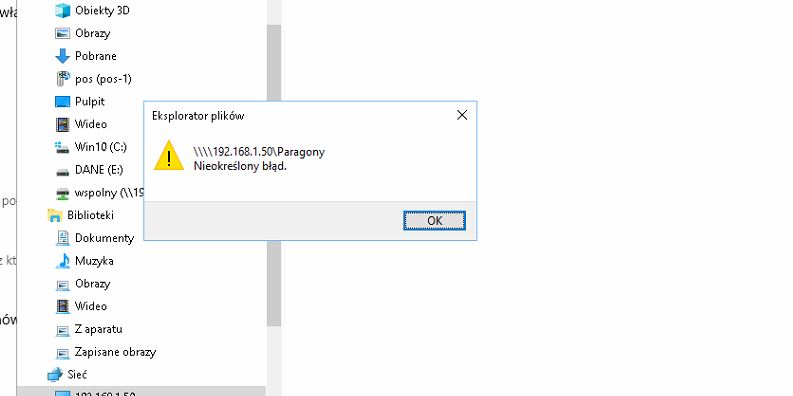

    I have a problem with mapping or connecting to a resource in the lan network. Throws error 0x80004005 when trying to map a running resource on the server.

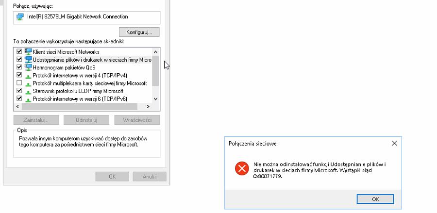

    - A tip of unchecking SMB1 components of the windws system and checking it again doesn't help, after each restart of course.
    - Resetting the whole network doesn't help, troubleshooter, you know the same thing
    - other computers can access these resources without any problems
    - system clean without any viruses, trojans, etc.

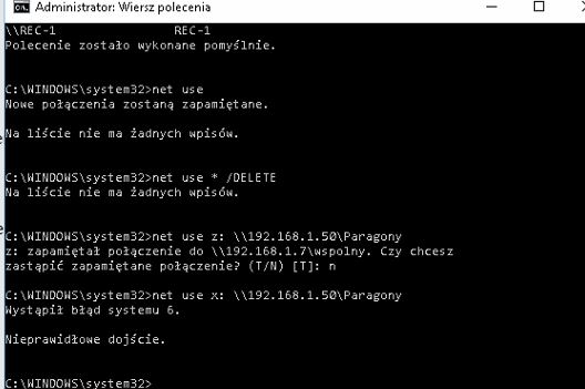

    - after mapping in DOS, a bit different error, error No. 6
    PS
    I already have this problem on 2 computers with windows 10 in 2 different networks and the computers are also completely different, the folder and HP, they only connect with Windows 10! I fought on pc1 for half a year and I could not do it, this problem arose with the other client and I am also lying despite many hours of struggle. Is there any spec that knows the problem ?!

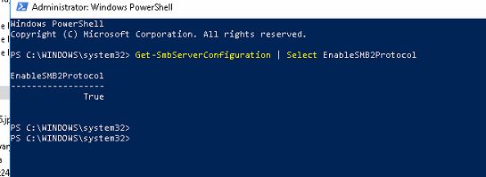

    PS. You wrote about deselecting / selecting SMB1 in system components, did you check if SMB2 is enabled in "broken" Windows? The easiest way is via PowerShell> Get-SmbServerConfiguration | Select EnableSMB2Protocol
  • #5 17756384
    Boosterpl
    Posts: 402
    Help: 19
    Rate: 33
    Yes, I checked the result below. So it's on. And the error is still as it was, so it is.

    But balls, actually after turning off the SMB 1.0 server on the server, so I set the support from 2.0 to 3.0 and now it flashes! Thank you very much! It's a pity that microosft could not write this in the message only 0x80004005 which means many different reasons. Microsoft's products are getting worse and worse ... It's important that I succeeded, I fought it for a few months!
    And do you know how you can make this win10 workstation still support SMB 1.0?
