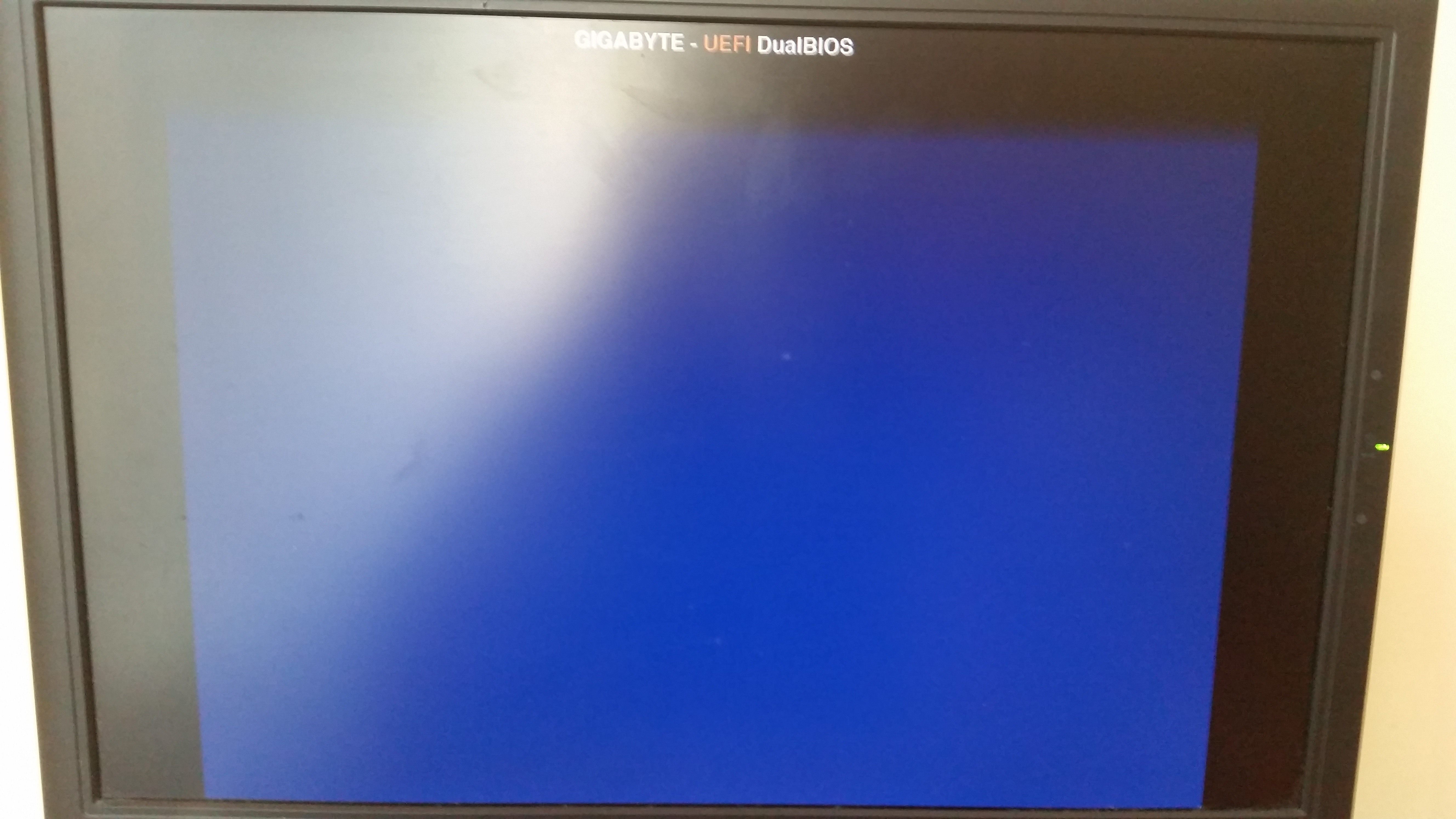

    Hello, he has a problem with the computer. The computer turns on beeps and a window appears (photo number 1) then a second window (photo number 2) and restart and so on and on. I took out the RAM, it was replaced, it didn't do anything. Another graphics card was connected, still nothing. The motherboard has been replaced with a new one, nothing with that on the new motherboard there is no beeping and no image (fans are running, the disk is working but the monitor is not active). The power supply being replaced is the same. The voltages are checked and everything is ok. The only thing I can not check is the processor because I do not have one in stock. Any hints?

    On the first screen, press DEL to enter the BIOS.
    In 'BIOS features' turn off 'Full Screen Logo Show'.
    Save and restart the system.
    After restarting, messages should appear instead of the logo from the first picture, post them here.

    Unfortunately, the PC does not respond to any command on the first screen, it only shows the second screen and another restart. The strange thing is that on the new motherboard there is no image and no startup beep through the speaker. I also read on the manufacturer's website:
