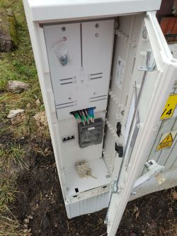

    -Tauron put a box for me at the border of the plot.
    -20 m further I have a tin garage (storage space for the construction period)
    -I would like to have electricity connected during construction. It will not be a construction current but a target one. After the house is built, the switchgear will be made at home on the same terms, but the final one. Currently, the plot is undeveloped, there is nothing on it except a metal garage.
    - I would like to securely and financially reasonably attach this erbet to the Tauron box. I plan to install the following:

    I am enclosing photos of the Tauron box and papers from Tauron

    By the way, Tauron should be impaled by their connectors. The hole for the RNT is good for 5x2.5mm, not the house power cables.

    The grounding in the test box is owned by ZE and you have nothing to do with it.
    You insert the earth electrode at the RB-tce and ground the PE track, not necessarily at the PEN division.
