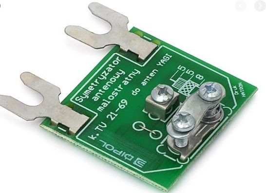

    I only find 16 terrestrial TV channels, no TVP, I have a new antenna, cable, PCB. Antenna quite high in a place where it was always ok and directed towards the transmitter with which it was always ok. I receive these 16 channels in good quality. My question is what is going on here? why some channels are of good quality and others are not at all? What to do?

    And what kind of "plate" do you have in the antenna box?
    Because this board may need a power supply with a separator.

    Rather no maintenance
    Plate
    • DVB-T Troubleshooting: Missing Channels, No TVP, New Antenna Setup - How to Improve Reception? IMG_20200812_175833_6.jpg (4.66 MB) You must be logged in to download this attachment.

    Check if the "wires" in the antenna box are screwed to the plate, not under the plate, "metal to metal". Screwing under the plate is a bad connection.

    I understand that you have set up an amplifier and you do not have a power supply and you are surprised that it does not work.

    anszej wrote:
    ... what the amplifier looks like, I don't even know
    Yes
    You showed it yourself.
    If the above amplifier is in a box, it requires a 12 V power supply with separation from the TV antenna socket. If there is no power supply, it is surprising that you are receiving anything. So you have a very strong signal and in the box, instead of the above amplifier, there should be a balun, which is something like this:
    Then without power and separation.

    If it's the amplifier from the photo, you can see water marks and it may not work. And as the name says it is an amplifier, which means that it requires a power supply.

    The amplifier and power supply should also be replaced. Buy power supply with regulation.
    However, I would start with the power supply.

    Replacing the plate with a balun helped.

    The balun solved the problem again, thank you all
