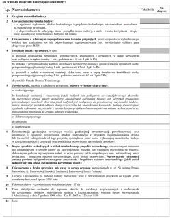

    An application for an occupancy permit is attached, including:
    Electrical installation acceptance protocol + Protection measurements - practica
The discussion revolves around the procedures and standards for conducting protective measurements and acceptance protocols for electrical installations, specifically in a single-family house setup. The user, an electrical engineer with SEP "E" and "D" qualifications, seeks guidance on performing earth resistance measurements, continuity of protective conductors, and short circuit testing. Participants emphasize the importance of adhering to the PN-HD 60364-6 standard for low voltage electrical installations, particularly regarding acceptance checks and the documentation required for the construction book. The conversation highlights the necessity of practical knowledge in addition to theoretical understanding, as well as the legal implications of signing off on installation safety. The installation is noted to be in the TN-CS system, with specific grounding methods discussed.
