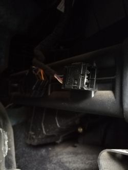

    Hello everyone
    I own a 2004 Fiat Panda in the poor version.
    I am missing the cigarette lighter socket, because I do not have a phone charger to connect to.

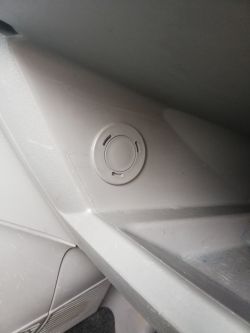

    I would like to install the cigarette lighter in the glove box where the passenger airbag deactivation cap.

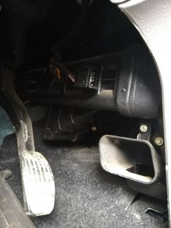

    I took some pictures of the cubes with cables and I have a question if I can connect to any of them.
    If none of them would be suitable for connection then I can use the harness from the radio?
    Is it enough if I buy some universal cigarette lighter socket from a popular site for 15 zł and it will fit?

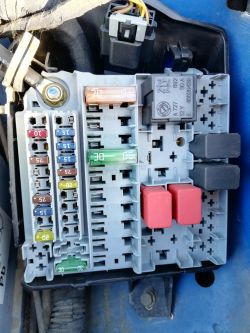

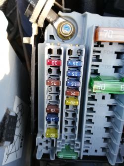

    Pins next to maxi fuses you have free . A holder with a 10A fuse and you're done. With a tester speawdz

    The radio I have definitely connected by a cube. There are cables to the cube among others red and brown I have to pluck them from the insulation twist a wire to each of them and these 2 newly created connect to this charger what you sent in the picture?

    Cool way with these clips. Yes there will be only USB there that is my way of thinking with using the cable before the radio cube, red and brown is correct, there will be no sparking etc. The radio at my place I can turn on without the key in the ignition. However, when I have it already turned on and the car is fired up, the radio turns itself off when the car is turned off.

    You need to check the cables with a tester. No one at a distance will tell you what colors to hook up to, because in such a car miracles with the installation could happen.

    It is to be a minus, that is, it is to be shorted to the ground of the vehicle.
    Minus you can also take from any metal body component.

    Minus can also be taken from any metal body component. However, when I have the radio on and the car is started, the radio turns off by itself after turning off the car, but if I press ON while the car is turned off, it turns on. If I connect a car charger socket like the one in the pictures above to this radio power cable, will it light up all the time even when the car is turned off, because I don't know if this would have a big effect on discharging the battery.

    There are probably two power wires in the radio: one + constant from the battery to maintain the radio settings and as the main power supply, and the other after the ignition to turn on the radio.
    With a phone charger it will be rather difficult to "milk" a working battery, unless you leave some device in the USB for a few days.
