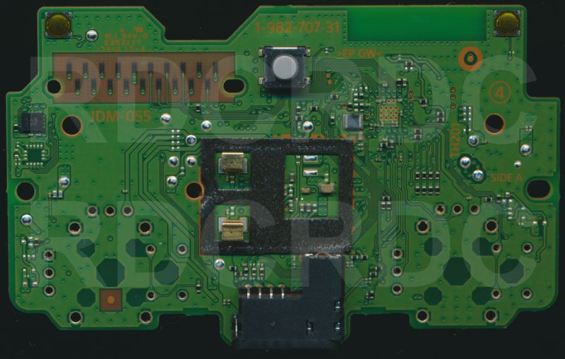

    I got a PS4 pad, JDM-055 motherboard, no reaction to charging. Connecting a charged battery does not help either.
    Unfortunately, I cannot read the symbols of the system responsible for the power supply.
    Please help me with any suggestions and advice on how to repair this miracle.
    Suspicious chip smaller chip in the center of the board.
    Photos of the album were googled.
    ps4 pad dualshock 4 jdm-055 - pad damaged, no reaction to charging ps4 pad dualshock 4 jdm-055 - pad damaged, no reaction to charging

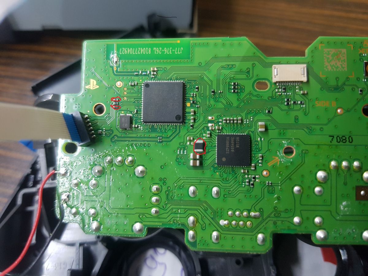

    I join the question, I have the same symptom. The pad is mine, so I`m sure it was charged correctly (under the console) and not under the micro USB charger. I repaired other pads, e.g. after connecting to a fast charger, but this one died "by itself".

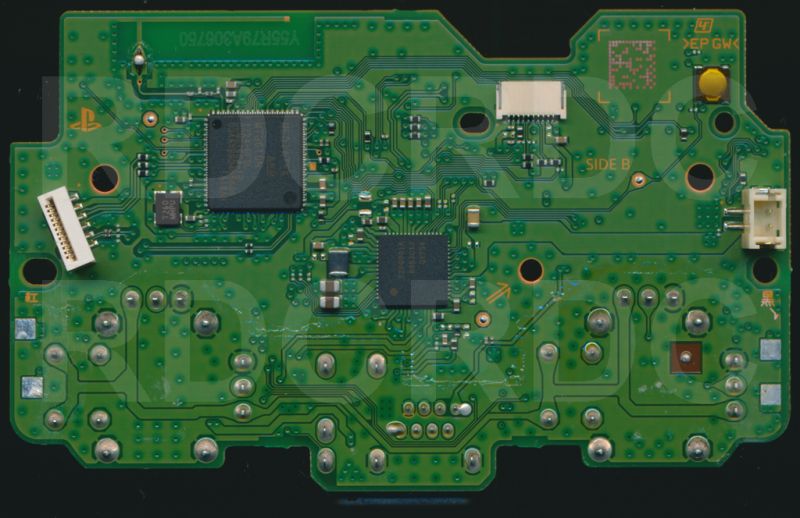

    From this photo at least you can see the symbol S2PG001A
    Unfortunately, apart from two pages in Russian where someone is also looking for help in the subject, there is no more information about this system.
    Equipment for several years, no one has repaired such pads? disposable in the trash?

    check the smd capacitors if any are not shorted

    S2PG001A is a custom PMIC made for SONY with integrated audio. With symptoms as above, replacement usually solves the problem. The layout is not cheap in detail.
    There is an SMD fuse on the board with the USB port, it happens that it is blown, although in most cases (as the pad does not respond to a charged battery) the above-mentioned system is damaged.
    It also happens that the ARM is damaged.
    You need to consider whether it is worth repairing or buying a new / used PAD.
    Pads on the JDM-050 and JDM-055, i.e. V2, can be boldly written that they are disposable.
    Usually the PAD kills charging from an external charger.

    I will renew the topic, I have rain, the orange LED flashes 3 times. Should the black elements marked on the board be short-circuited? are these diodes? 3 items are shorted one only shows the value. ps4 pad dualshock 4 jdm-055 - pad damaged, no reaction to charging

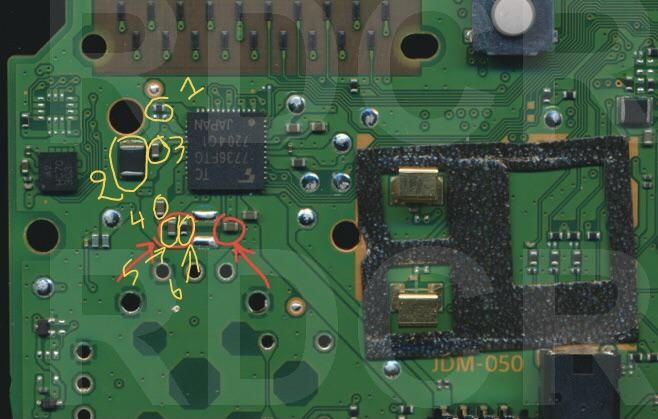

    Hello, is it possible to solder the charging system between the JDM-050 and JDM-055 boards?

    I will renew the topic, I have rain, the orange LED flashes 3 times. Should the black elements marked on the board be short-circuited? Are these diodes? 3 items are shorted one only shows the value. ps4 pad dualshock 4 jdm-055 - pad damaged, no reaction to charging
    Hello. That's how they should be shorted and I think they are resistors.

    marek666
    The charging circuits in the above boards are not interchangeable:
    JDM-050- TC7736FTG
    JDM-055- S2PG001A
    Both charging circuits are quite expensive, so rather unprofitable to repair.

    >>21233887
    hello, can you help me to identify the resistor value and capacitor next to the TC7736FTG? I found no diagram or schematic
