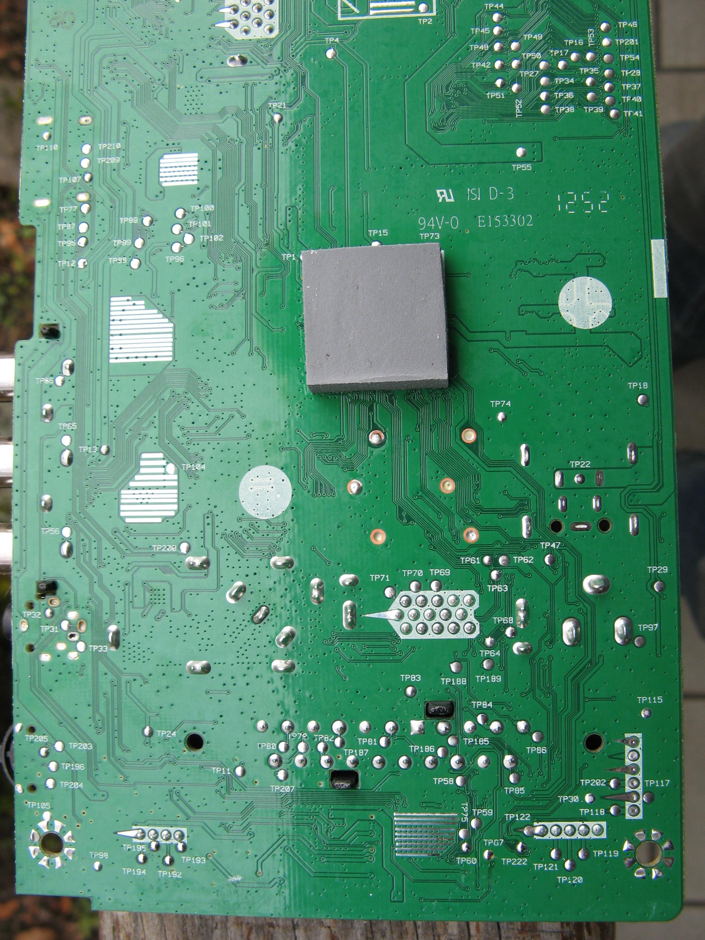

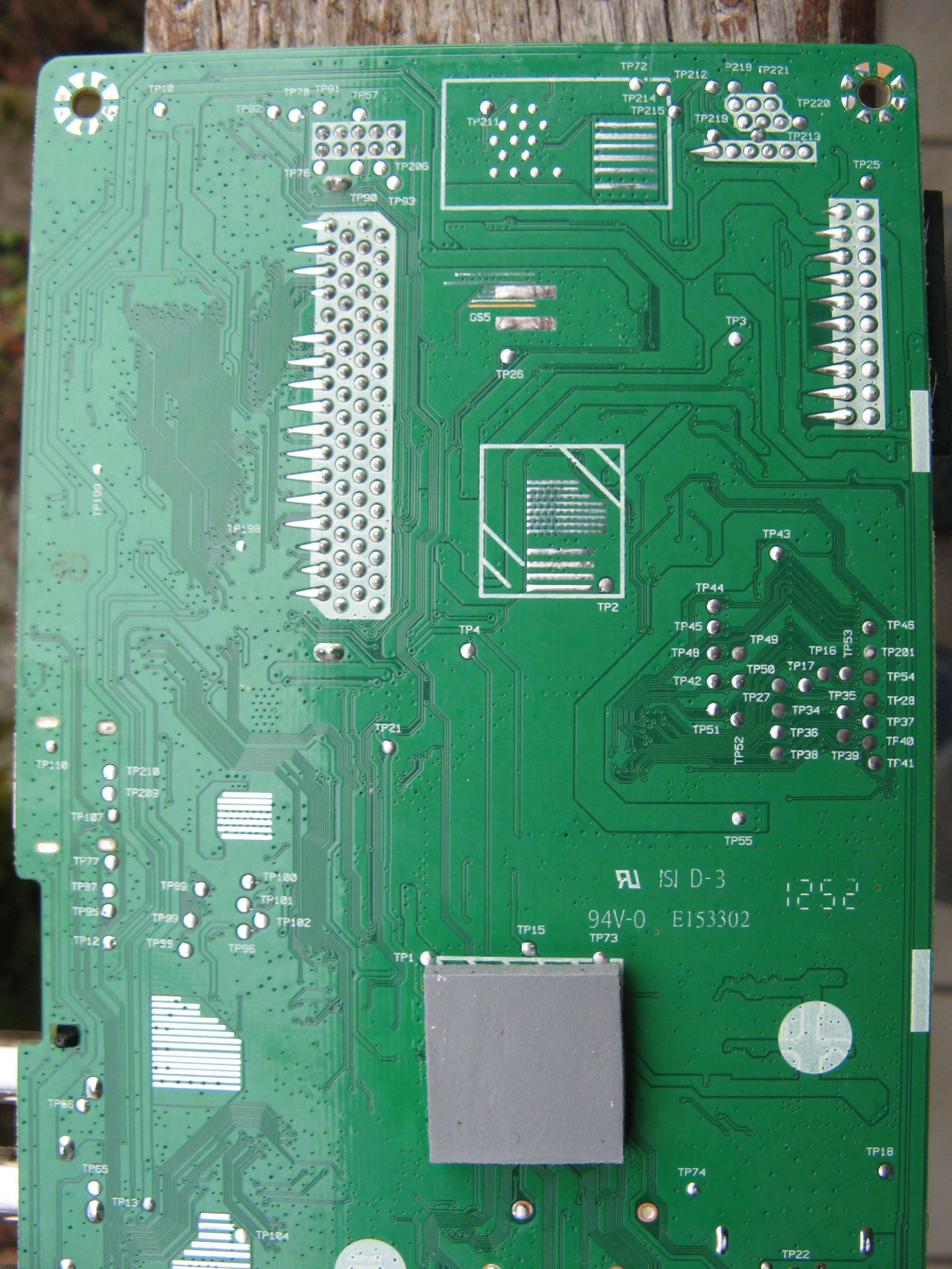

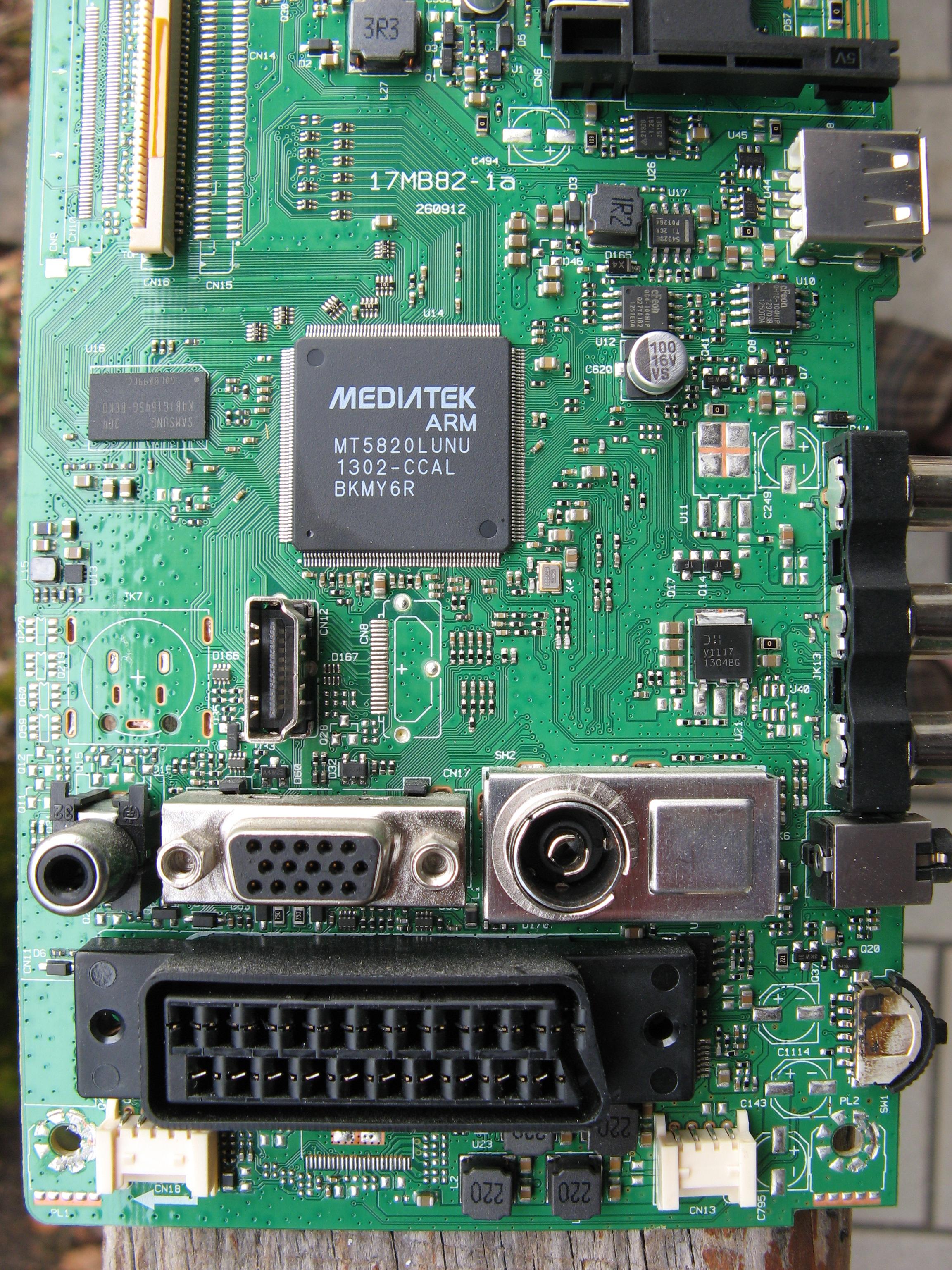

    HI!
    Here are the photo i made.
    Thanks in advance.
    • Techwood TV LED22AK13DVX/2 Fails to Start: Seeking .bin files for EN25Q64, EN25QH16 Flash Memories 17MB82-1A-4.JPG (910.82 KB) You must be logged in to download this attachment.
    • Techwood TV LED22AK13DVX/2 Fails to Start: Seeking .bin files for EN25Q64, EN25QH16 Flash Memories 17MB82-1A-2.JPG (1.22 MB) You must be logged in to download this attachment.
    • Techwood TV LED22AK13DVX/2 Fails to Start: Seeking .bin files for EN25Q64, EN25QH16 Flash Memories 17MB82-1A-1.JPG (1.21 MB) You must be logged in to download this attachment.
    • Techwood TV LED22AK13DVX/2 Fails to Start: Seeking .bin files for EN25Q64, EN25QH16 Flash Memories 17MB82-1A-3.JPG (764.51 KB) You must be logged in to download this attachment.

    Dont rewrite 25q16. First rewrite 25q64. I think q16 is including panel data.

    Programmer received. I flashed the 25Q64, but nothing more. Then i flashed th 25Q16 and now, i can start the TV and stop it. The backlight starts also, but nothing on the screen. I update the software with the one sent by Vestel. Nothing more. Perhaps software not for the LCD panel ? Or an other issue to find…
    Someone had this issue ?
    Best regards.

    U10/U12 bin files for main 17MB82-1A and panel M215HGE-L21 C2

    Hello Billobirillo,
    Thanks a lot.
    It works fine.
    I think it was not the good software that i had for the LCD Panel.
    Best regards :D
