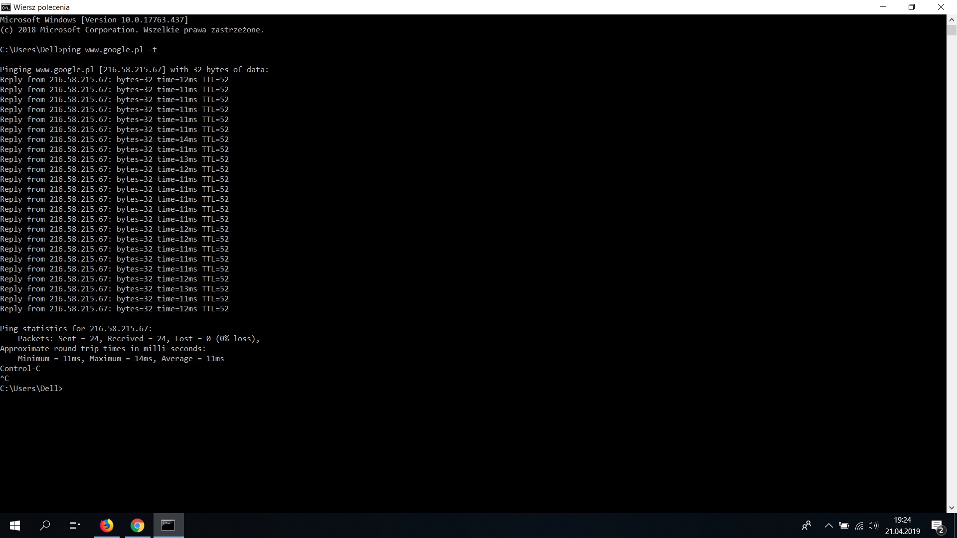

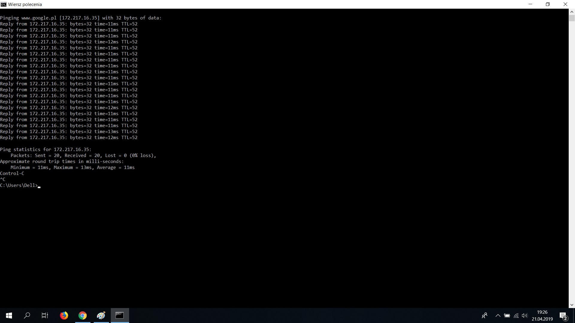

    You cannot see it in the infection logs. Restore chrome to default settings and check cmd pings on www.google.pl -t before and after reset.

    START menu, in the "search" field you enter "cmd" and click the found "run as administrator"
    Type ping www.google.pl in the window
    #26 17918611
    krzychupar
    Posts: 6807
    Help: 1490
    Rate: 633
    In the Start menu, you enter cmd in the search field, run cmd and enter the ping command www.google.pl -t and check the access times. After a run of about 20 responses, stop the ping by pressing LCtrl + c and will post a screen shot of cmd.
  • #27 17918637
    sarcatiel
    Posts: 35
    Rate: 11
    Done, ping1 before chrome reset, ping2 after chrome reset. There is no difference whatsoever

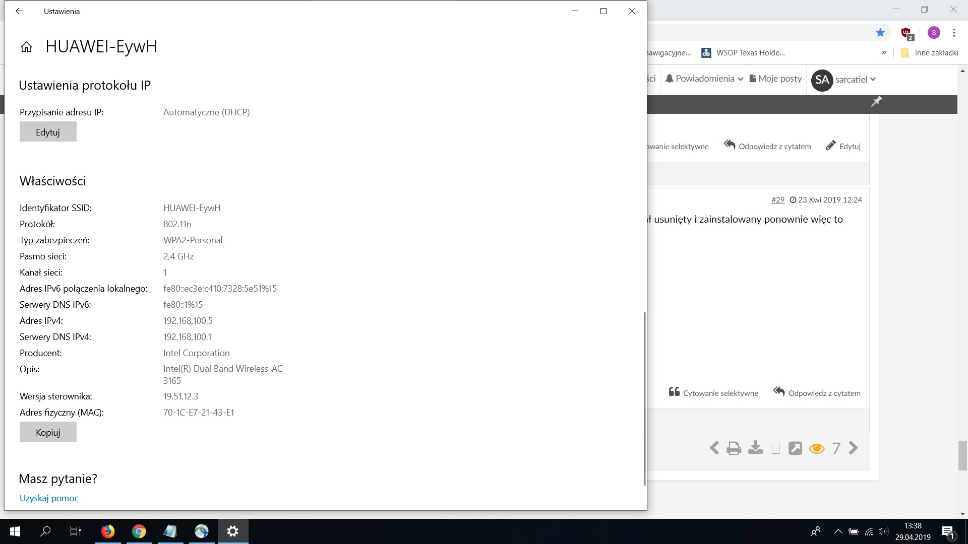

    I am pasting the screen with internet settings
    Google Chrome Not Loading Pages Immediately After Launch: Windows 10 Troubleshooting Tips
