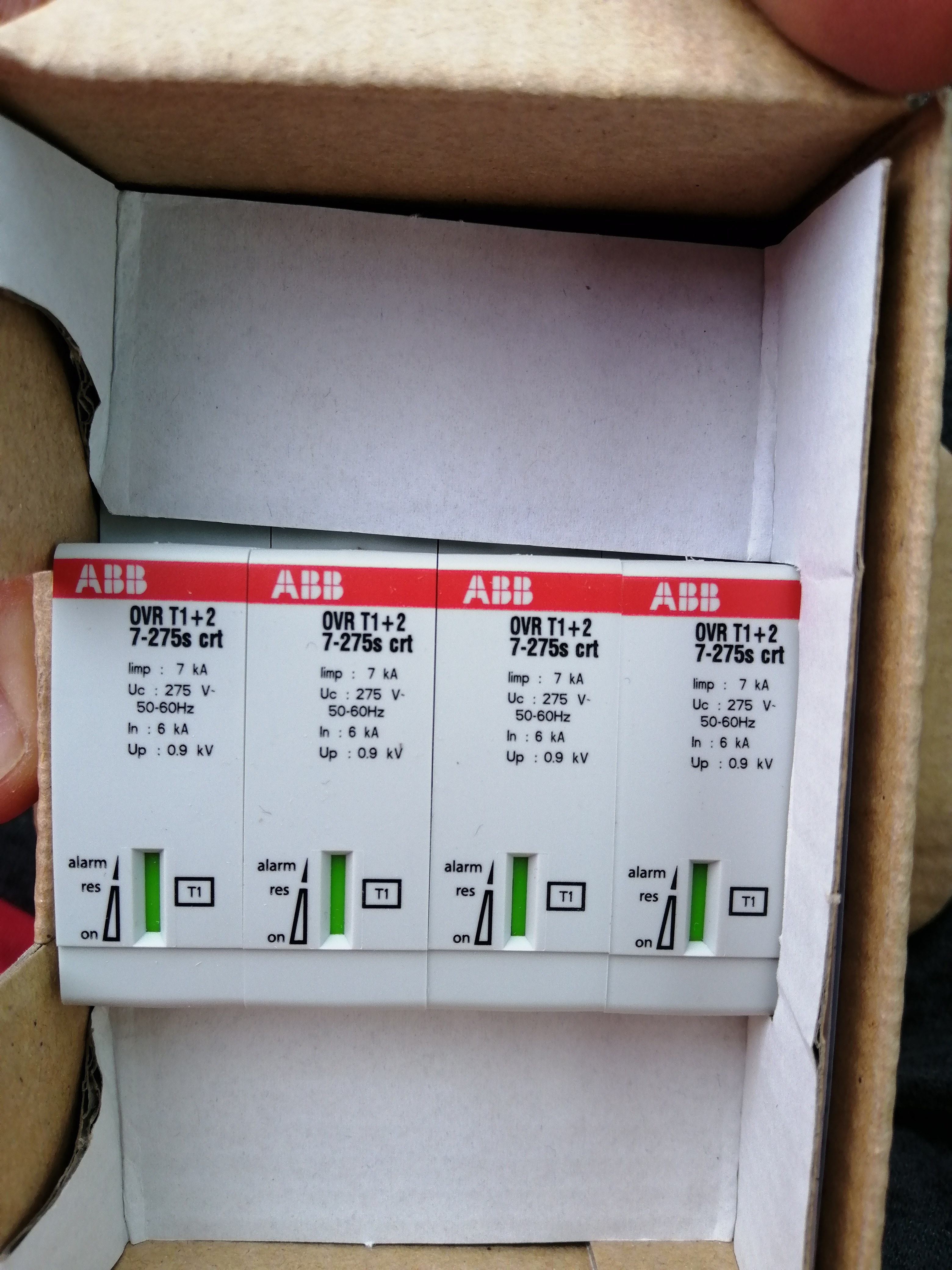

    I have a question about the PEN division and the use of a 4-pole surge arrester in the TNC-S network.
    Is what the picture shows okay? I mean the PEN division at the input to the switchgear, then the PE to the PE bus which will be earthed to the hoop also located in the switchgear and connected to the earthing of the surge arrester.
    The overvoltage limiter is 4-way, although I do not know if it makes sense to protect N which is galvanically connected with PEN and PE, I just have it?
    TNC network with S division in my switchboard. Cable connection 4x 10mm2.

    What is this protector :?: how did you pick it up :?:
    It's yellow-green in the lower right corner of where it will be mounted :?:
    What is this object and what does its power supply look like apart from this 4x10 cable :?:

    The PE rail is also originally installed in the switchgear at the bottom (I have Legrand).
    It will be a single-family house. It is the main separation, then there will be 5 pcs.
    Counter protection C25.
    The ABB B + C protector was recommended to me in an electrical store and there was nothing else on the project except that there should be a B and C protector.

    You have not written how the house is powered, overhead or cable, and how long the 4x10 section is.
    The house has a lightning protection system :?:
    Because it had been lying on the shelf for too long :D they should recommend a TN-C protector but they probably didn't have one ;)

    That's right, they didn't have 3 poles, but what's the difference? I can't connect anything to N?
    Not exactly like the picture below.
    My power supply is earth, some 25m connection, then it is connected to the overhead line.
    There will be no lightning protection - at least for now and you will brighten me up, what will it change? The earthing hoop is connected to the earth ring around the house with the 4x32 hoop.

    In my opinion, you should have an arrestor based on a magneto.
    In my opinion, this limiter is not suitable for home limp 7kA, laughs are the worst, they have about 20kA, although these are stretched values because at 8/20 where the 7kA is 10/350 and it seems it is a T1 (B) type protector and not B + C.
    With the amount you invested in ABB, you would probably buy the right one.

    No, you have T1 + T2 written on it, I invested less than PLN 500 in it, I do not know what would be the right one, the electrician wanted to give me some Chinese for PLN 250, I thought I would buy a better one, I did not analyze it like you because I honestly don't know much about protectors. One more thing in the project is that the ZE provides type I protection.
    Regardless of it, is the connection method correct? Should this N finally be connected to the protector or just leave it empty? If it was not, the protector is already for the division, I know there should also be N connected.

    Each protector is supplied with the manufacturer's instructions. So you should first check if what you bought is intended for the type of network you have, and if so, the required connection method is shown in the drawings.
    If there is a break in the PEN in the overhead network, the receivers will also be damaged.
    The protectors will not work for this.
