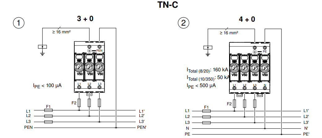

    A question of a slightly different nature. I also found a solution from OBO V50-3 + NPE-280. And I am wondering about the connection of this limiter in the TNC-S network. In this case, following the internal scheme:
    Choosing the Right Surge Arrester: 3P Limiter, Type B+C, Spark Gap, DEHNshield DSH TNC 255 & More
    the varistors protecting subsequent phases are connected in series with one spark gap, and in a 4-wire network the N contact would not be used? I found diagrams in the OBO materials:
    The example for a TNC network does not consider the use of a spark gap insert. Hence my theoretical question.
    Added after 9 [minutes]:
    A similar solution is proposed by Eaton, and the studies do not provide for the use of a summing spark gap in the TNC network, only a solution based on varistors only.
