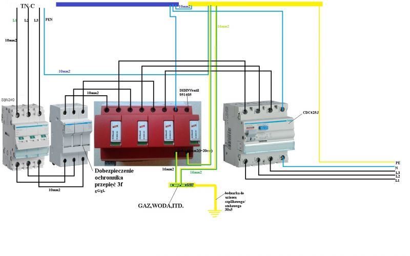

    I would like to kindly request your opinion on the switchgear diagram in a single-family house.
    Necessary data
    - Protection in ZK3a - 32A
    - The pre-meter protection is 16A - 3f
    - The network system is TN-C (4x70mm? Al cable connection - 115m to ZK3a)
    - Power supply to the above-mentioned connection from a straight-through pole.
    - A set of valve lightning arresters GZa0.66 / 1.5kVA with grounding type TA3x7 (steel tape 30x5 - 30m) is mounted on the pole
    - Distance of the connection point from the transformer 100m
    - 250kVA transformer power
    - Short circuit voltage 4.5%
    - Steel wire 6mm? laid parallel to the cable (after 30 years maybe 3-4mm? remained: /)

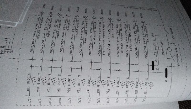

    I am planning to modernize the internal installation.
    I have a project but it is very general and does not provide detailed information about the surge arrester, PEN distribution point, etc.
    My questions ?
    1. According to the diagram in the appendix, can I split the PEN after the meter (as shown in the picture) or should I do it before the meter?
    2. Can I use an AC circuit breaker or do I have to buy an A?
    3. Should a surge arrester back-up be used?
    4. What about the equalizing connection of the gas pipe when there is no insulation insert?
    5. Are there errors in the schematic? If so, what should I improve?
    I will be grateful for any suggestions.

    Arrester for the TN-C system
    Protection between the switch and the arrester is pointless.

    Yes, but what value ... the security of your protectors is in ZK, there is no point in duplicating it.
    Type A RCDs are a better choice than AC but one 4P for the whole house is a bad idea.
    Check what the manufacturer recommends regarding the conductor cross-section for SPD or 10 and 16mm? is enough.
    If possible, make a breakdown in the switchboard.
    As far as I remember, AC is already banned in some western countries. In my switchgear, all RCDs are of type A, but that was my whim, because for now you can use RCD type AC as you want.
    Since you are going to use DEHNventil, it can extinguish the line sequence arc up to 50,000 A. Additional protection of such an SPD is completely unnecessary. The DEHNventil documentation specifies when to apply a back-up.
    Badly matched SPD. In the drawing, you connect the PEN conductor to the PE strip. While the distance between the PE and N rails is small ? 50 cm, use the SPD for the TN-C system (https://www.dehn.de/store/d?locale=en&product=951300&type=specification). You connect to the PE rail from the PEN clamp on the SPD. The overvoltage will be limited on the PE and N busbar. Here, the SPD with the N-PE module is unnecessary - something else if you had a PEN division before the switchgear with 5-wire WLZ. I do not know how big you are going to have the switchgear, but the distance between the SPD and the PE busbar is also relatively short ? 50 cm. This distance is more important than between the SPD and the GSU.
    For the SPD, I would use a distribution block, not a direct connection to the RCD.

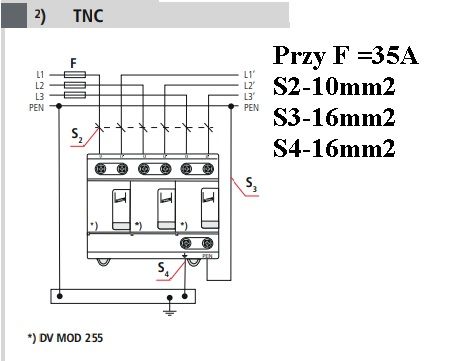

    So, can the PEN of the lz be 10mm??
    If :
    - BMy in ZK3a - 35A
    - 16A pre-meter protection
    - wire from ZK to ZL 4x10mm? CU
    - wlz 5x10mm? CU (free PE wire)
    In the figure below, the S2 wire (L1, L2, L3) can be 10mm?, but the S3 and S4 wires must be 16mm?.

    How is it possible that you have decided to use such a small (contracted) connection capacity? This is my first time meeting with the 16 A pre-meter protection. After all, it will be unusable.
    But the S3 and S4 wires must be 16mm?
    Yes. Cables from the terminal with the grounding symbol and PEN are exposed to high surge currents that can come directly from the lightning protection system to the SPD via the GSU. In addition, all phases are connected via a spark gap and a varistor to the double ground / PEN terminal. During the operation of the SPD, all phases are connected to the double PEN terminal for this time in order to equalize the potential difference.
    PS
    Then finally decide what WLZ should be. There is no such thing as a free PE vein or hanging in the air. If you are going to split the PEN in front of the switchgear, you cannot use SPD for TN-C. Must be for TN-S with N-PE module.
