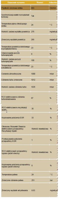

    Has anyone on the forum solved the problem: air flow greater than set in 1.6 HDI / PSA?
    For several months I have been struggling with EGR errors:
    Citroen C4 GP 1.6 HDI 109KM - Errors: P0401, P0490 and P1459
    The problem manifests itself in choking / jerking of the car during acceleration (dynamic). The car stops when moving fast and around 2,000 rpm when it throws errors. The symptom of throttling is explained by the reaction of the EGR system to too much air flow - the controller receives information that there is too much air in the system and tries to reduce its volume by adding exhaust gases through the EGR valve. After jerking, the car does not enter emergency mode and accelerates smoothly to a speed of 170-180 km / h (tested on selected sections of the German highway).
    I did the following to fix the problem:
    1. EGR replacement - the original was blocking and Check Engine / Depolution crashed, so it was replaced with a used Valeo. The problem of EGR blockage kept coming back so I bought a new Valego. Unfortunately, it didn't help, so I replaced it with another one - this time an NTY replacement. There was hope and Check engine did not come back but the errors were still there. So I changed to another NTY as well and it's still the same as before. In total, I reworked the topic with four EGRs and there are still problems.
    2. MAF replacement - the original had a short circuit and showed extremely high air temperature, so it was replaced with a used original, the short to ground and temperature error was resolved. After replacing the Check Engine stopped lighting up.
    3. Intercooler cleaning - I rinsed the original one, checked for leaks and installed it. Unfortunately, no changes.
    4. Cleaning the air mixer (I have a single one) and the intake with Liqui Molly - procedure with the engine running. Unfortunately, no changes.
    5. Vacuum transducer - I replaced it preventively to ensure proper control of the turbo blades. By the way, I checked that the blades and the barbell work smoothly without jamming and the wires are tight. Unfortunately, no changes.
    I am asking for help and tips because I am slowly running out of patience.

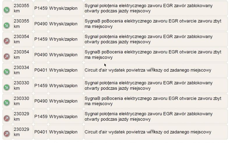

    Thanks everyone for joining the discussion. I'll try to add more measurements tomorrow.
    For now, I attach the error logs that are saved in the vehicle log.
    PS EGR is electric. Turbine with variable geometry regulated by vacuum bar - checked does not jam. The sidewalk was mechanically cleaned about 2 years ago and was in good condition. The DPF burns out every 250-300 km. From the time when the jerk burns an average of 6.2 l / 100 km, previously I had within 5.8. I'm changing the fuel filter today.

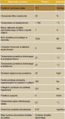

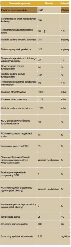

    Added after 20 [minutes]:
    Added screenshots from yesterday's rehearsal. The car has a new fuel filter.
    Information about the intake air circuit at idle after starting the car.
    Information about the intake air circuit after adding gas
    In addition, I recorded the parameters while driving and noticed a certain relationship: when the car jerks, the "measured air flow" parameter increases in a second, for example, from 300mg to 400mg or even to 600mg, and then changes to the set value within 2-3 seconds.
    Are such rapid changes in air flow not the result of a faulty flow?

    I posted a video of the test at a standstill on a hot engine after driving, engine temperature 85C.
    1. EGR closes during gassing.
    Then for a moment the copying is 0% but the RCO of the valve then displays "invalid value" - is this normal?
    In addition, the 0% value is displayed with a delay - is this normal?
    2. EGR does not close at idle even after a minute.
    The valve opening is within 24% and is identical to the set point.
    After disconnecting the flow, the engine does not stop and the car is more dynamic.

    From the video, the turbo works ok - such delays are normal, if you enter the charts, I suspect that the turbo set and actual values will be equal.
    I wouldn't move the barbell.
    Re 2
    Doesn't the turbo set point change as well?
    Re 3
    In the morning on a cold one it should open right away and then you should be fine :)
    Pay attention to the map sensor yet because it also affects the egr.
    You also need to pay attention to why the computer keeps asking for 100 turbo items all the time.
    I looked at old videos so quickly and my computer demands 100% turbo position when the egr valve is open.

    The mapping changes. 15% at idle and 75-95% at idle.
    I haven't found a similar case yet. On the English forum, the opposite situation was discussed, i.e. the set value was changing and the mapping was still at 100%.
    https://frenchcarforum.co.uk/forum/viewtopic.php?t=60480
    PS Today I'm going to tap MAP and test the car on the road.

    The jumping of the measured air flow parameter under load (peaks to 600 and then drops to 300 in 2 seconds) does not give me peace.
    I want to order a new one and I'm thinking about PIERBURG for PLN 370 vs OE SENSATA for PLN 360 vs SKV for PLN 222.

    In the diagbox you can choose the parameters for the charts, I'll try to play with it.
    Regarding training, I do not have such an option, there is probably only a replacement of parts.
    After disconnecting the pass, the car works as it should - so the conclusion should be clear - a problem with the pass or EGR. I replaced both elements ... either I'm unlucky or something else is going on.

    From today's driving, I can write to you that the maf basically constantly strives for the set value, but sometimes there are discrepancies.
