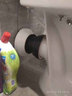

    Hello. I have a problem with flushing in a compact toilet, i.e. I need to flush several times to remove impurities. An apartment in a block of flats on the 2nd floor, recently renovated where the drain pipes were cleaned. Please give me hints where I can look for the problem.

    And does the fact that the outflow is horizontal does not affect the flushing, should it not be lower than that in the compact?

    By this reduction, you simply have a slightly higher water level in the siphon. This slows down the flow a bit. The design of the compact itself also has an impact; You never know when buying. You can't check it in the store, and after assembly it's already "after the photos"

    lisu24 wrote:
    the drain is routed horizontally
    If it is a short section, e.g. 0.5 m, it does not interfere with drainage from the shell.

    I do not understand this reduction (black) at the exit of the compact, I have several "seats" in the house, the distances from the vertical (max 0.4 m) are different, but the diameters of the pipes at the exit from the compacts without any reducers and "niagara", the first I see such a solution once, I think it will be possible to replace it with ordinary plastic sewage fittings.

    Well, combine, theoretically, further ... I have four "seats" (different types, not purchased at the same time) in the house, large cross-sections go immediately from the "exit" (ordinary plastic sewage fittings), in one immediately down at the bottom of the compact, in the second / third exit from the back (like yours) and immediately a 90-degree bend down, in the fourth (basement) a 90-degree bend immediately to the left and with a slight downward slope to the vertical half a meter further, no problems for years, even after a lavish dinner. Good luck with your work, regards.

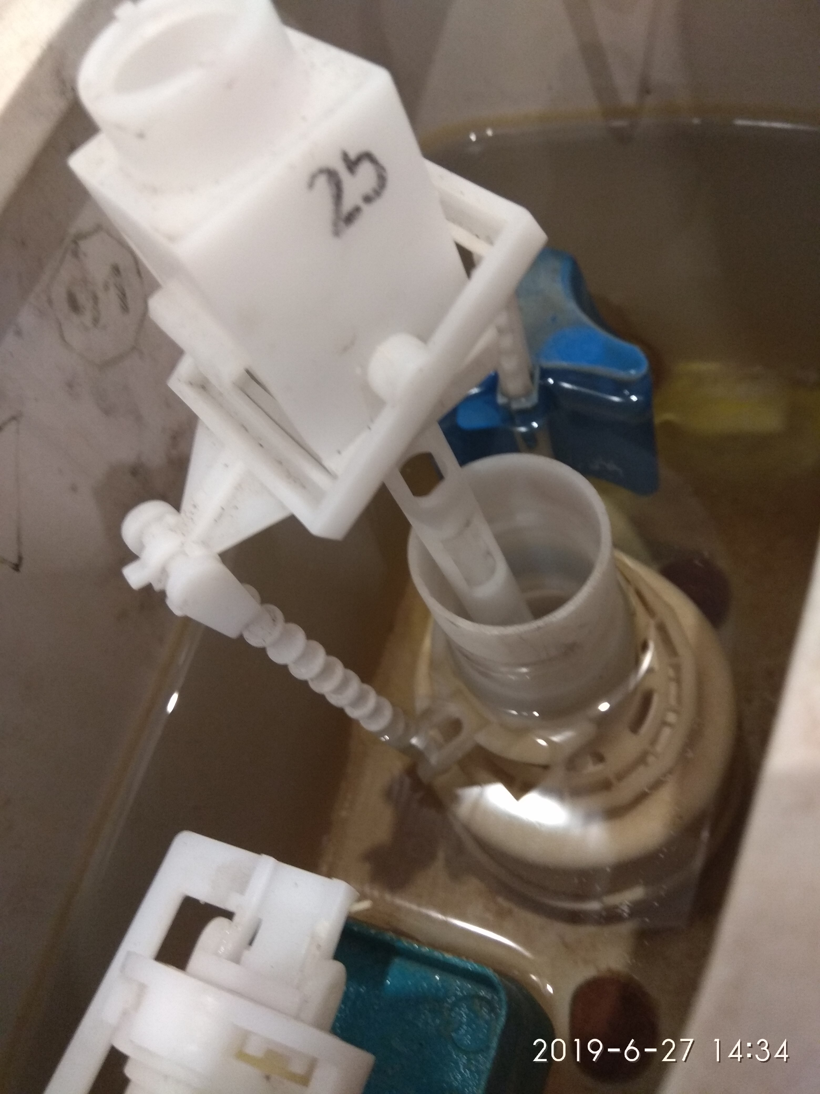

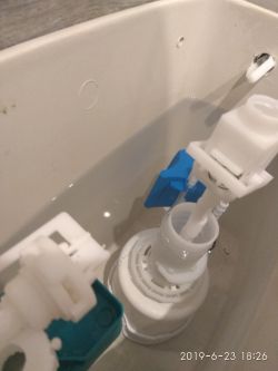

    I would look at the drain valve itself. Looks like some cheap plastic. Does it have any regulation?

    Multiple Flush Requirement in Compact Toilet: Drain Pipe Maintenance Queries
    This is what it looks like, I don't know what the blue float at the top is for.
  • #21 18032821
    Kenworth 18
    Posts: 11300
    Help: 2450
    Rate: 3764
    If I were you, I would replace the drain valve because it prevents the water level from rising and the cistern itself still has a lot of volume to fill it with water.
    A higher water level will allow you to remove what you want to remove without any problems.
    After replacing the drain valve, you still need to adjust the filling valve so that the cistern fills with more water.

    I replaced the drain pipe, it did nothing. A plumber friend took a look at it and said that the fault probably lies in the design of the compact and only its replacement can improve the situation. As for replacing the drain valve, it may not be visible in this picture, but the tank is filling up almost entirely.
